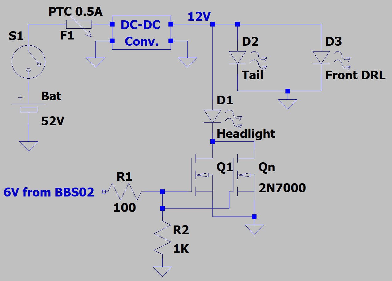

The light line can be enhanced with a relay or (my preference) a MOSFET.
The widely available 2n7000 switches on nicely with 6V on the gate, and you can parallel as many as needed for current handling.
On my bike I use a DC-DC converter to drop the bat V to 12V.
I can sketch up a schematic if anyone is interested.

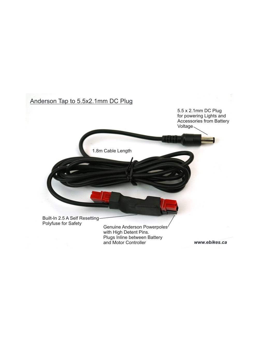

So I tapped the battery with a 4a fuse to feed the auxiliary. I made it so the horn flashes the headlight as well.

Yes, I would like to see this schematic!
Thanks! Well done!

I’m liking my roxim headlight. 12v-60v with a simple tap. I bought a bag of fuses and can adapt to any connector.
