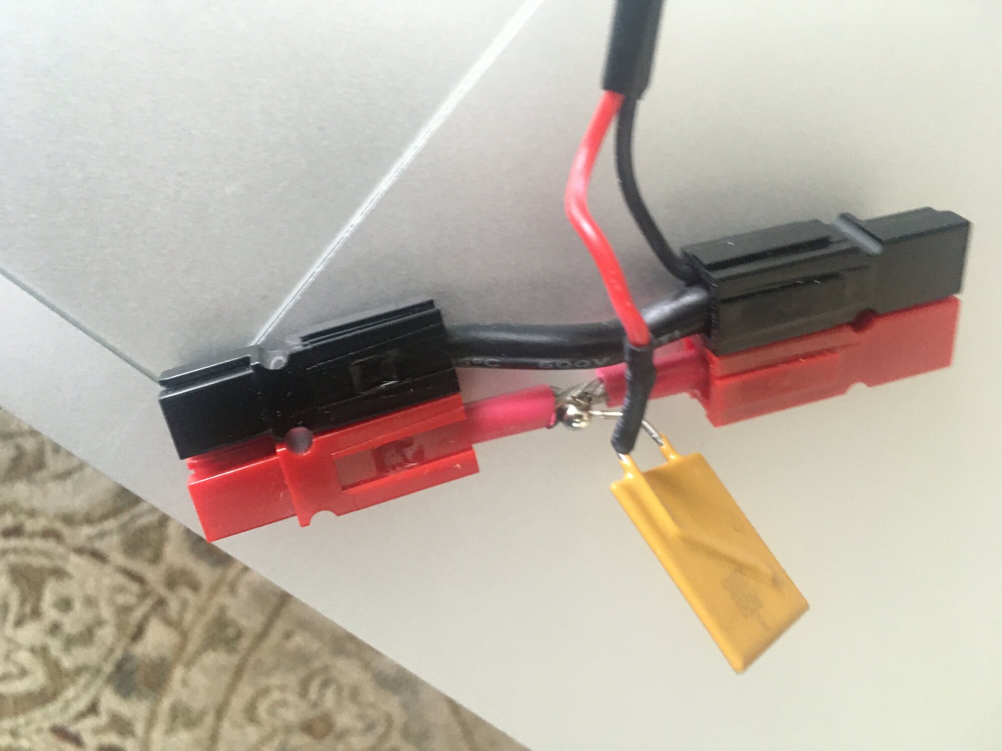

Tap off the battery output and a light rated for a range of voltages is the best solution for me. That light leads to some systems are very low voltage. input DC6V 12V 36V 48V 60V 72V LED electric bike light

What's the yellow thingy in the tap? Diode? Poly fuse?

Tap off the battery output and a light rated for a range of voltages is the best solution for me. That light leads to some systems are very low voltage. input DC6V 12V 36V 48V 60V 72V LED electric bike lightView attachment 53724
ahhh Polyfuse. Very interesting application ;-)
Not sure if this is the exact model as many look similar.
Any markings on it?
