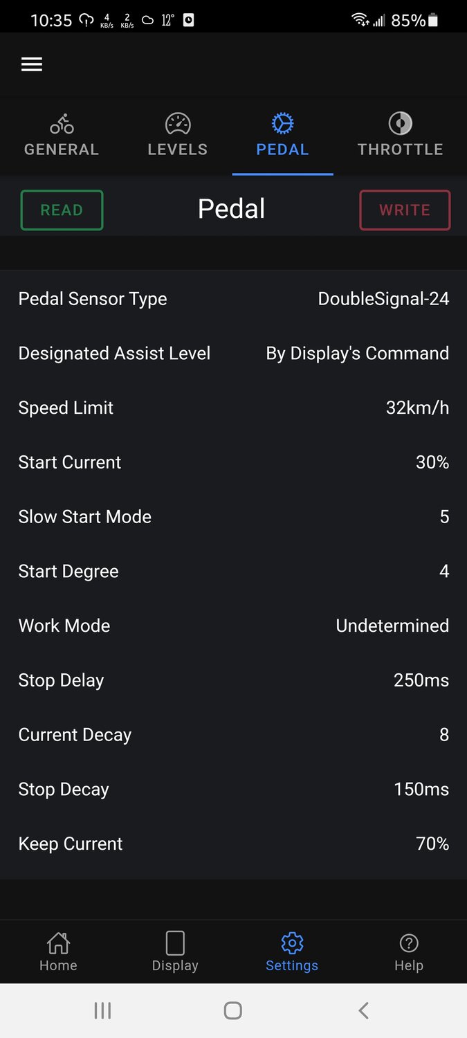

For shits_n_giggles I'm going to try a Stop Decay of 150ms and a Keep Current of 70 as I feel many of the settings feel different as you adjust others and certain combinations work well and not necessarily as you would expect. I dont think I've lowered my Keep Current since I started raising the Stop Decay and you may have stumbled on to something here.
Here's a screenshot just to make sure we're comparing apples to apples 😉
A stop decay of 1100 seems high! That's a full second to decelerate lol. I'll try it out though this weekend and report back, you might be on to something there too
I agree... But it seems like it's part of an equation and doesn't seem to affect it literally.
The screen shot looks good and we're talking 🍎=🍎
