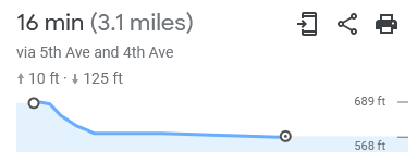

I have two e-bikes and am very pleased with the range on both (Aventon Pace 500 and RadMission). I have a pretty easy ride to and from work with small little hill on way home that uses a little battery. It's also along the river valley so generally one of the trips will be into a pretty decent wind which affects the battery some. I can usually make it most of the week on a single battery (31 miles) which is great or will charge once mid-week if I've run other errands on the e-bike or used extra throttle after a day of work. Both bikes are about a year old so glad to hear your older batteries are still doing well.
I have two e-bikes and am very pleased with the range on both (Aventon Pace 500 and RadMission). I have a pretty easy ride to and from work with small little hill on way home that uses a little battery. It's also along the river valley so generally one of the trips will be into a pretty decent wind which affects the battery some. I can usually make it most of the week on a single battery (31 miles) which is great or will charge once mid-week if I've run other errands on the e-bike or used extra throttle after a day of work. Both bikes are about a year old so glad to hear your older batteries are still doing well. View attachment 132483
You're living the dream! Nice commute, a choice of bikes and you're not saddled with range anxiety. I did commute for a long time 17 miles one way. I had to charge everyday. Would've been great to charge just a couple times a week.
