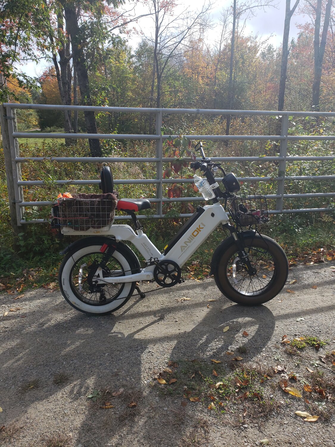

You guys replying to me in this thread sound like true "cyclists". Im not lol! What I wanted while shopping for an Ebike was more of an electric moped. I wanted something with a very solid base, almost preferably a bit heavy, so I could mount baskets front and rear- a rear basket big and strong enough to safely carry my 25lb dog-a seat with a backrest a water bottle holder, etc., etc., AND have battery enough to get me all over town, all day carrying a wide variety of items, up & down hills to include groceries and previously mentioned dog. I mention hills because we've got lots of them in the backwoods of Northern Maine. So anyway, this is the Ebike I went with...

PS: The brown wall tire on front was an experiment to see if I could tolerate brown walled tires. I cant. Not on that Ebike anyway. Ill be switching to white wall on the front ASAP.
