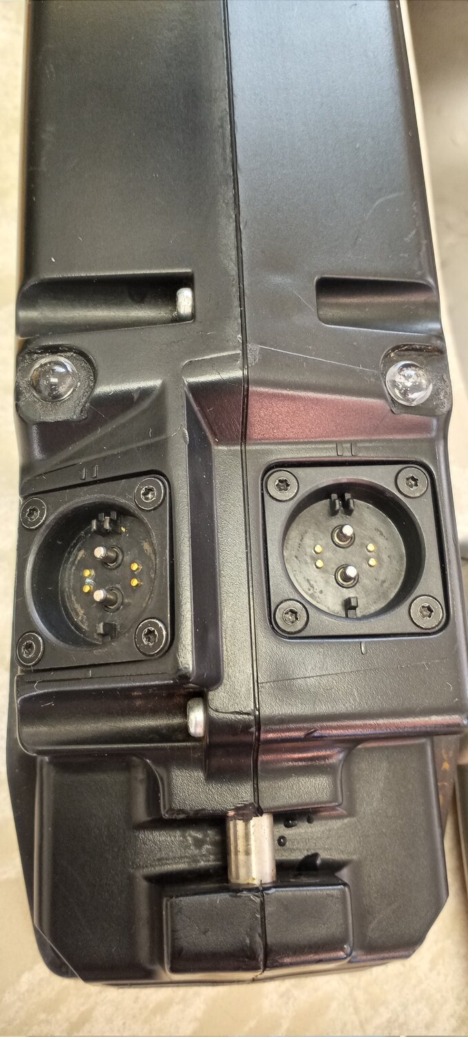

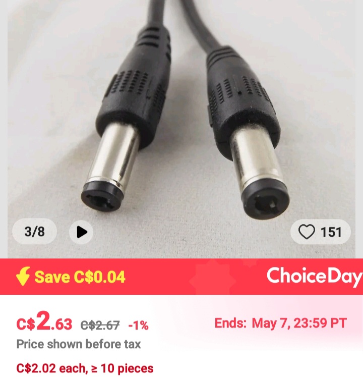

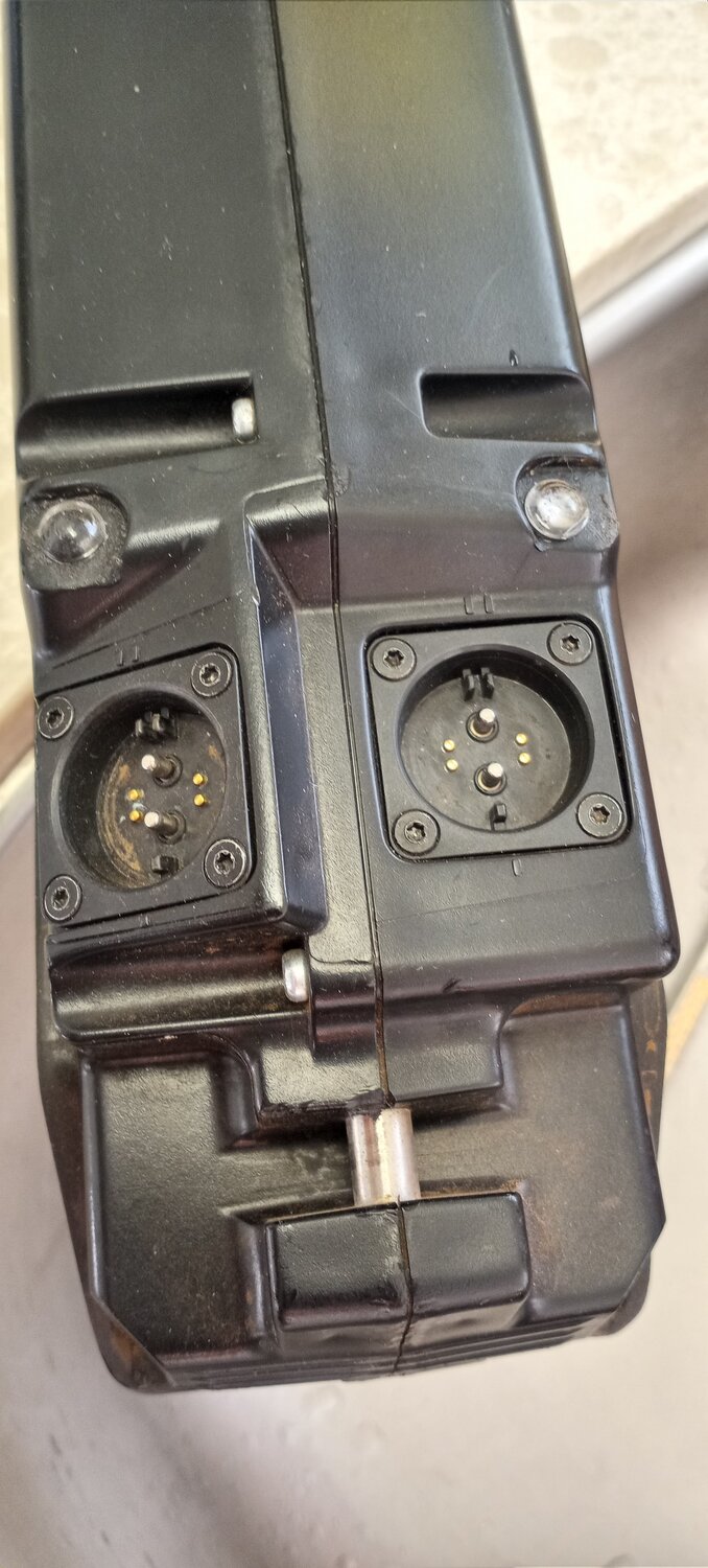

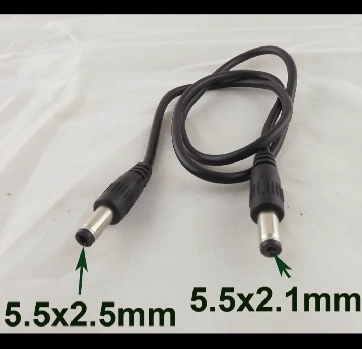

There is two different but possibly interchangeable standard 5mm barrel ports.
I just bought a double ended extension to make sure I get the right end.
I can't tell the difference, can you?? 😂
Try measuring the damn pin diameter with half a millimeter of clearance to get in there. 😂

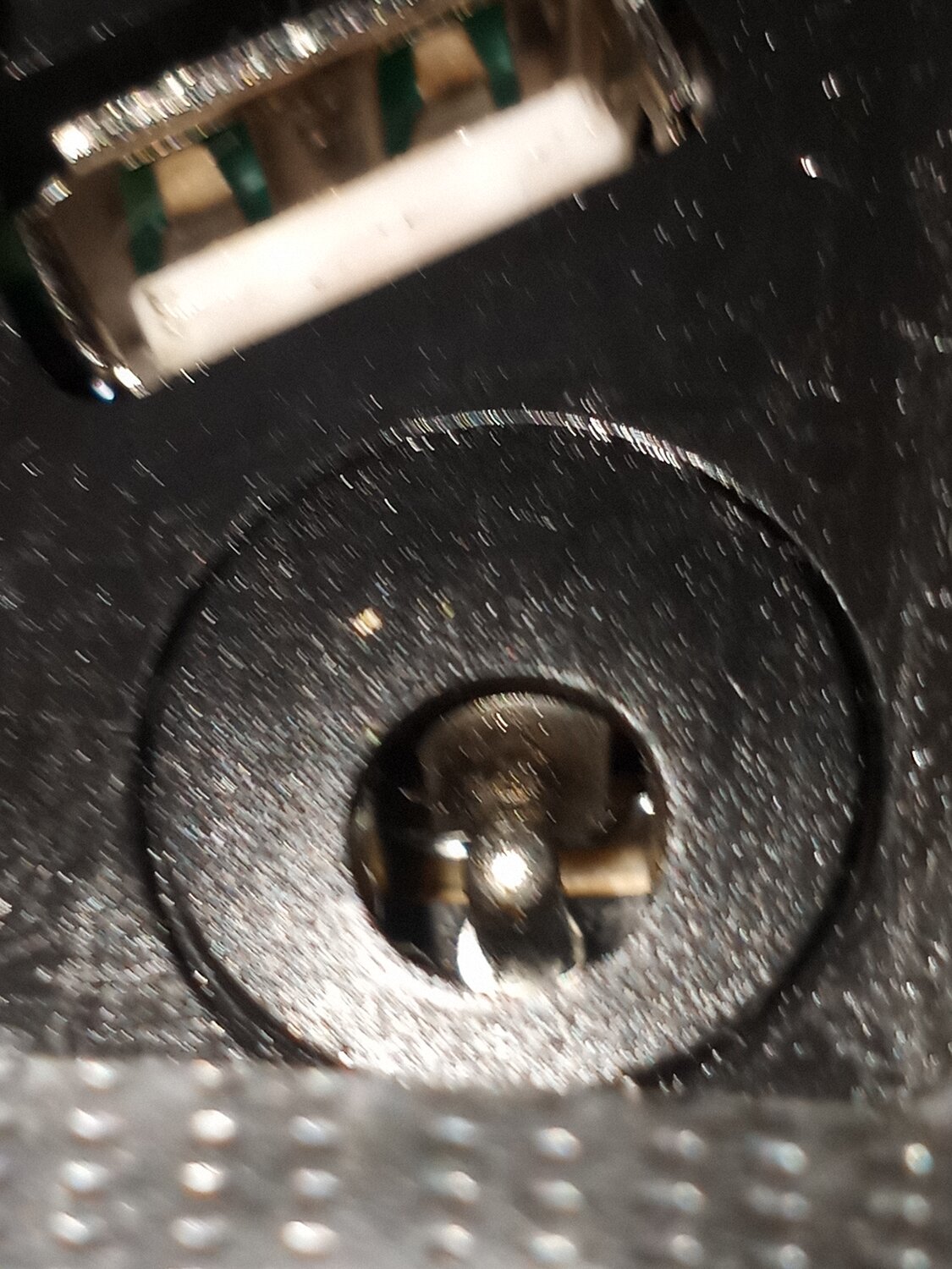

No one knows. Does the battery? A touch of dielectric grease seems to help. The one on the right looks bigger.

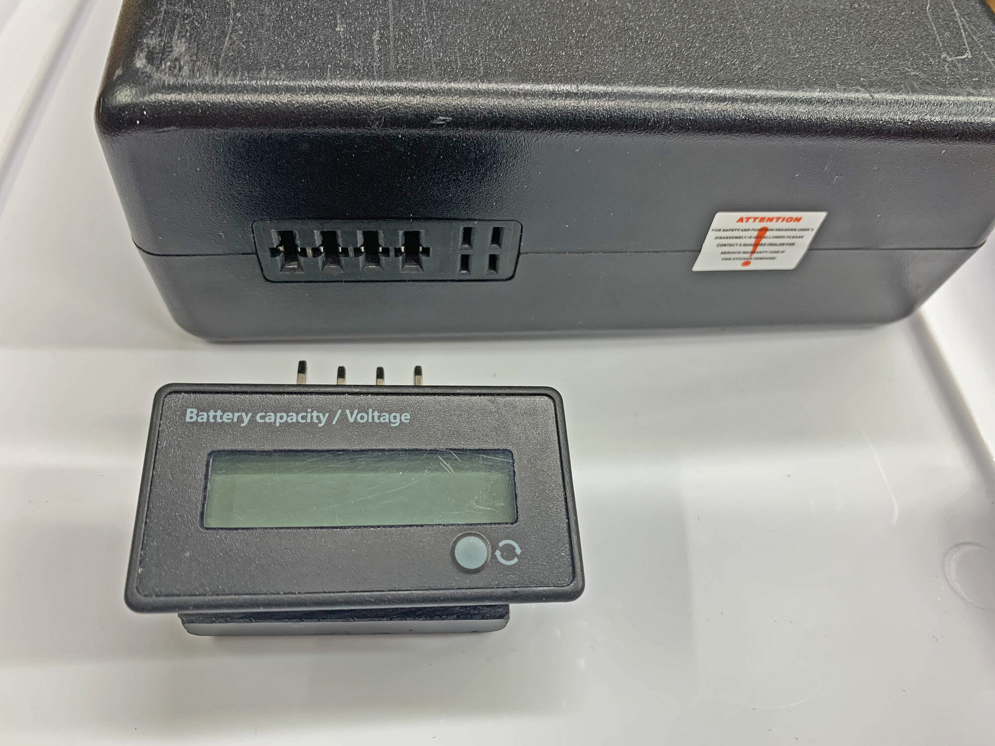

I prefer to measure battery voltage at the discharge port. Depending on the BMS, readings taken at the charge port can be flaky.

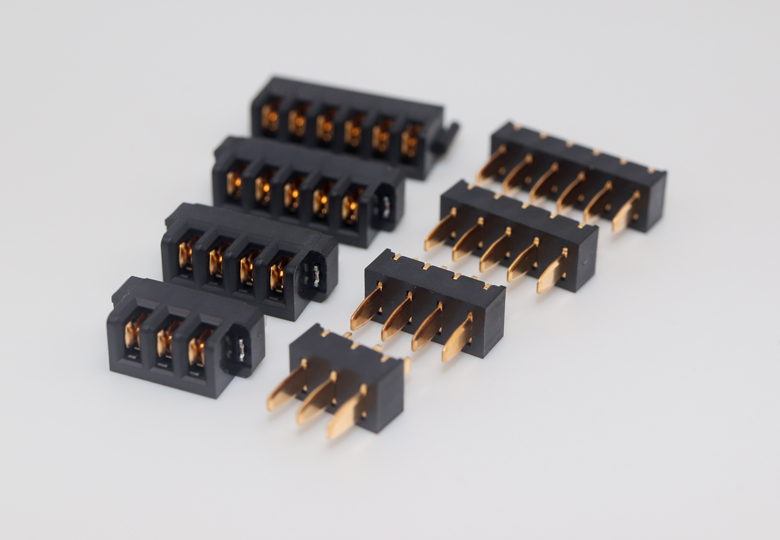

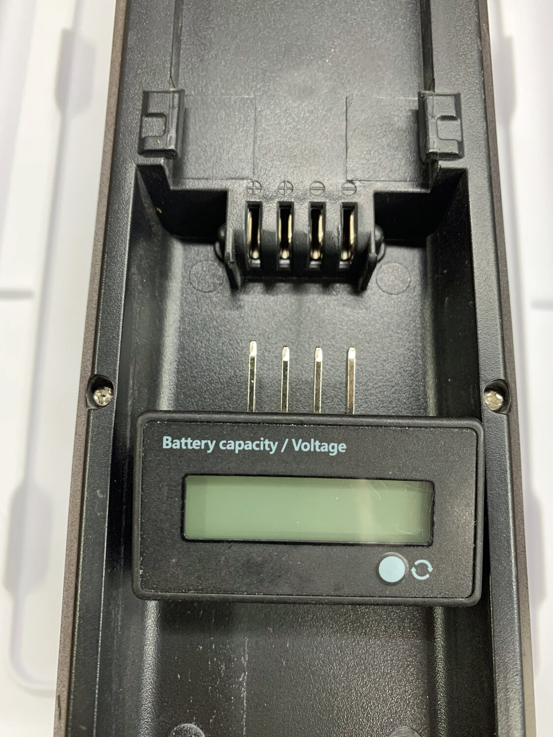

By choice, all my battery discharge ports use the 4 pin version of these spade connectors:

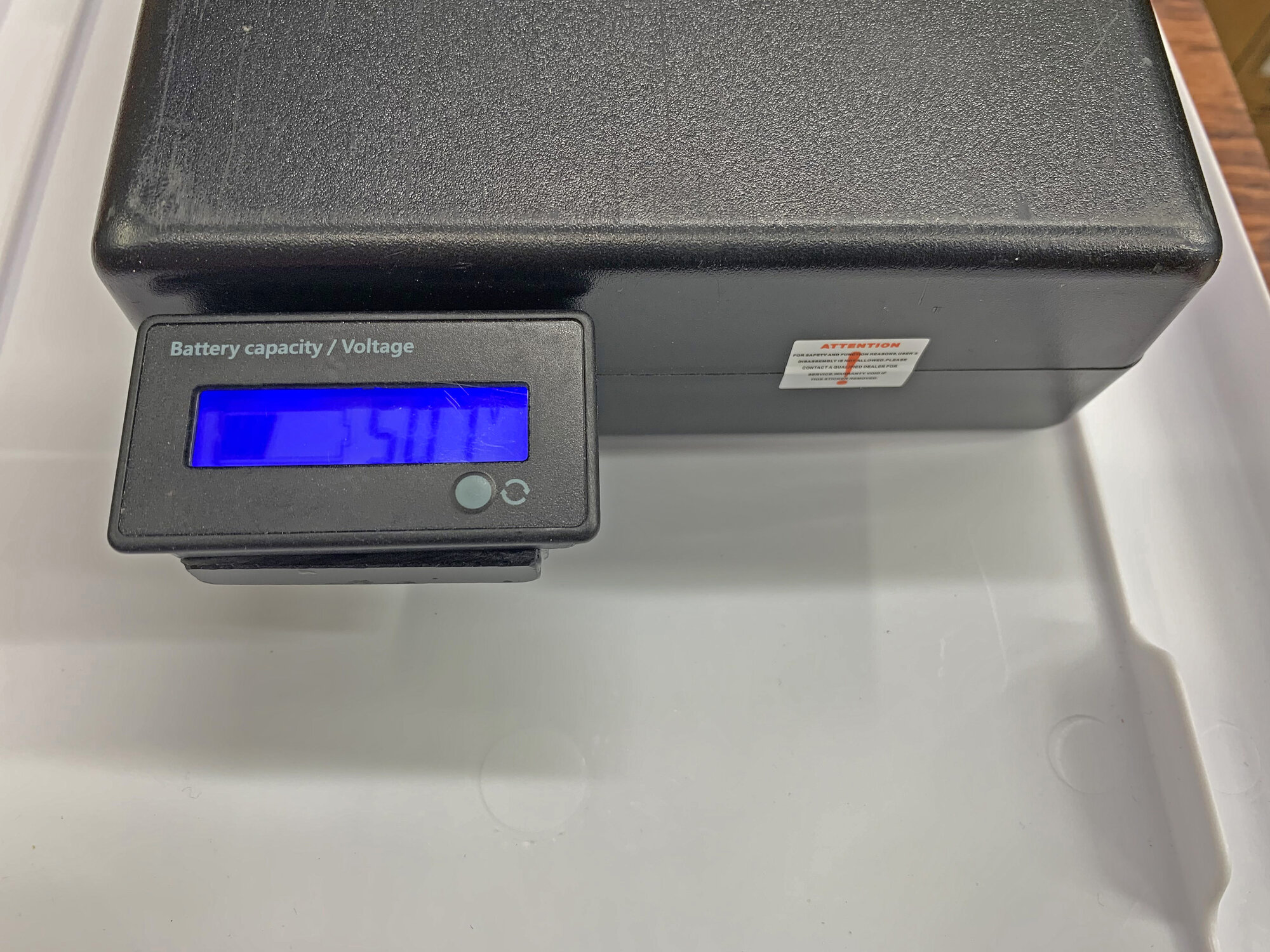

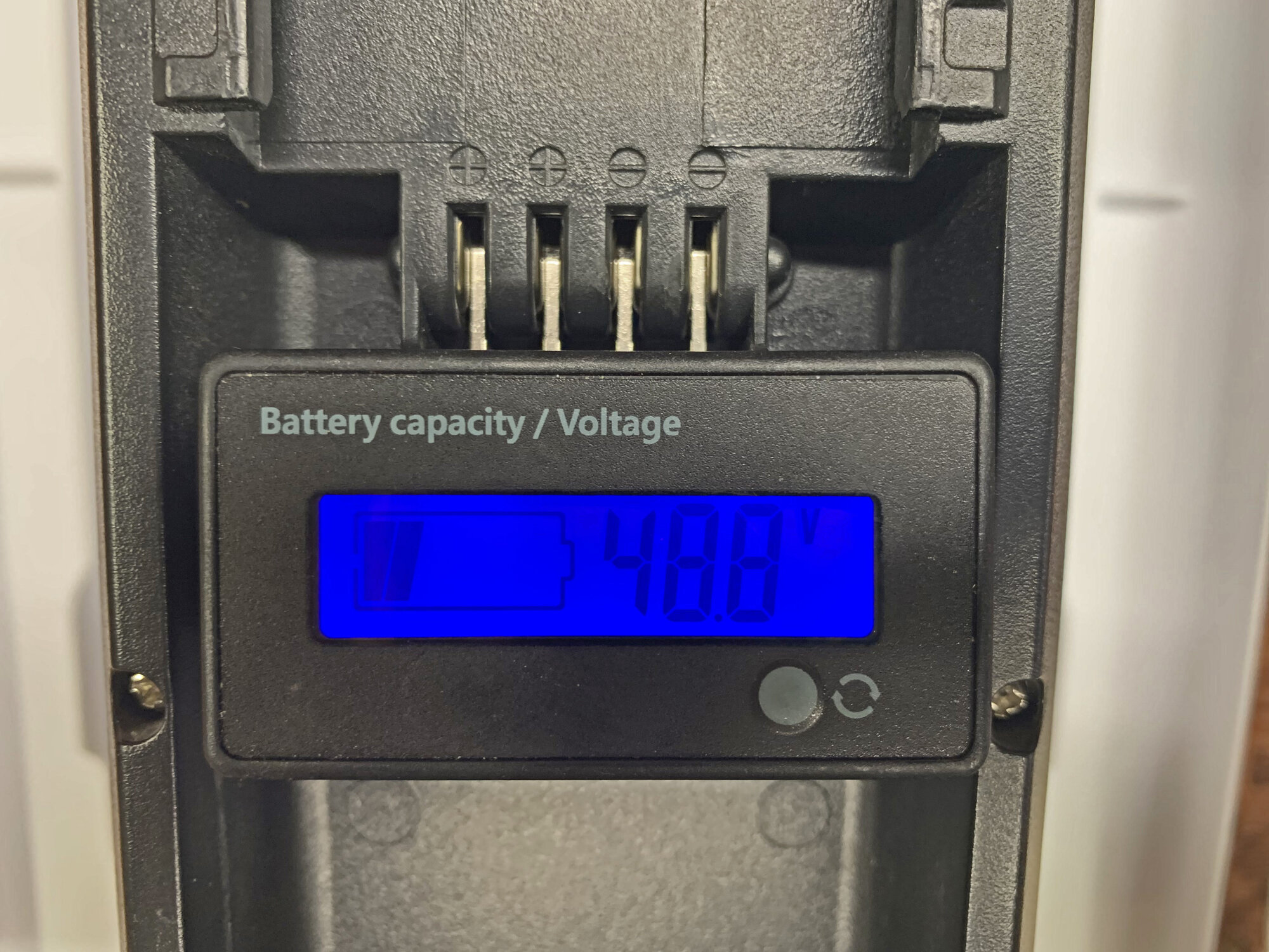

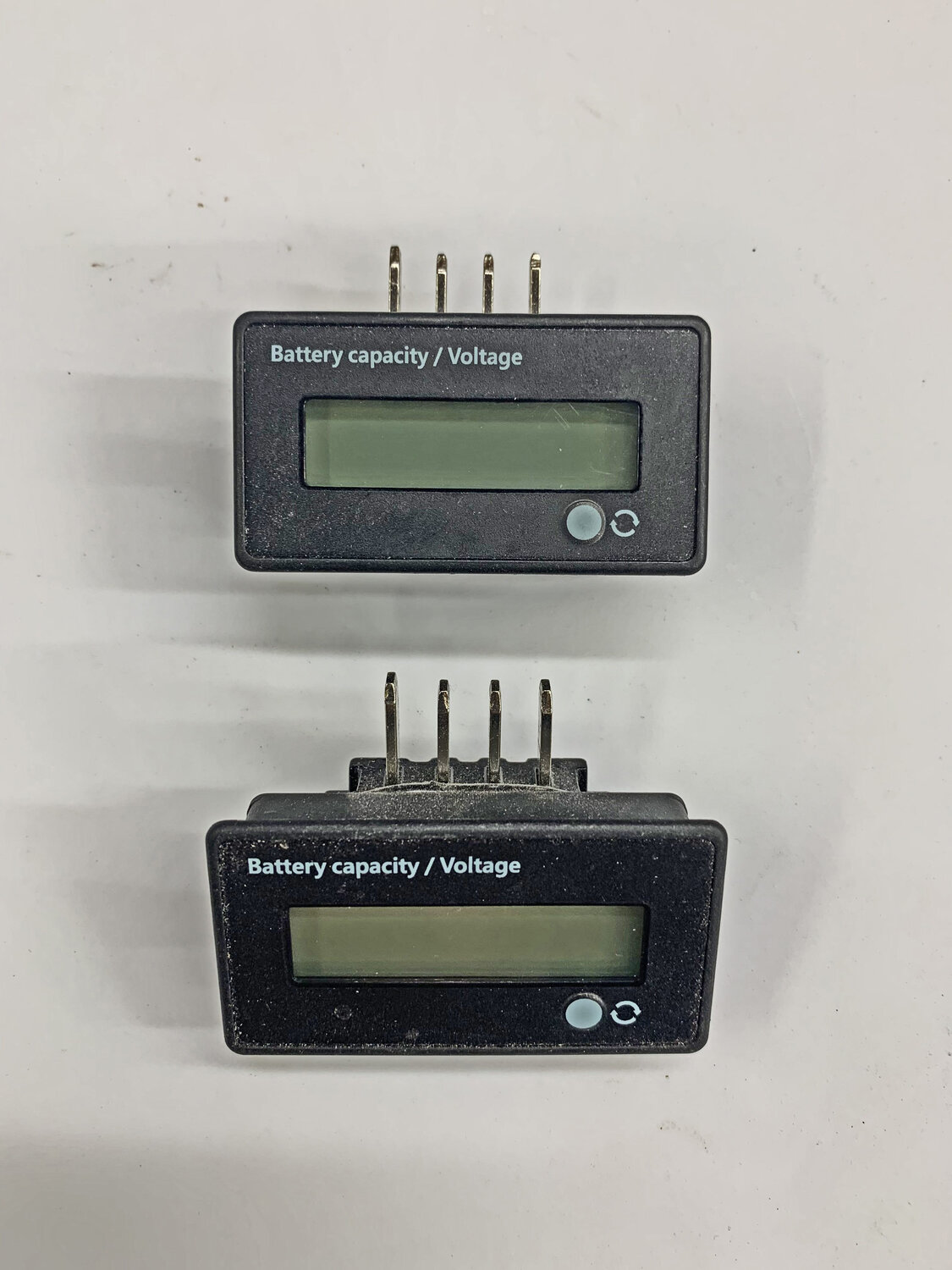

Voltage readings can easily be taken with the probes of any multimeter but for convenience, I made up a few of these cheap digital gauges that plug directly into the ports:

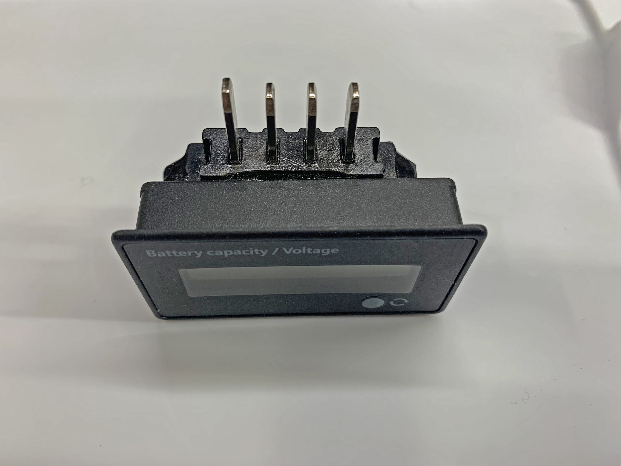

Using a little epoxy, I fastened a male 4 pin spade connector to the back of the gauge:
I keep one in my pocket when riding, in my battery case, and another next to my charging rig.
The same idea can be used with almost any battery discharge port connector, fastened to the back of one of these gauges:

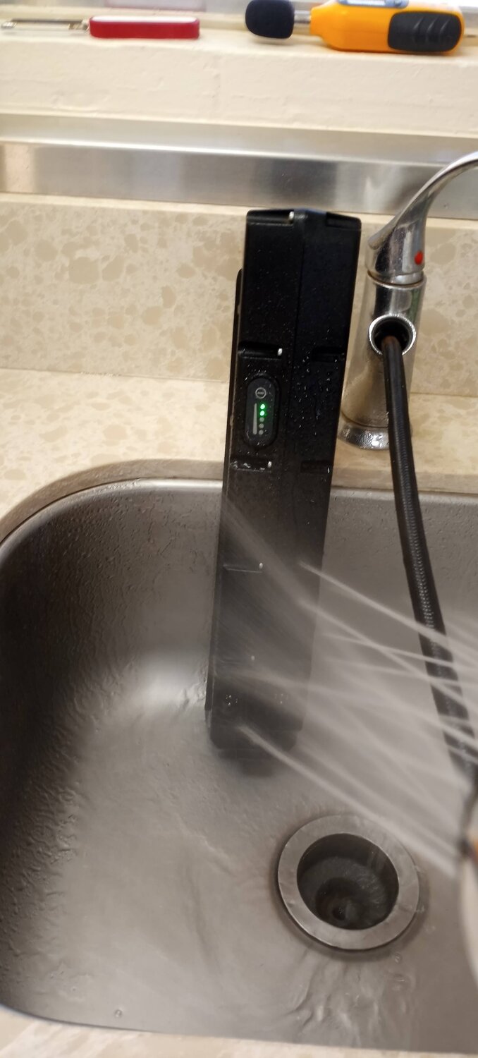

This is contrary to any battery charging instructions on any of the electric bikes I have owned.
Yeah.

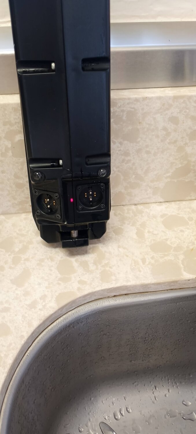

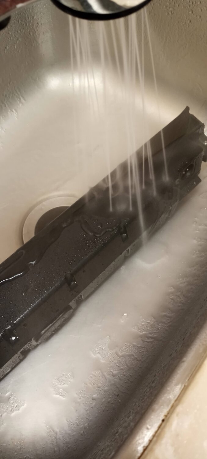

Light wash. I do this after riding my bike in knee deep brackish saltwater puddle.
