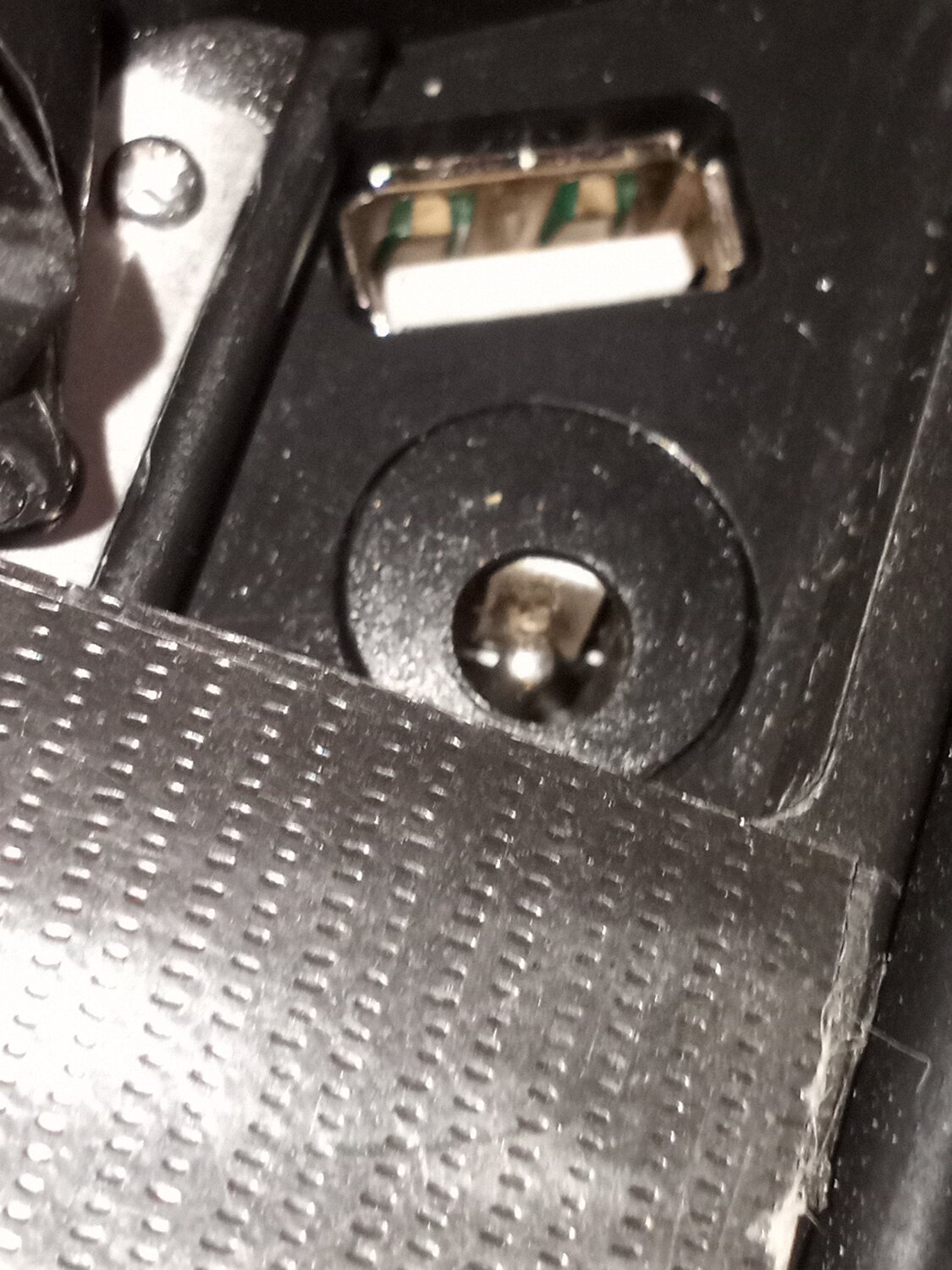

That works for two of my batteries but the third battery gives a HUGE Crack of a Spark if I plug the battery in first.
All three of my batteries are Reention Dorado batteries but they use different BMS's inside.

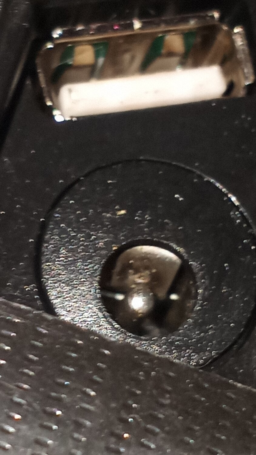

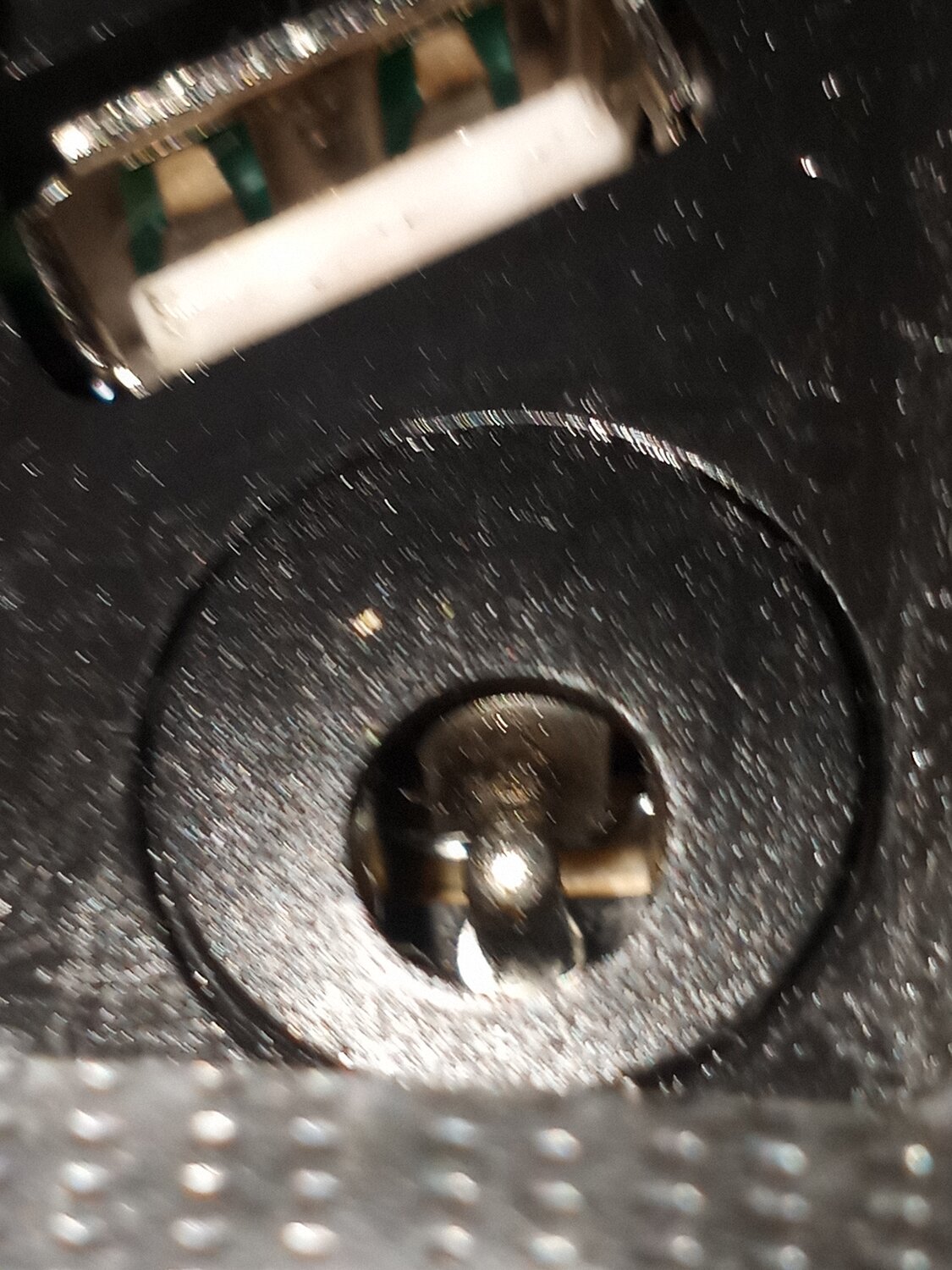

This is the charge port on the third battery. I've plugged it in wrong 4-5 times. That was enough to almost melt a hole through the contact tab,..
With the other two batteries, I get some minor sparking at the wall, but it even sounds different, less intense.

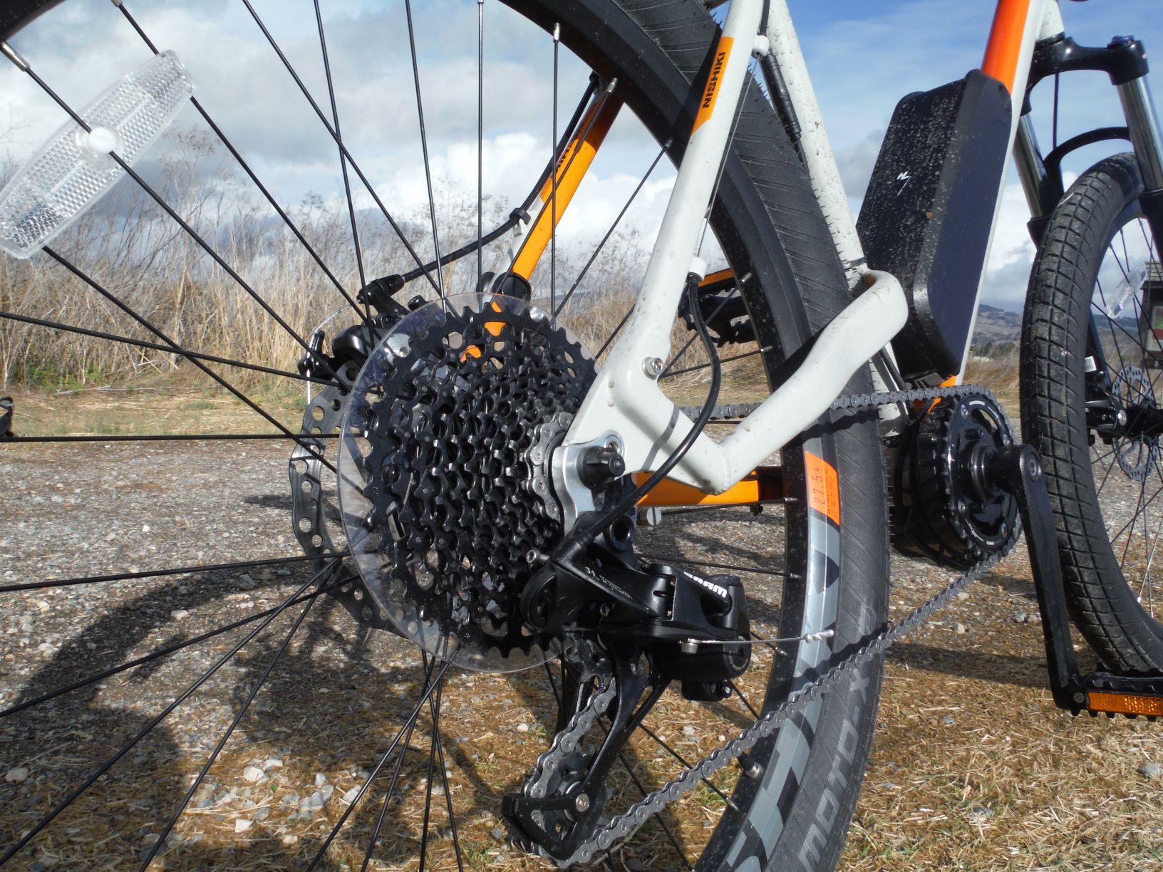

The last time it happened I was selling a GT with a BBSOX, and I wanted the extra punch of a 100% battery for the test ride. I smoked the hole. Zap like a tazer gun with welding at the port. That was my third build. Here is that bike. I learn best when I screw-up. The current owner wants me to remove the motor system and make it a regular MTB now. That sucker ate drivetrains. I raced a fat dude on a Harley one Easter Sunday with it and won first to three lights because electric does not need revs for torque. He had moved through the heavy traffic to the head of a light next to me and with a chuckle said, 'Do you want to race'? Those Super MotoX tires are fast. The routing of the chain on that bike was weird. It went under the right chainstay.

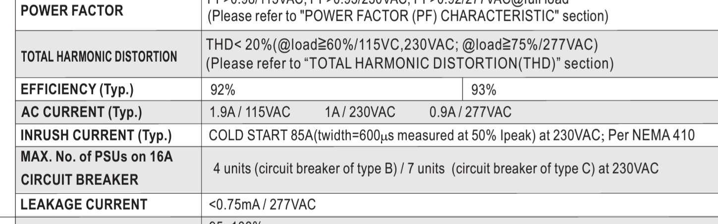

I remember reading the specifications for a MeanWell LED driver (similar to our battery chargers) and the surge current was 65 Amps, but only for half a microsecond.

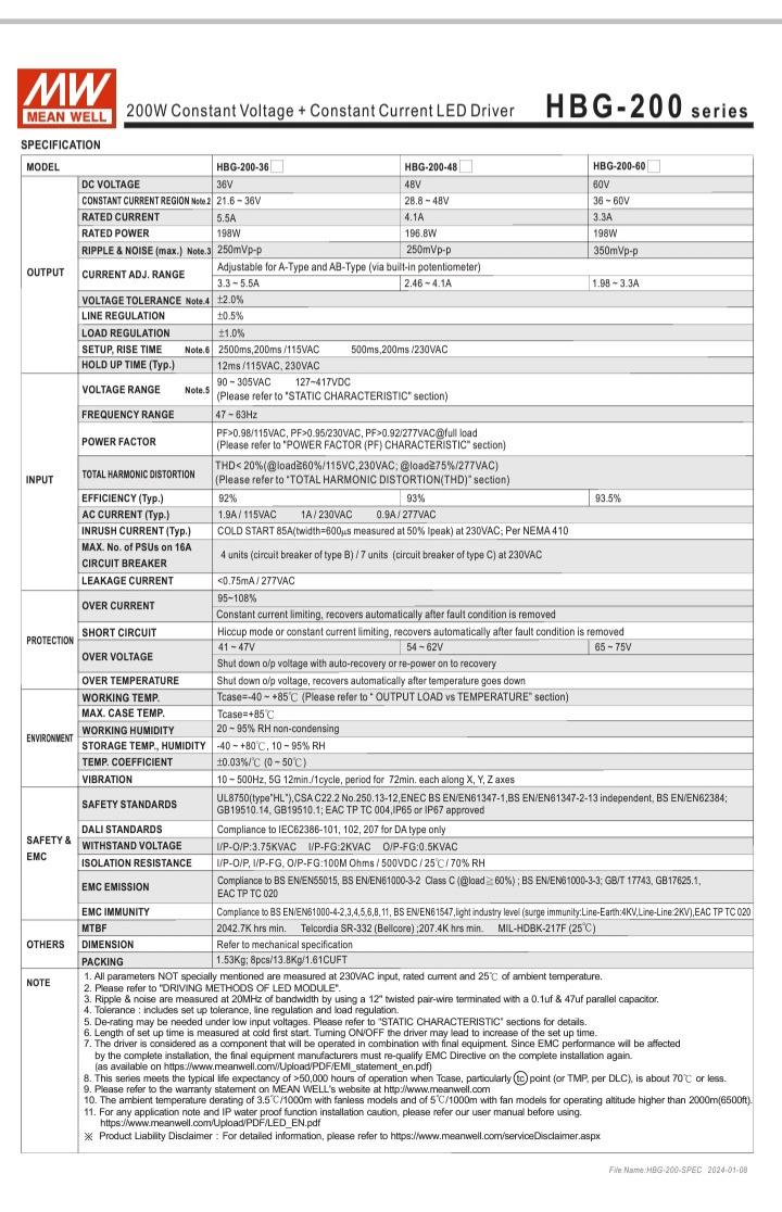

This 200 Watt MeanWell LED driver (battery charger) has a surge current of 85 Amps for 0.6 milliseconds, on a cold start.

You can do some pretty serious welding with 85 Amps. 😂
