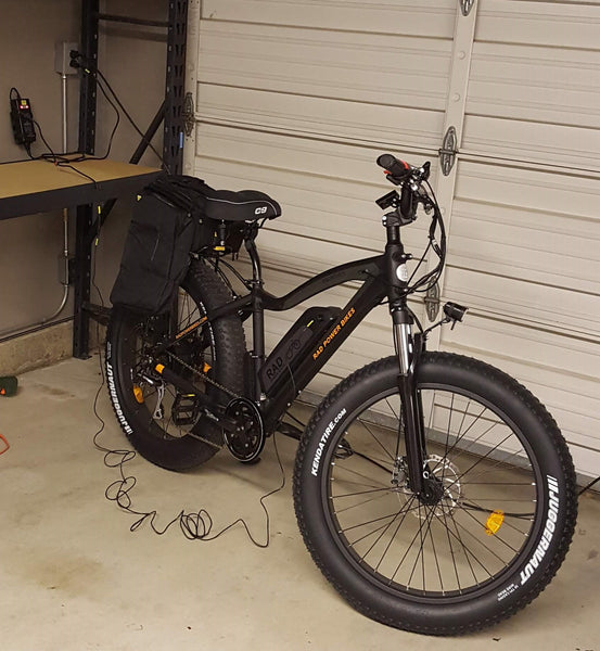

I got a Rad City and really like it. Where I park the bike it is not next to a wall and I would like to extend the wire between the charger and the bike so the power brick isn't hanging in the air or lying on the ground next to the bike. I am very familiar with wiring. What I am wondering is if I get a second charger to splice longer, what is the size of the plug on the battery? It looks like a 5.5 by 2.1 but was wondering if anyone knows for sure.
On that note is the battery BMS built in to the battery or is it on the charger? As I don't want to alter the original charger (might keep it at work) can I get a "dumb" 54.6 volt supply and use it without issues?

5.5mm x 2.1mm barrel plug, also called DC power plug. Very commonly used on inexpensive chargers.

I did get an amazon charger https://www.amazon.com/gp/product/B07SLWTVK2/ref=ppx_yo_dt_b_asin_title_o02_s00?ie=UTF8&psc=1 with the 5.5 x 2.1 size and it works. I noticed in the reviews someone with a Rad City had been using one for a while.
I wish I had seen those 5.5 x 2.1 extensions :) I did end up opening the charger and adding 12 feet of #16 to it. The existing wire is #22, seems too small to me, but 2 amps and 2 feet it might be OK.
I have the extra charger is mounted on the wall and the cord runs up to the ceiling, over and hangs down about a foot off the ground where the bike usually is. It makes it easy to plug and unplug. If I want the cord out of the way I put a hook on the wall in front of the bike to hook the hanging wire in to hold it out of the way.
