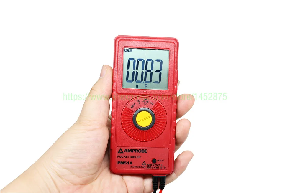

Pocket MultiMeter:
I got this one awhile back from Amprobe, one of the larger manufacturers of multimeters. The cost is reasonable, it's super easy to use, and works on all voltages and power types, AC or DC, and of sufficient reliability and accuracy. You have to be careful of these if you're working around high-voltage, of which I do not. Just a word of caution.
One feature I require that is not always included in a meter is an audible continuity test. You can test a wire or circuit for connectivity and if it does connect you get an audible tone. Great for testing switches, circuits, connections, etc.
Amprobe PM51A: https://www.amazon.com/dp/B001L4E9Z6/ref=twister_B014G33LKC?_encoding=UTF8&psc=1
