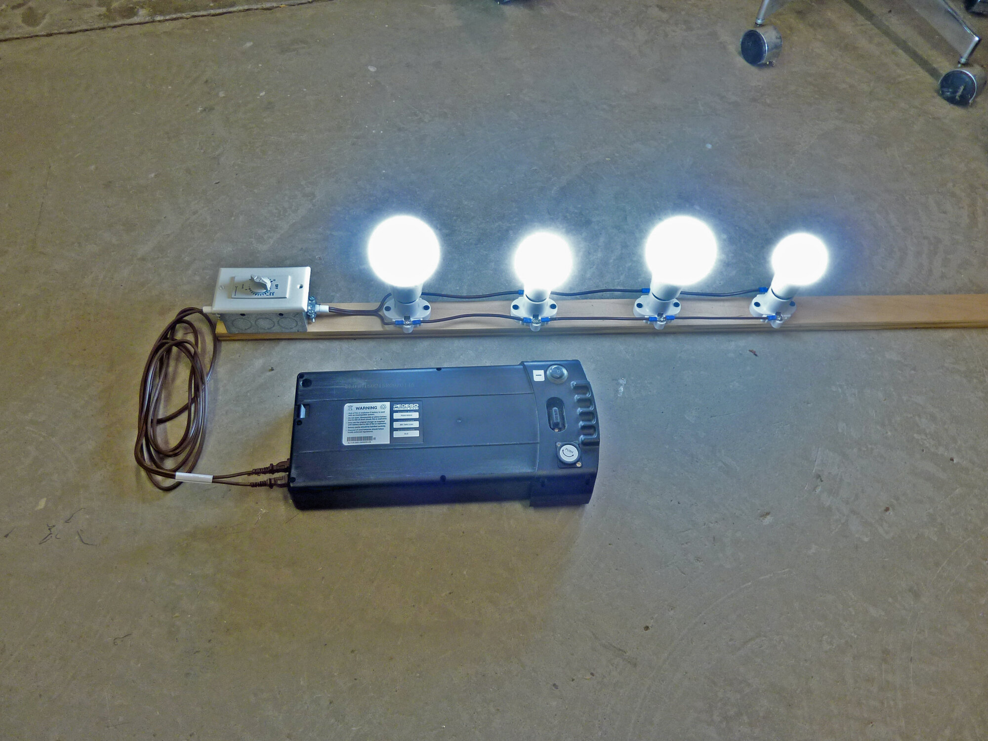

I occasionally check battery capacity using this discharge rig:

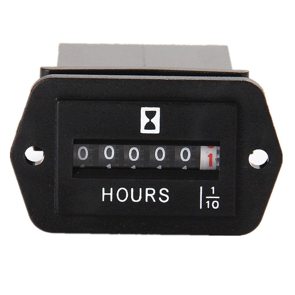

To measure total capacity, I add this hour meter to the circuit after charging the battery to 100%:
The discharge rig draws 1 amp. When the battery BMS shuts off the current, I multiply 1 amp times the hour reading on the meter to get the AH capacity.
I only do this once or twice per season though to avoid battery damage from repeated over discharge.
After 3 seasons of use (+/- 3000 miles) my main battery has lost 6% of it's original capacity.
That's incredibly good.
6zfshdb, I forget your battery charging routine - you charge to 100% a lot of the time is that correct? And if you're not able to use the bike right away, you drain the battery down a bit using light bulbs.
Yes, I store my batteries at at 40 to 70% and charge to 100% just before a ride. I rarely discharge below 20%. I discharge to 40 - 70% if the ride didn't do it for me.
I know the prevailing practice for max life is to only charge to 80% but I need the extra capacity for many of my rides. If it means replacing the battery a year or so sooner, so be it. Who knows, by then a lighter battery with more capacity may be available.
