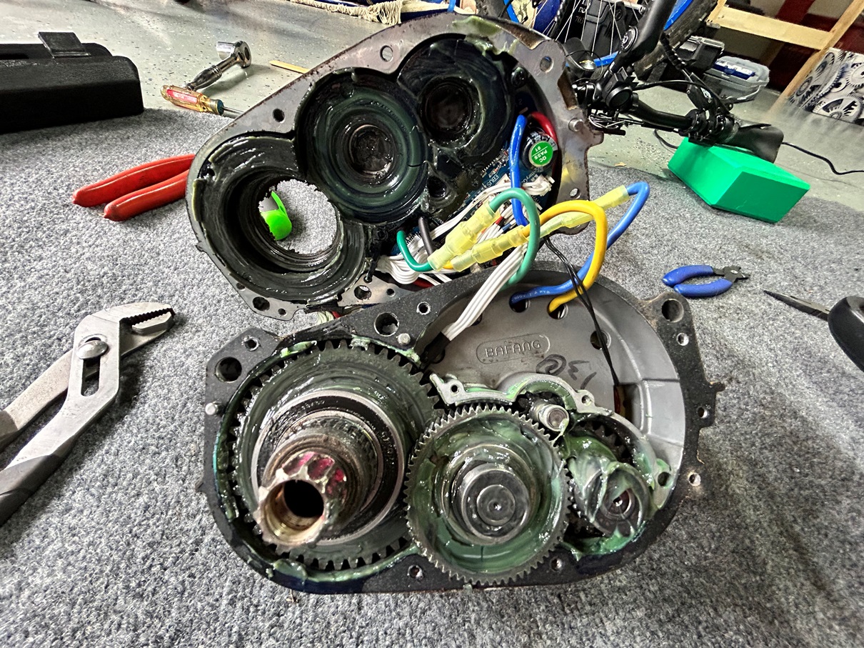

My BBSHD seems runs nearly silent. When I got my Ultra, I was concerned about the noise. Not loud, but loud compared to the BBSHD, The noise did quiet down after the first few hundred miles. Then I opened it up to reveal a paltry amount of factory grease. I filled it with John Deer Corn Head grease and it reduced the noise by 60-70%?
Easy to open and grease, lots of videos on Youtube. May take you 1.5 - 2 hours the first time. After that, about 1-hour.

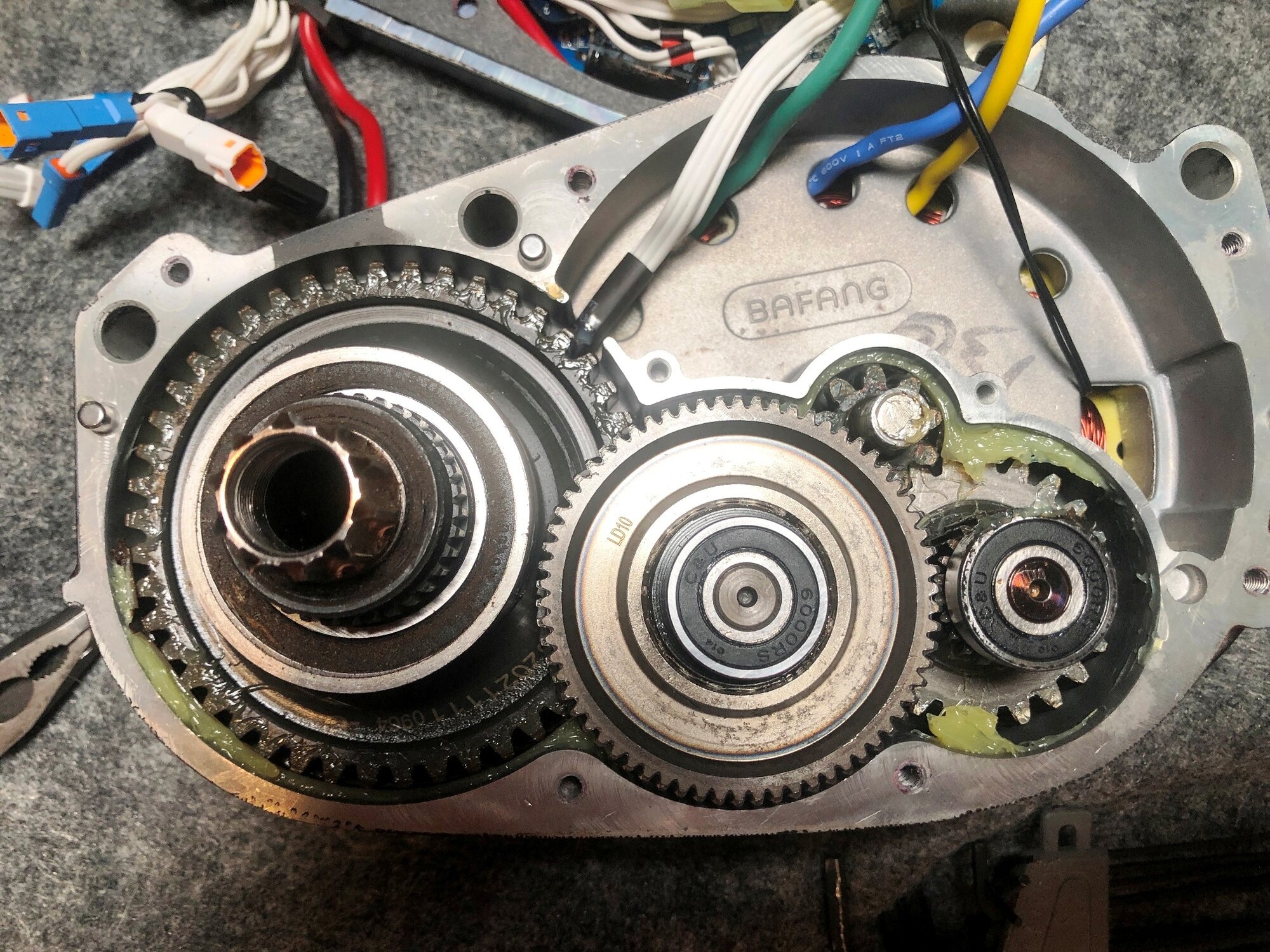

My Motor after initial 500-600 miles with factory grease. At this stage I added a few ounces of Corn Head Grease and closed it up.
Reopened it at about 2,500 miles to check on the Corn Head grease. I was very satisfied.
Just last week I opened it with about 3,500 miles on it, and it looks the same. Loads of Corn Head grease in all the right places.

Corn head grease is a polyurea based 0 grade grease that liquify's during use which doesn't effect efficiency (as much) and returns to grease when static. My motor becomes quieter as it operates for example. #2 grade lithium greases remain thick while in use which can reduce efficiency. Regardless a certain amount of grease is desired in order to reduce friction between the steel gears that causes wear. There can be too much of a good thing though and the amount shown above is a good example of what constitutes a proper amount.

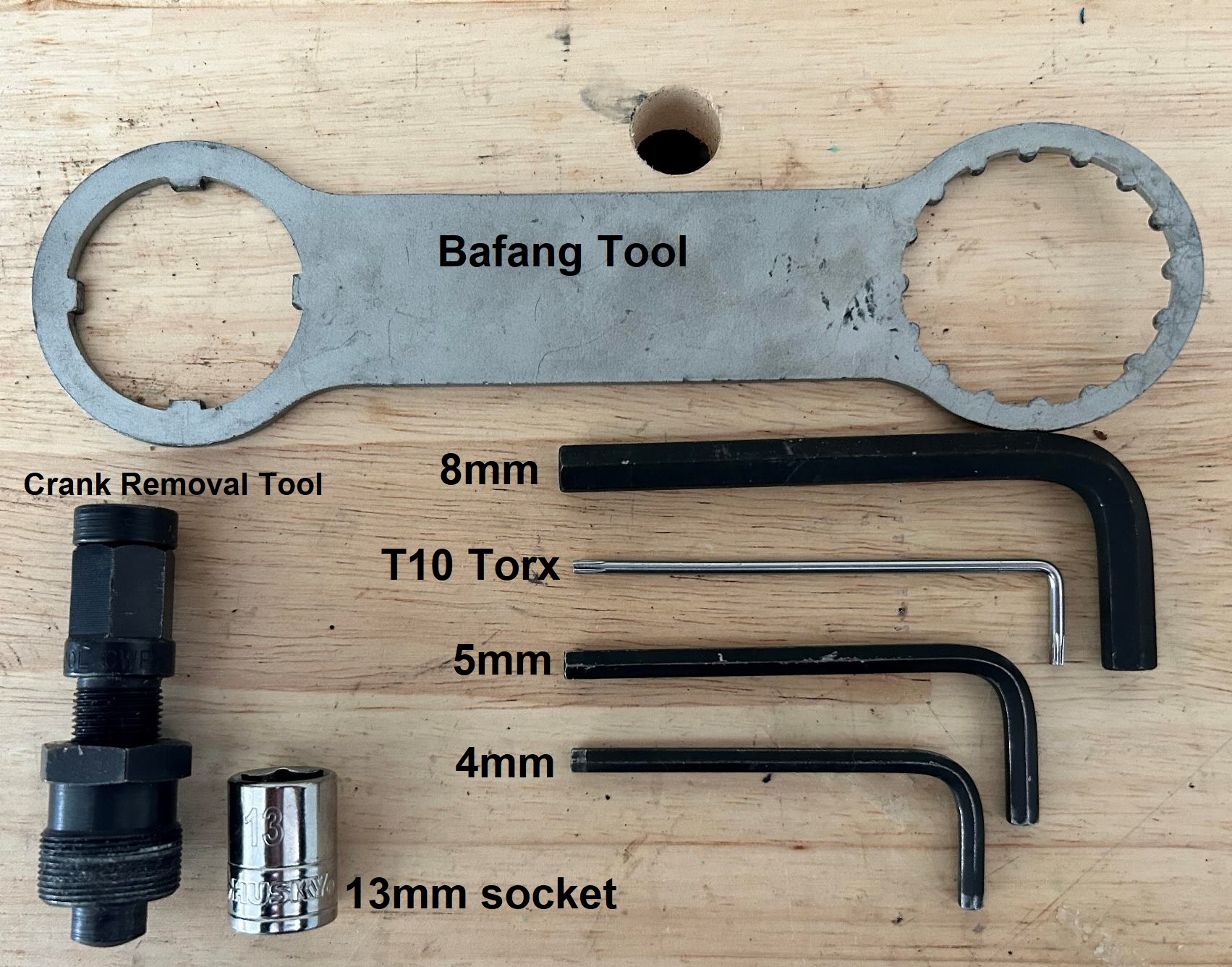

Here are the tools you will need to remove the motor and open it.

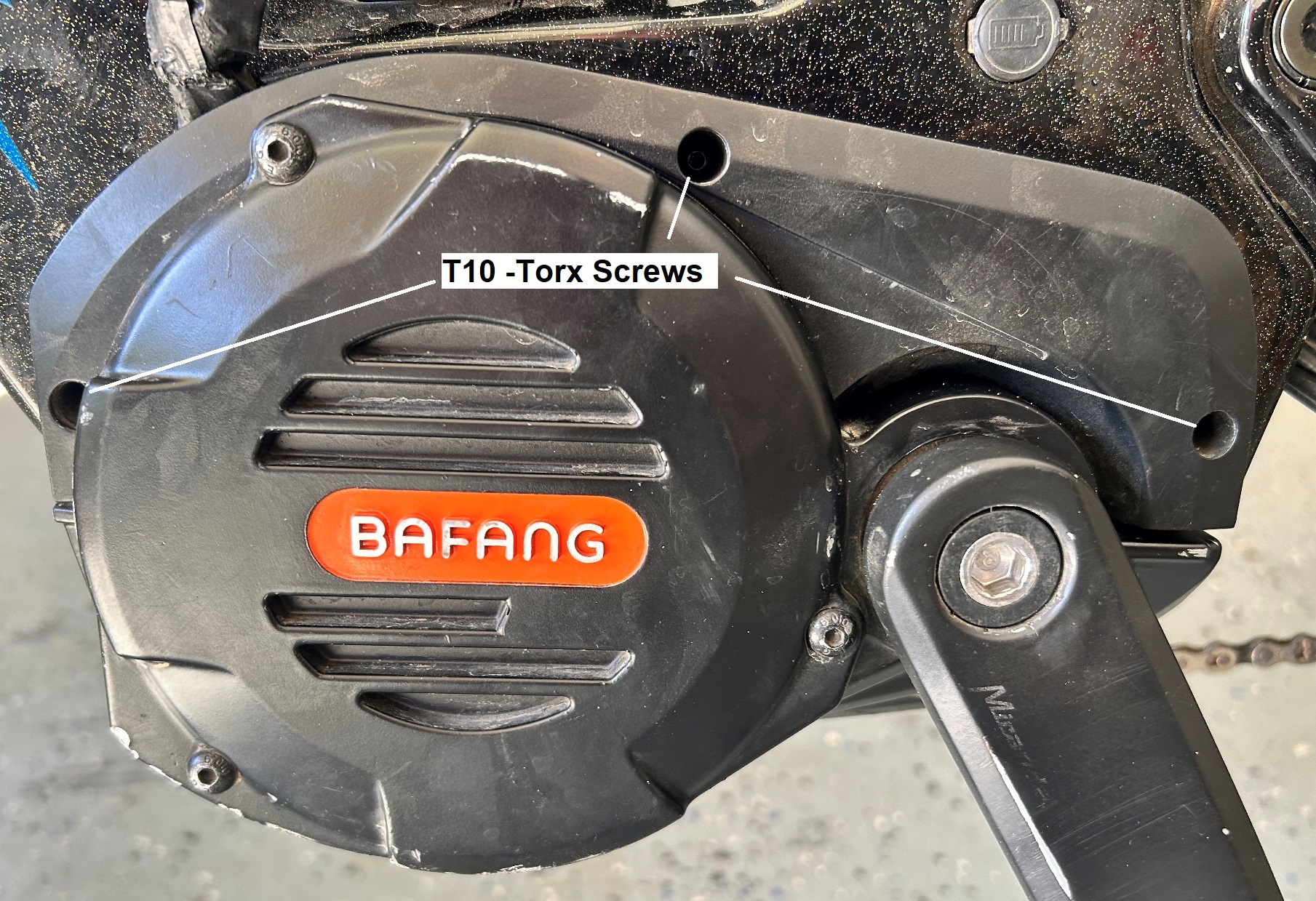

Remove the plastic upper cover on the left side of motor with the T10 Torx tool

Remove the six motor casing screws with 4mm Hex.

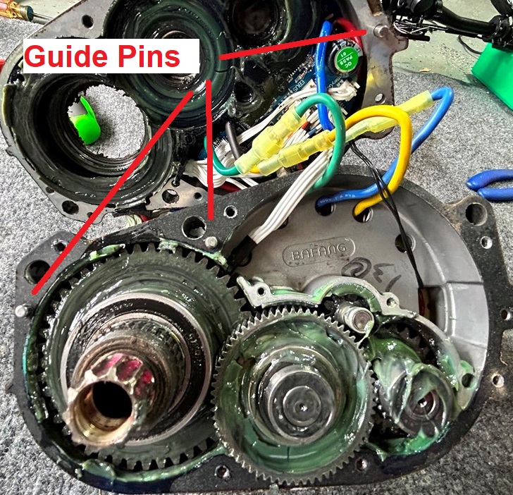

My motor case splits apart by hand, you may have to tap it or use a small screwdriver to split the halves initially. Take care to preserve the paper gasket. It's pretty durable and may be reused.
There are three guide pins that assist you when putting the motor back together. They can fall out, just stick 'em back in.
Reassemble in reverse is.
CAUTION: Be careful not to crimp any of the controller connectors and wires when reinstalling back into the frame.
