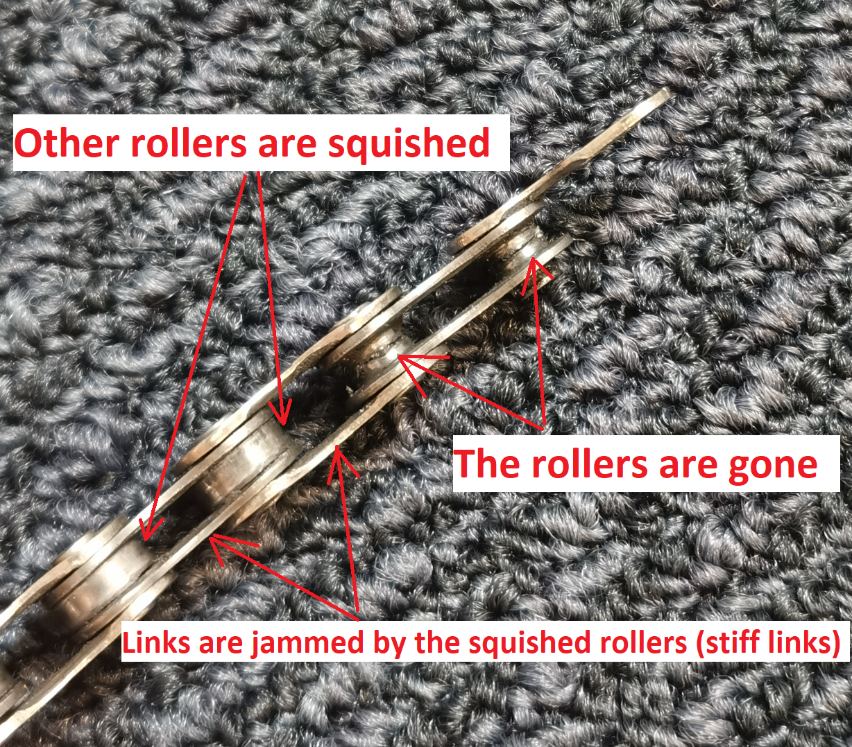

Unbeknownst, I had a broken slide and the battery didn't fully lock.
It felt locked. Key fully turned, but a bump and it came off, smashed into and bent my ring gear which snapped my chain that immediately locked up.

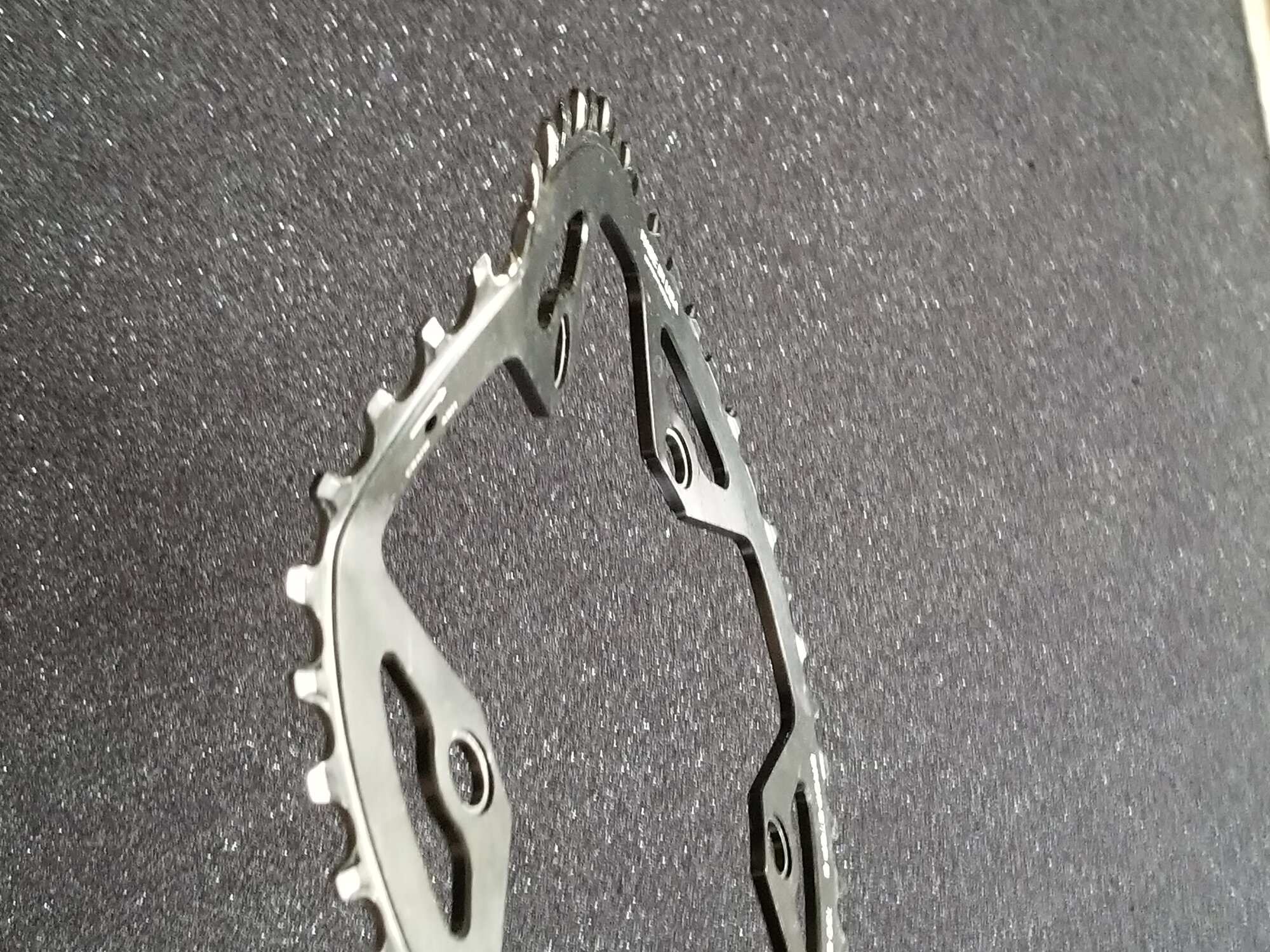

I also took this opportunity to perfectly size a new Shimano chain and replaced the Wolf Tooth 50T with a WT 52T.

Bafang Fat spider appears to be
one gear off, w/ chain-line a tad inboard, favoring 5th gear.
6th (center cog), 7th, 8th and 9th are within the (recommended) '3 degrees limit'. 10th is right on the line and 11th gear is +4 degrees off centerline.
Yup. Just like members here have said:'10 and 11 are getting beat to death' - well along those lines and it'show I see it too. Even the ring gear's wear is focused on the inside.
A 3mm offset shim and 8.5mm bolts would favor gears 8, 9 and 10, with far less stress on 11.
