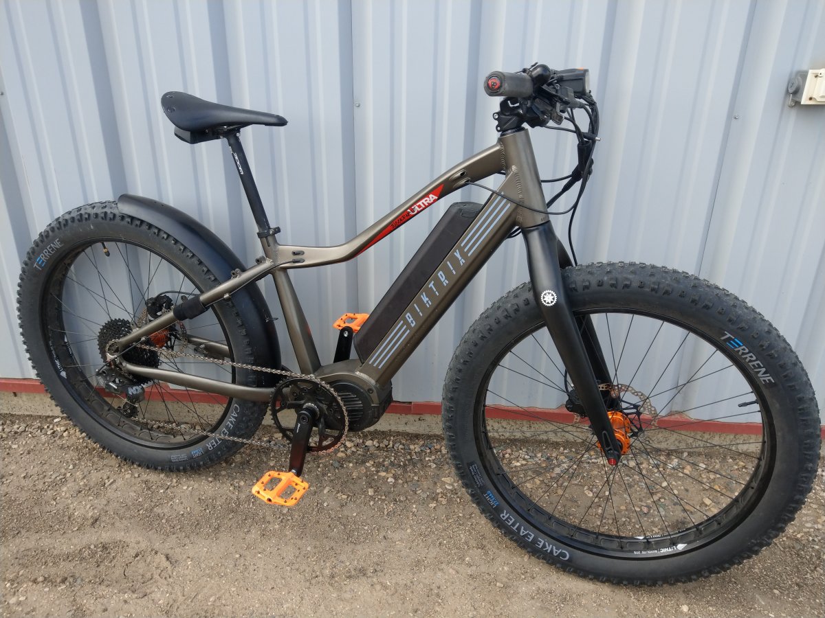

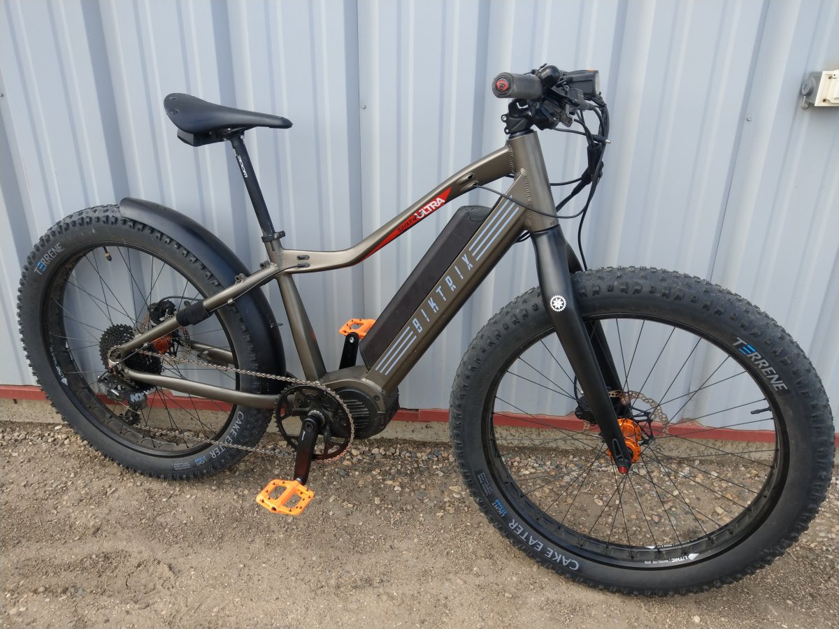

Deafcat, you mentioned that the stock seatpost was too short and Biktrix offers 2 different ones as upgrade/options & I'd like to get a suspension seatpost something like a Cane Creek ThudBuster. Wouldn't that be a better option than the 400mm Zoom? I know that they are a bit pricey but I'm sure it would improve the ride 110! What do ya think?
I've never felt the need to get a suspension seatpost, but they definitely work. So do titanium, carbon, and broached aluminum (thompson elite) seatposts for that matter... The longer the seatpost extension, the more flex they provide, which adds to saddle compliance for a smoother ride. Suspension seatpost just takes that a step further by adding actual travel into the mix.
I have one and like it. You can see it at my photo a couple of posts back.
