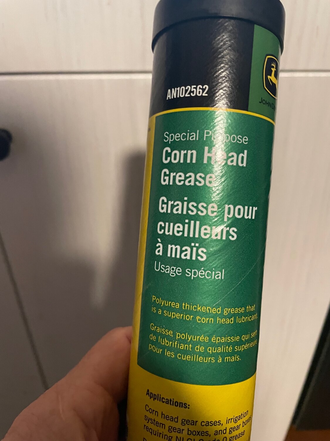

My M620 is a bit loud, but not offensively so, and supposedly using Corn Head Grease, rather than Mobil 1 Synthetic, is supposed to help so I got a cartridge and going to take out the motor, clean and add some but for sure not as much as that guy did!

Yesterday's ride with my buddy that has a Levo kind of displayed the difference in sound level though as his bike is really quiet but the Brose is known for that due to the belt final drive. I don't expect it will make it silent but I am a sucker for tearing perfectly good working things apart in the interest of even small gains. Plus using a product with a name like "Corn Head" made by John Deere is outside the ebike box enough to make it interesting.

I had a little episode while swapping out my grease gun of the red lithium I was using on my TSDZ2 and inserting the Corn Head cartridge. The gun started leaking red fluid so luckily I had a rag there for that but when I went to undo the Corn Head it was more soupy than goopy and I wasn't well prepared for that and some got on the concrete floor, like enough that I ended up using it to lube the motor.......waste not want not!
Put in probably 3 teaspoons of grease or a little more concentrating a bit on each interface. Pretty easy to see why there is gear noise because there is alot of steel in there whirring around for sure.
