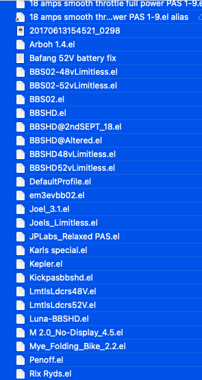

I have a number of .el files. PM with an email address and I'll send them. The forum will not let me attach .el
files.
filesfiles
will not let me attach .el files
