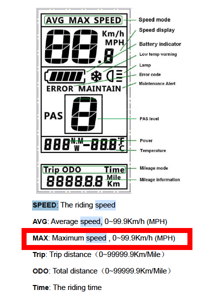

Hi all, I have just completed an ebike conversion using a 500w bafang BBS02 motor with the c965 display on a btwin city bike and it works amazingly well! Only one problem though, when I took it for a test drive I was easily able to reach speeds of around 45kmh, which is awesome, but to comply with the strict Swiss laws I need it to be limited to 25. (I have seen police actually testing random bikes sound town!) I bought this kit as it states it has a speed limit function but it doesn’t do anything when changing it on the display.
Can anyone help? I have ordered a usb programming cable but I am a bit annoyed that it isn’t something already programmed in as stated on their website…

I know but it doesn’t have any effect on the actual speed
So to be clear. you choose a speed setting and the bike under power exceeds the set speed limit? Sorry to be so thick, but I've supported and run scores of bikes with the C965 and the limit works. FWIW I gave up on all but C965, C961, and C963 displays. I ride not watch color screens.
