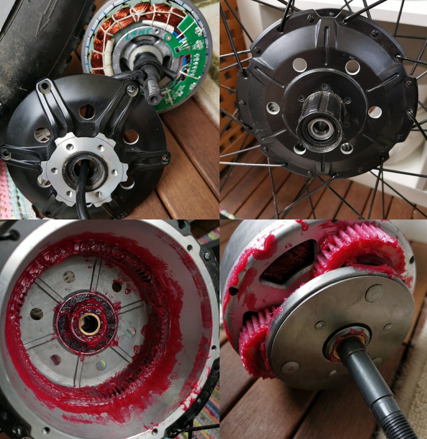

My vented and properly greased G062.1000.DC.
I'm running it 60v 48A max, so 3000w Peak.

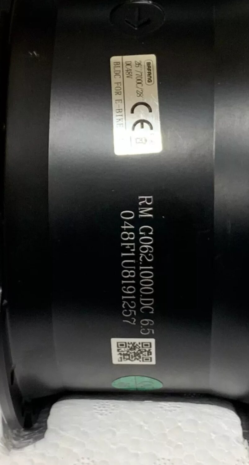

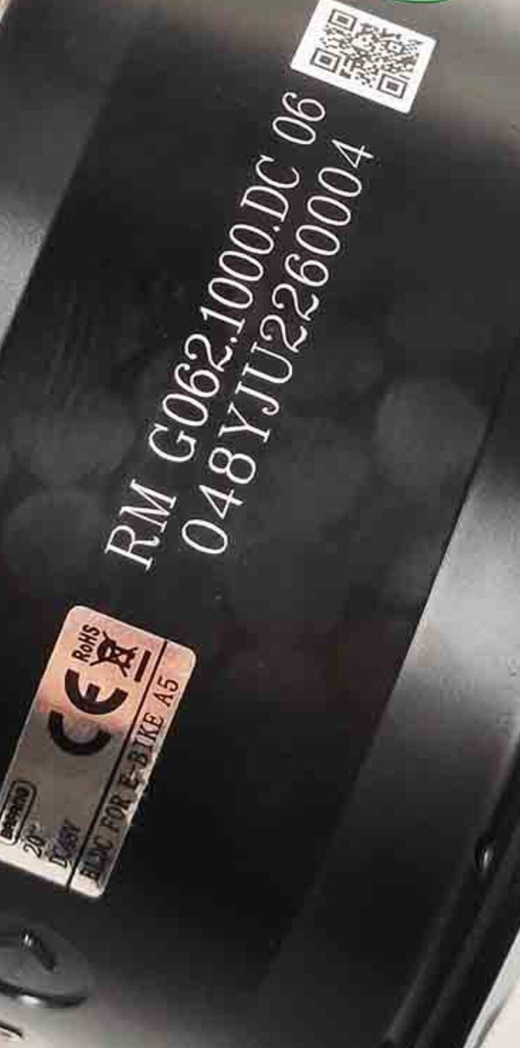

Hi, how would i know what kv version i have please?
Not sure if there are some other versions available but these two Wheels know. 06 is faster and 6.5 is bit slower winded.

Ok cheers JTK77. Mine is RM GO62 1000w D 06. So is that good that it has faster windings?

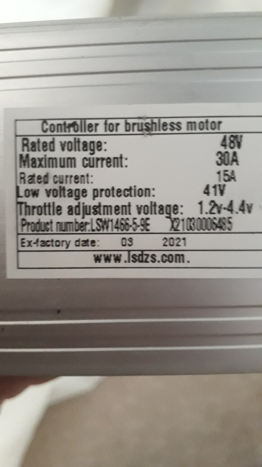

Ok thank you JTK77. Is this a good controller?

Should work fine. Phase/hall sensor wiring order of course can always need adjusting (connector PIN order).

How do you keep dirt and water out of it?
