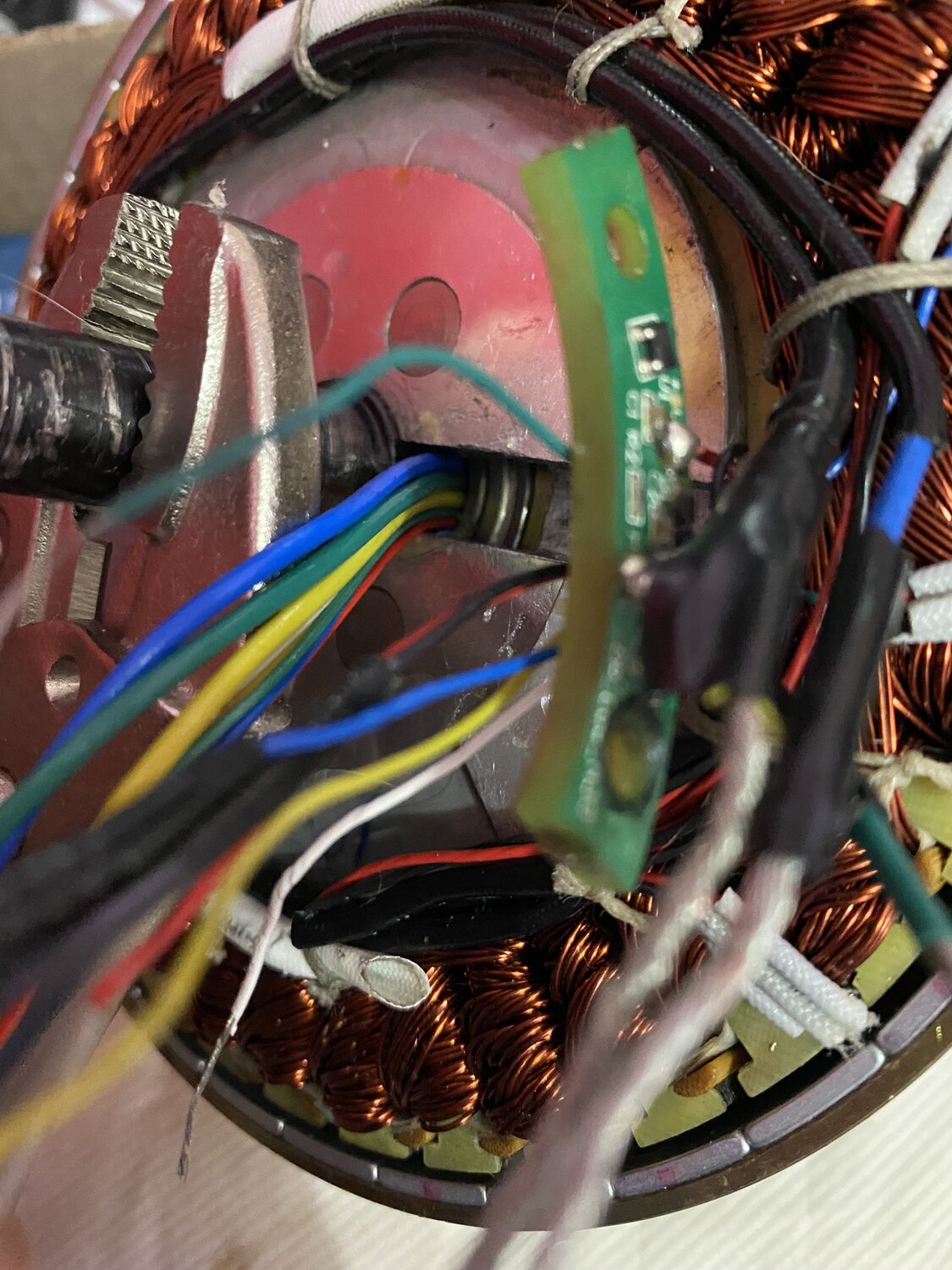

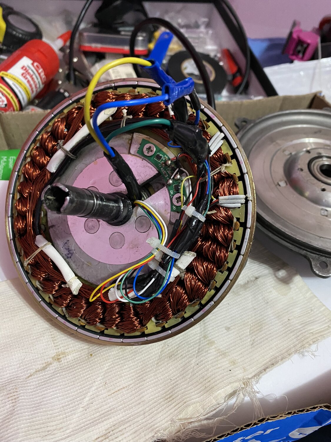

From my repair ...that Dapu 48v motor has some crazy tight tolerances... the imgs r from during the work on 1st try( the 16awg were placed as flat as possble but were still touching the plate and got stripped), 2nd try it went much better , new route for cables and issue free.
