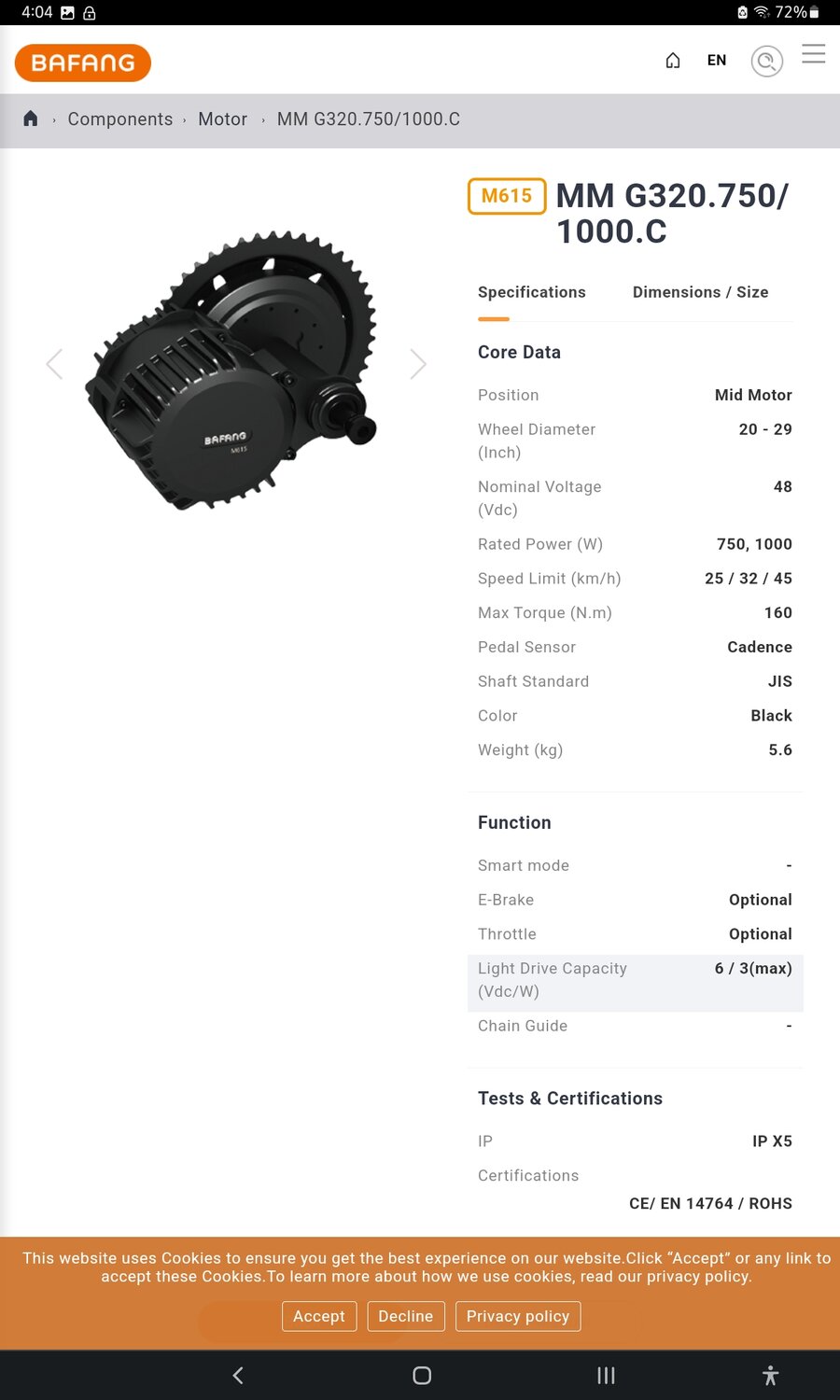

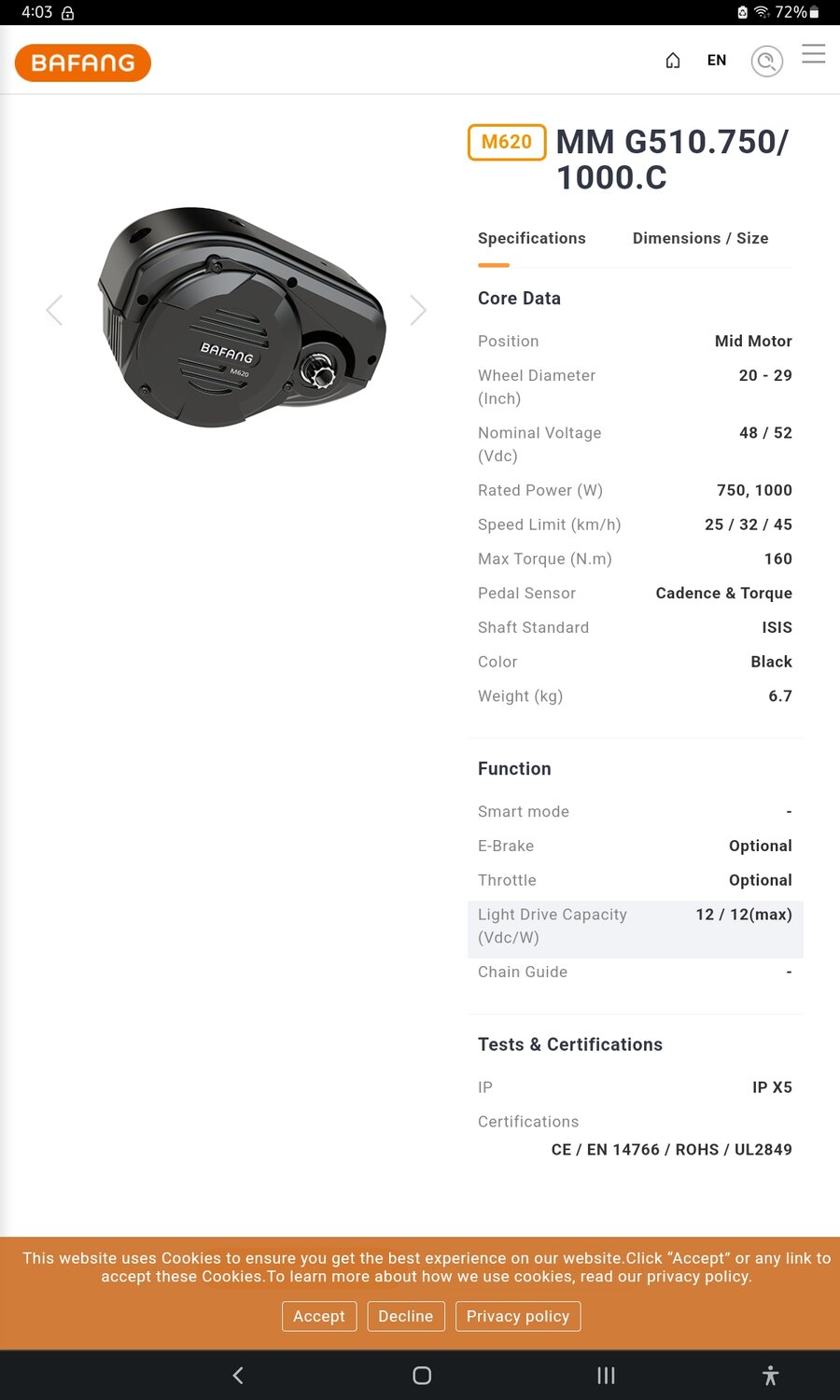

View attachment 159178View attachment 159179
Just as if not more important... I definitely would not immerse or subject the battery to more water spray than riding in rain.

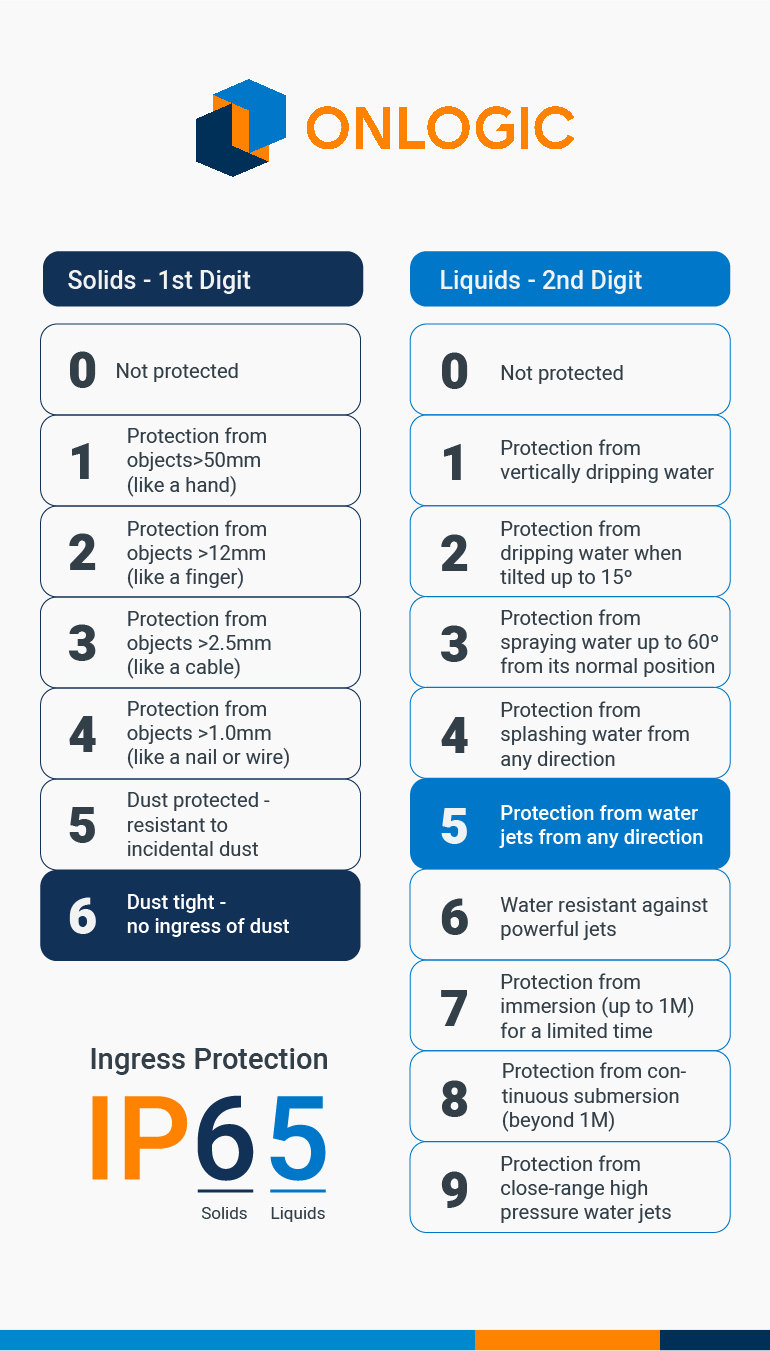

How typical of Bafang. IPX5 is implied to be the same as IP65 (the second digit is a 5) except when you use an 'X' in the first position it signifies 'untested'.
