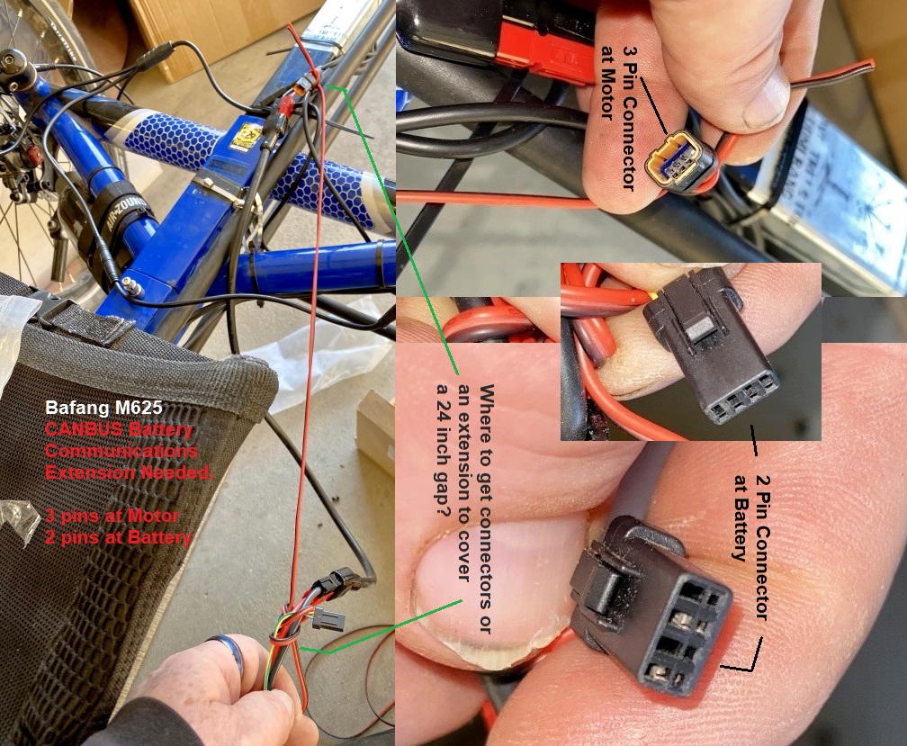

So, I'm rebuilding an old recumbent bike of mine and adding a Bafang M625 motor to it. Due to the motor being at the end of a boom, the distance between the battery and the motor is further than the length of the cables included. An extension for the power cable is easy, they internet is crawling with them. The issue I have is the CANbus cable. Either no one has an extension cable for this (for my situation or for people who need to mount the battery on a rack). I could just cut one of the included cables and solder in a some appropriate wire, but I'd really rather not. I'd like to either find a cable that can do the job, or at least find out what the cable connectors are. I know they have to be a standard of some kind. (The bike is a 1996 ATP Vision if anyone is interested.)
Have been scouring the internet for the EB-BuS 2105020000099 connectors myself. Bafang claims they have no extenders. They will not provide information on the types of plugs used to make an extender. Have found a China vendor that sells the other proprietary connectors with 1 meter leads. Was able to extend the Speed Sensor cable for a recumbent trike. The last connection I need is the same as you, Battery Communications Cable that is two-wire on battery end, 3 wire on motor end.
Told the person that bought the motor that we need to splice the battery (two wire) end since Bafang cannot get their engineers to make extenders.

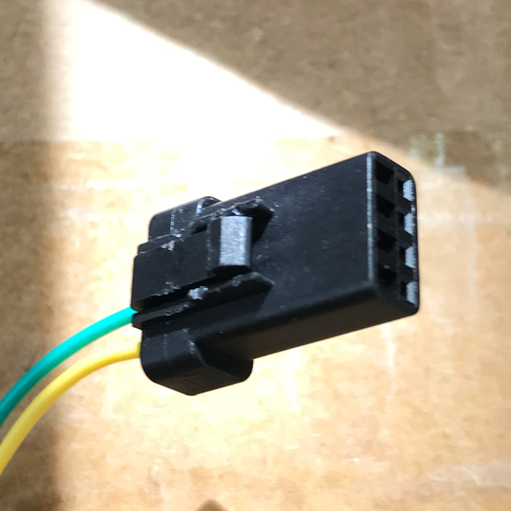

I ended up splicing the battery sensor cable and the speed sensor myself. (The speed sensor needs all four wires.) I also had to splice the power cable to the rear light as the cable that came with the after market light was bad. Ended up doing a pretty thorough stem-to-stern rebuild as this poor thing had been siting in a shed for 25 years. Yeah, the battery sensor cables are a sick joke. Very thin, very fragile. And no, I would not recommend the M625 or M325 to anyone, unless they already know the frame fits.
