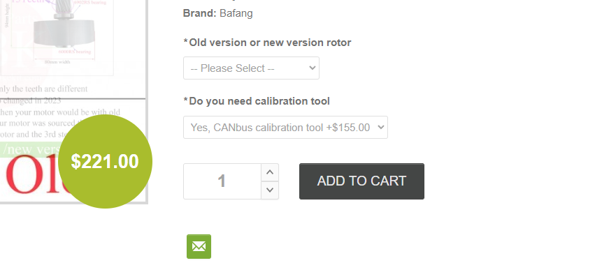

green bike kit have a canbus calibration tool. It doesn't appear to be sold separately on their website but its an option when buying a new rotor. Perhaps email them and ask.
