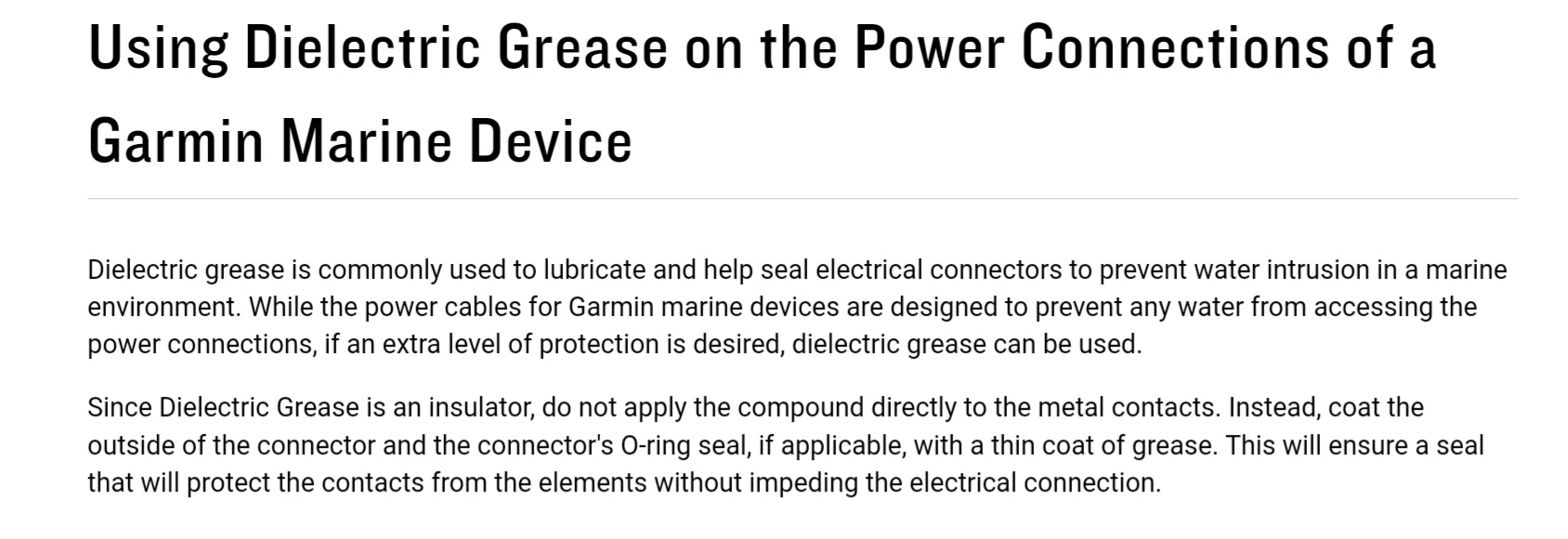

Not to be applied to the actual copper connection points but the plastic/rubber housing of the connector to protect against the ingress of moisture/contaminates
Dielectric = Non conducting
I've been using dielectric grease for more than 40 years for work, home, auto, MC, marine, ebike..... It's often misunderstood. Electrical snap connectors, mechanical connections where there's metal to metal, the grease doesn't restrict the flow of current. There are conductive greases available, but it is dangerous to use where the connectors cannot be completely segregated.
Motorcycle manufacturers and marine manufacturers use dielectric grease on their connectors due to the harsh and wet environment where the products are used.
One of the better explanations:
You DO use it on the contacts, absolutely. It doesn't interfere with the metal-to-metal contacts at all. It cleans them and protects them from corrosion. The tiniest patina on the contacts can stop the flow of electricity. These products prevent that. This also protects from water intrusion to help protect the connections from future problems. I've used all of the products I've mentioned for years with great success.

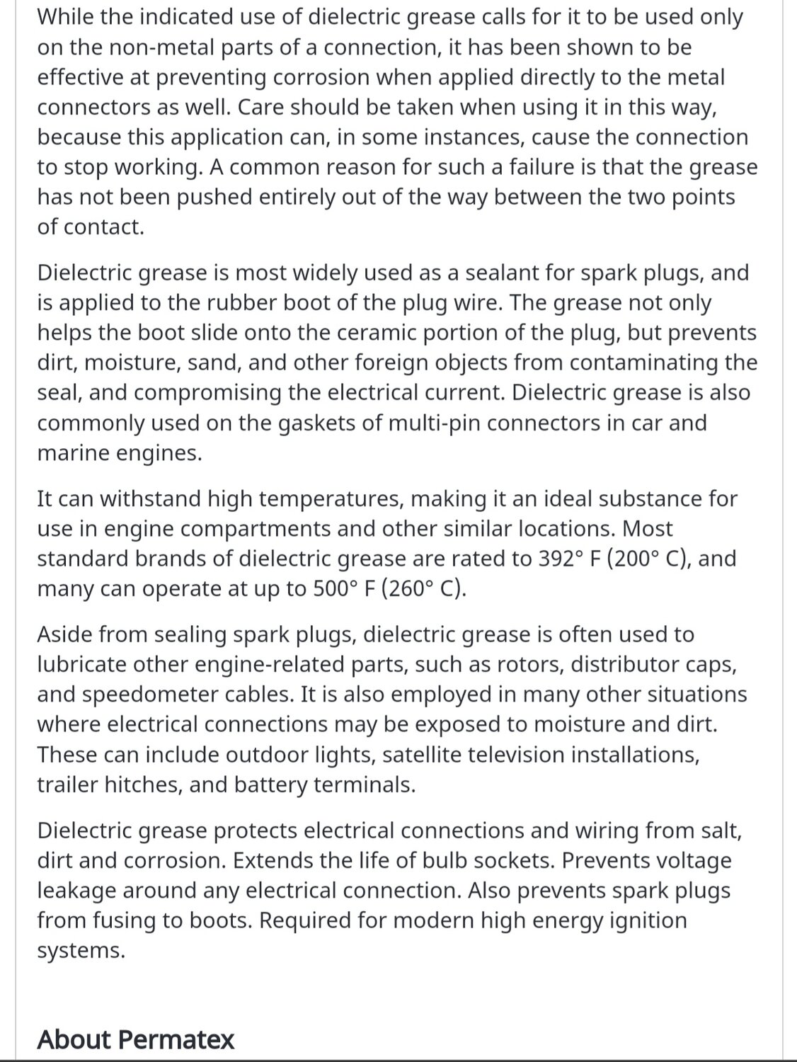

I've been using it for decades myself and with great success but In the manner I described. And as far as I can tell the manufacturer's you mentioned implementation is as l described as well.
The video is interesting but also leading to a not so accurate conclusion. If I were applying it to the stab connector as in the video I would mate it first and then encase it in grease. It would be equally protected and with 0 contamination of the contact points. If you ever used those, they don't mate as tight the second time around and it gets worse with each cycle. It's not that it won't work on day one with a new connector as it will typically push the grease out of the way... it's down the road with vibration.
The stuff is awesome and has a million and one uses. Just this week I lubed the seals on my display connector (I open it frequently to progam). On the pivot point of my espresso machines' froth wand and to lube the rails on a sliding shower transfer bench for an elder relative. Tons of aquarium applications as well. (I use a food grade silicone grease)

I'll just say that if you don't have a good mechanical connection, ain't nothin' gonna work. These products will help with making the connection clean and therefore reduce any unwanted ohms. The dielectric grease (or other product) will get pressed out of that connection and become a barrier to moisture, corrosion and debris. So, I guess in a way, I'm agreeing with you. The grease will only be a problem is the contacts aren't connected.
TT
TT
I agree... The connection needs to be mechanically sound in all cases.
I don't know about the AFC product as the silicone grease and Boeshield have always worked well enough for me.. but they do not clean contacts and I strongly recommend that you do not use it for that purpose.
Contact Cleaner should be use to remove any patina or contaminates. Fast drying and leaves no residue.
If the product doesn't facilitate a better connection (such as conductive grease) then it need not be there and in most cases you can just as easily protect the contacts from moisture by sealing the connector plastic/rubber body the contacts are in_cased in.
This is one of those cases in my opinion where less is more... Your electron flow may vary 🙃
