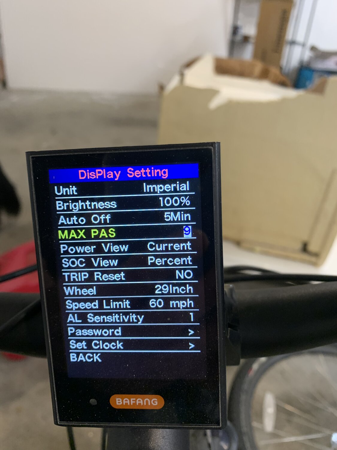

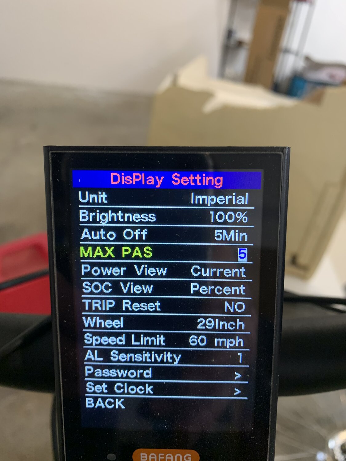

I have the DPC-18 display. You can switch from 5 to 9 PAS really easy by just scrolling through the menu. Mine is almost 2 years old now. It does not have an eco or sport mode which may be in a newer version. It has performed flawlessly. This was in that other thread or some other thread.

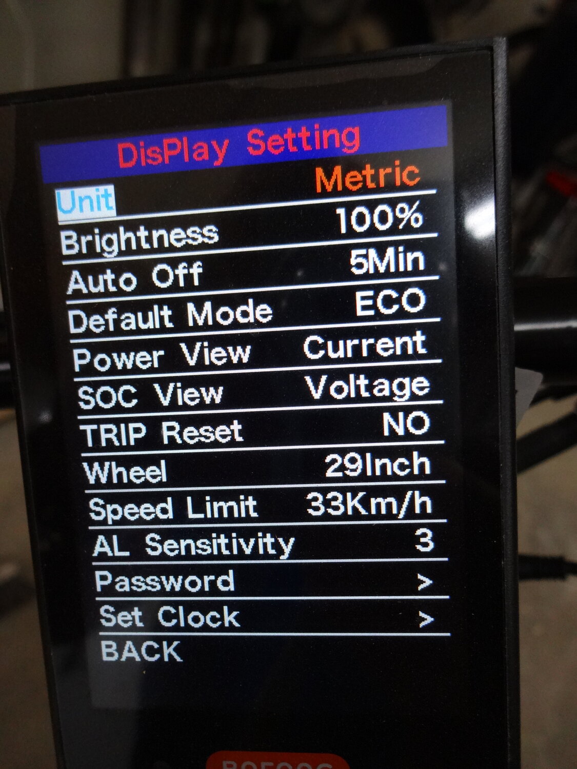

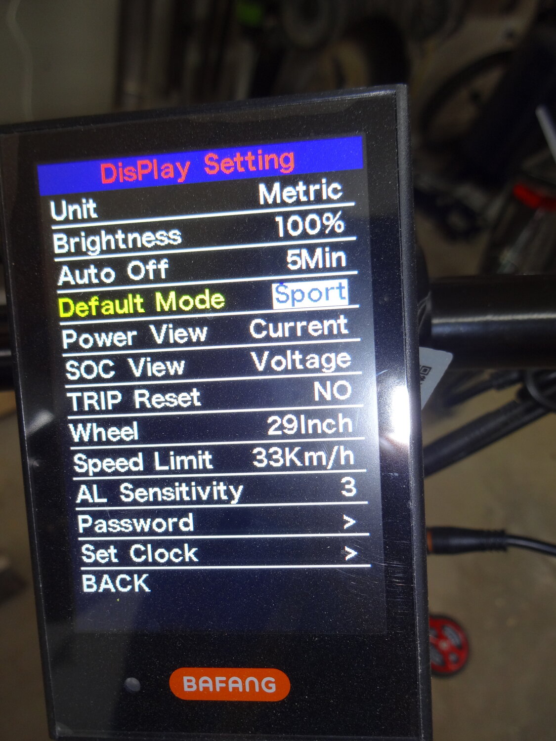

My DPC18 display does not give me the 5 or 9 PAS levels choice; instead, it only shows Eco or Sports instead of the PAS levels.
@laudouDo you have a copy of the manual you were provided? I found one with 0 and 5 PAS and eco or sports.
Just sellers keeping things interesting @Bobber I read the newest manual and it's as @laudou describes. Another BBSxx series nightmare, one model of display, and at least two firmware versions.

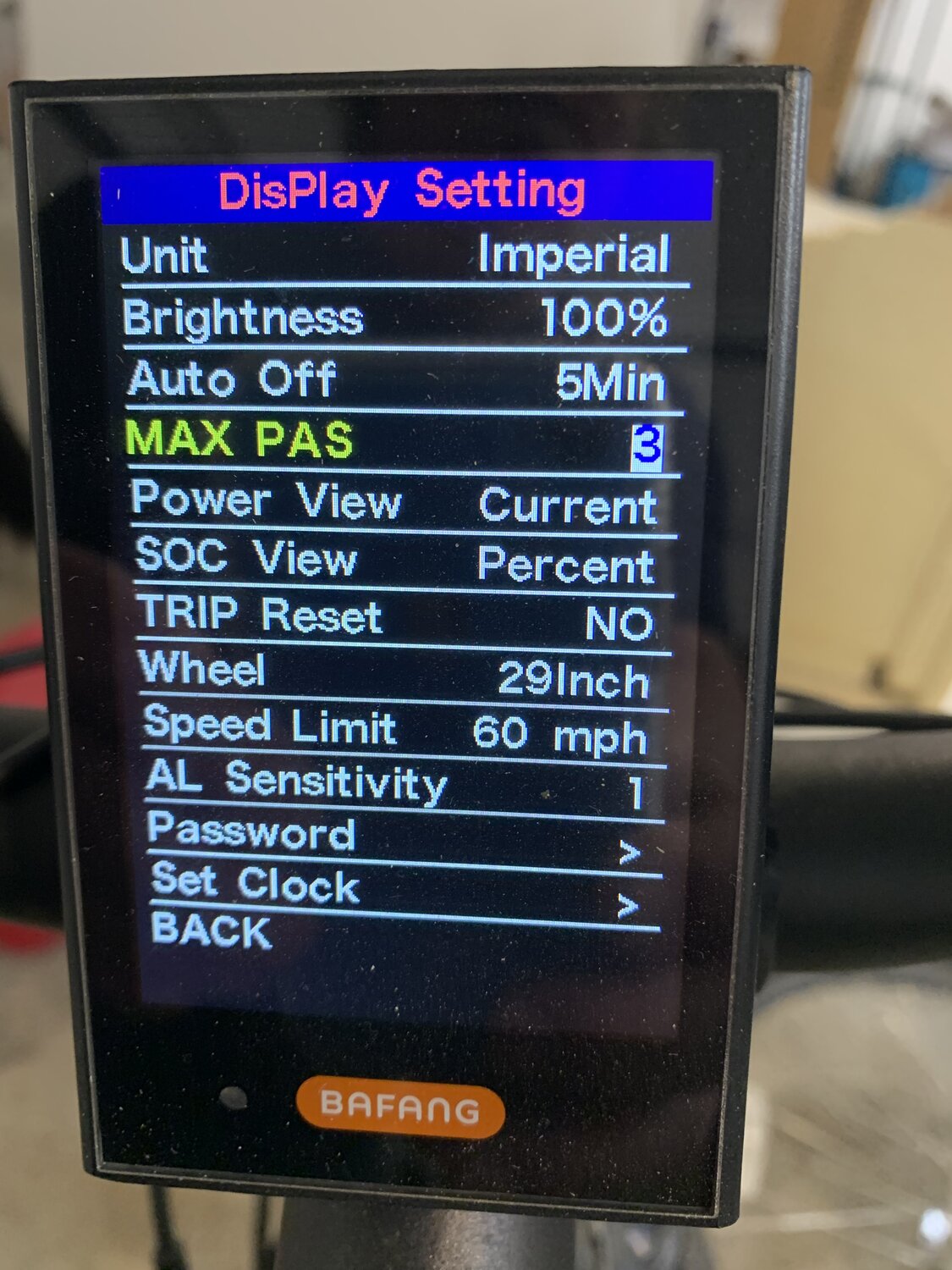

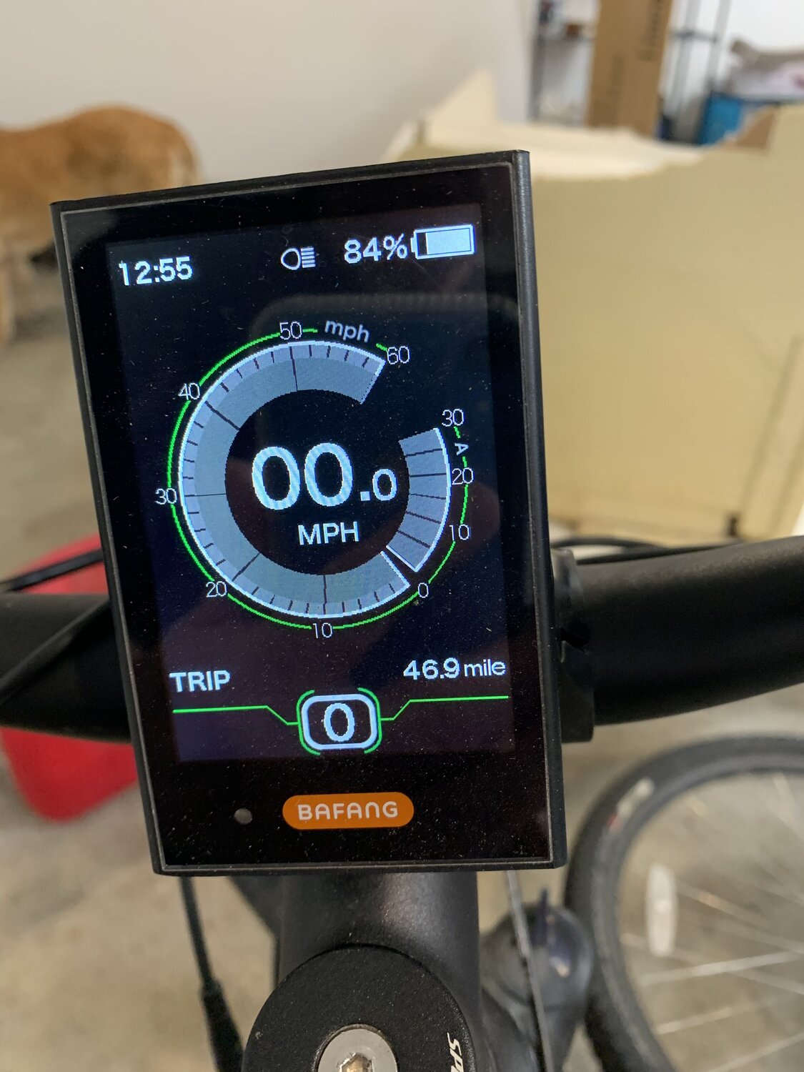

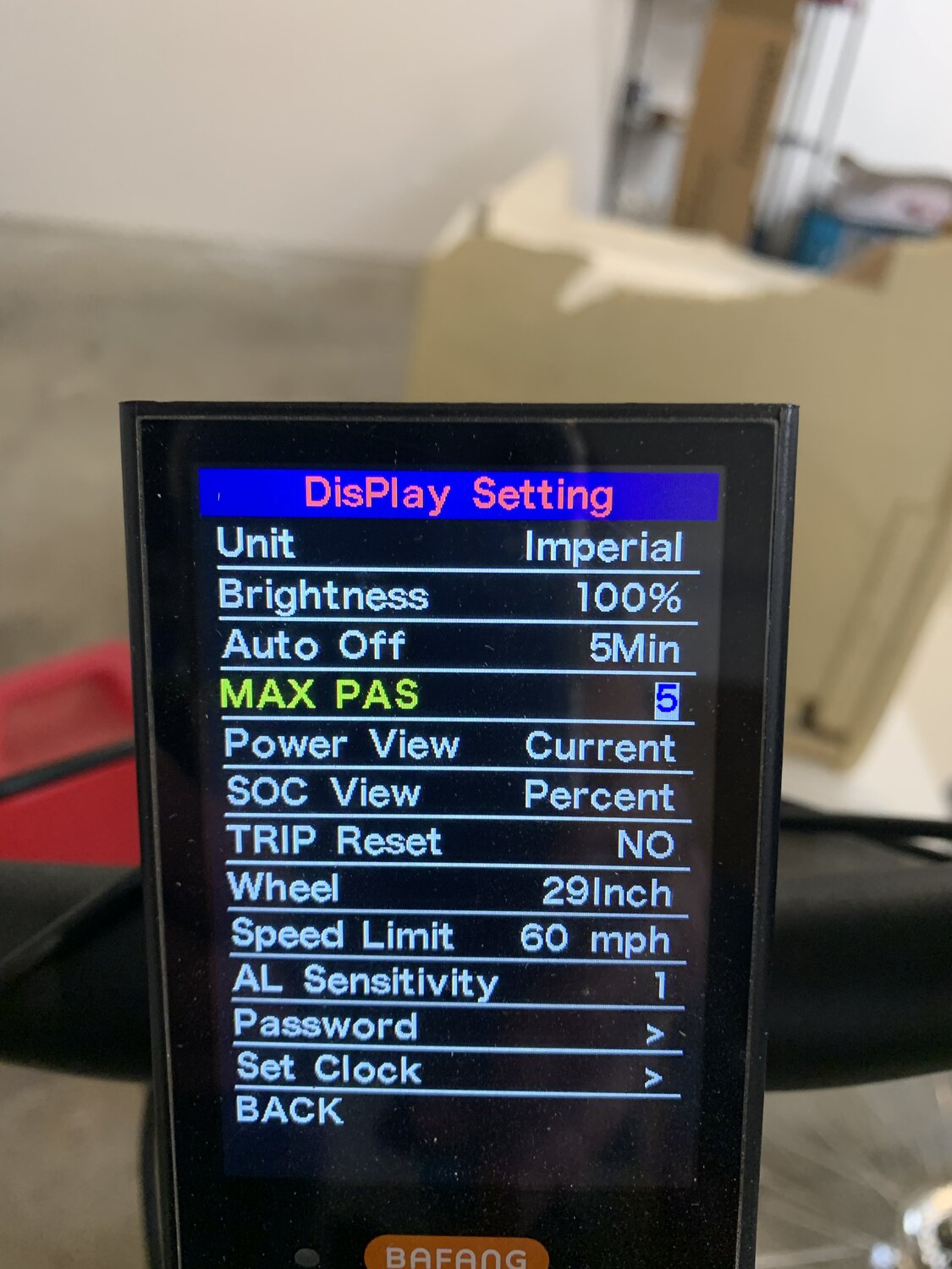

I can’t remember if I got a manual but do remember finding a YouTube how to. I just ran through my PAS right nowI forgot I had a 3. From turning on the bike to changing the PAS it’s 30 seconds or less. Here’s some pics. Where does it say eco/sport on yours?

Laudou, how old is your display? Also it’’s weird that yours has 2 default modes, seems like there ought to be only one.
