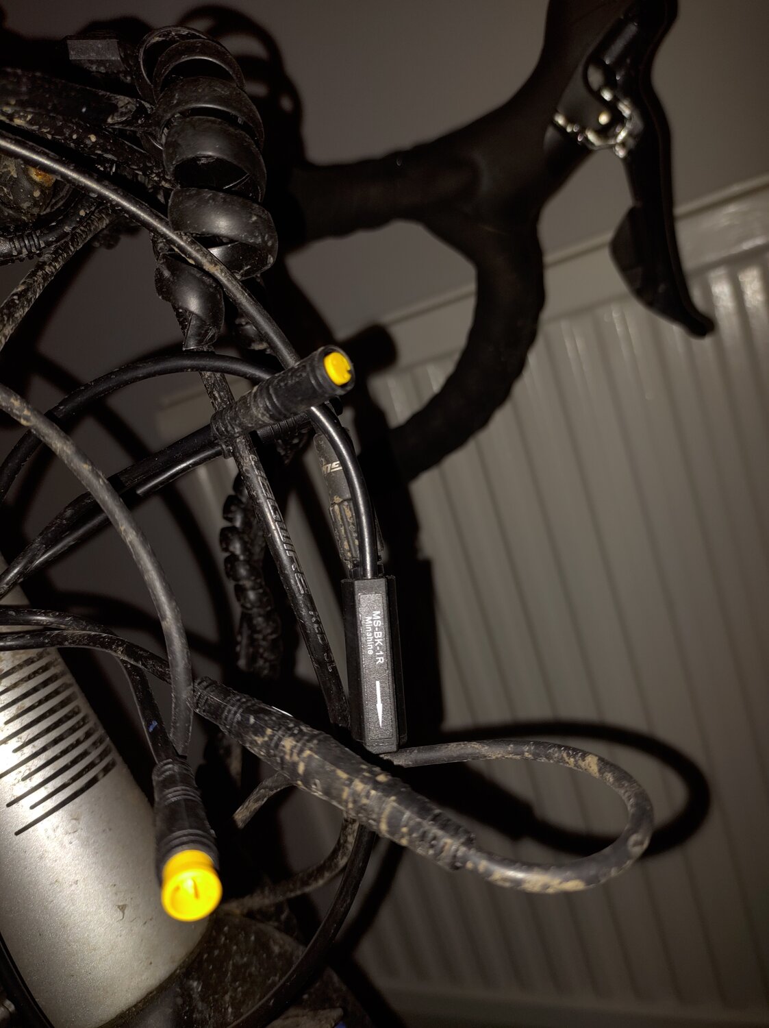

I've bought the gear and brake sensor on the gear sensor it has a arrow which direction should it be?
Google is your friend. Just Google, bafang gear sensor installation
I’m amazed by how easy it is to Google and get clear instructions for so many projects!
It doesn't mention which direction, if it even matters?
Ok fitted to one of the yellow connectors near the bars but red exclamation when it's in gear
Means sensor is in the wrong way?
