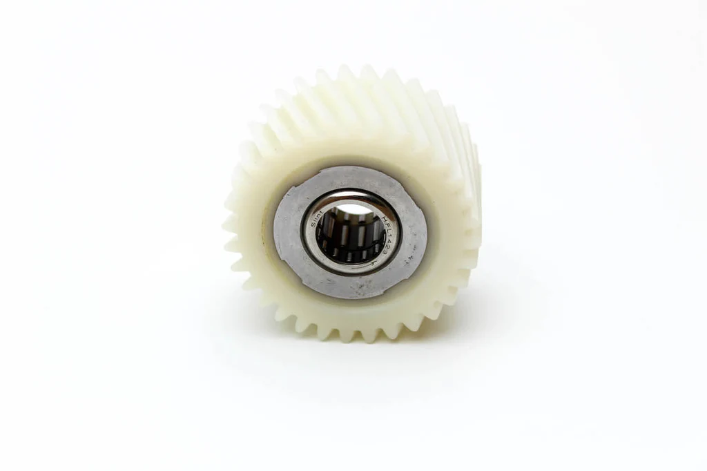

My Tongsheng has two one way bearings:
A sprag clutch that engages the axle to the main gear, if bafang is similar that one would be OK on your bike because it does spin the chainring and you have what you describe as resistance against the motor.
Another one way bearing that drives the reduction gear. That one is set into a nylon gear that meshes with the motor output shaft. That is the one which possibly is causing your problems (?)
This one way bearing is the one that prevents your pedaling from having to turn the motor, at least that is my impression.
This is the bafang version
Although it seems strange that it doesn't locked up at all when you turn your cranks on a stand, maybe just a defective gear/bearing that isn't aligned properly or just locks up when more force is applied. In any case it should be easy to remove and check, at least it is on the tongsheng where it is on the left side of the motor.
Cheap part.
But I'd check the entire gearing including the sprag clutch for function. I've had my Tongheng apart and if the bafang is similar it is a very simple process.
