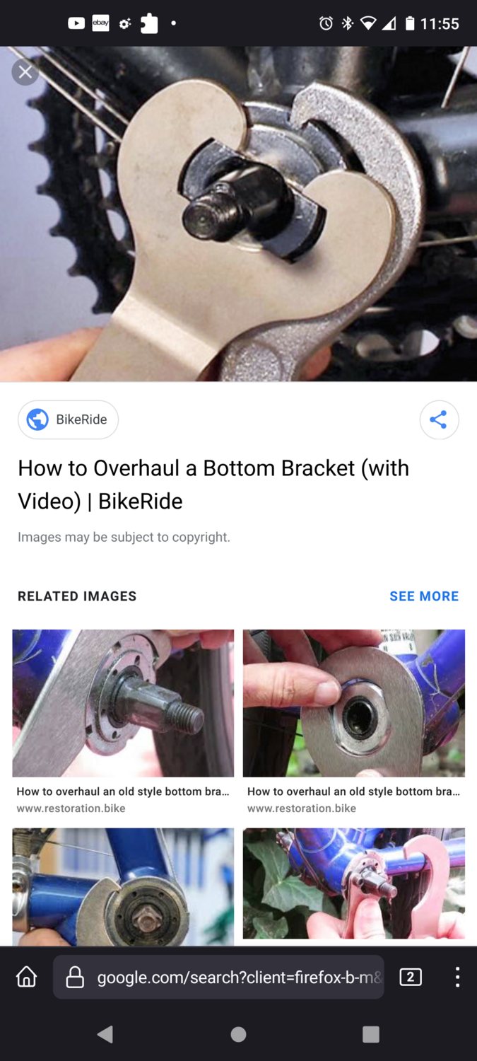

I think it could be the internal bearings that are too tight? I'll try loosening them (alot) then see if it's easy then tighten to right amount. Is the bafang tool unique or will a BMX freewheel tool work, they look similar, but is the bafang tool a bit smaller.

I'll try loosening those two parts within the first two mins of that video looks like locking ring

I've backed it off a little, I think it's improved it. I reckon compressing bearings too much.
Removed the outer cover then inner locking washer then loosened off inner a smidge then refitted outer locking and cover
No just no.
The inner locking pulls the shaft towards the non drive side, so if it's too much it'll squash bearings. Then the second locking tightens up against that.
Why is that any difference than this.

What's so funny Tom, you offered no help, I had suspicion those two internal locking washers are like old school bottom bracket, and headsets and I was right.
Toghtning up a tiny bit more made the crank harder to turn .
