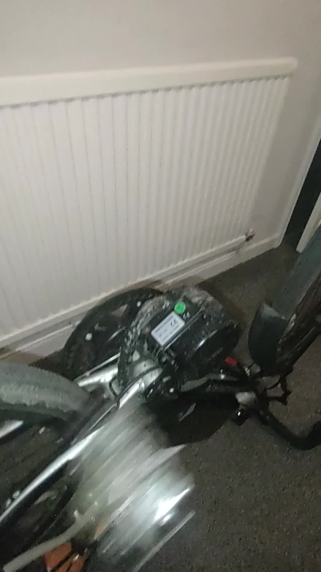

I've fitted a Bafang BBS02 e bike kit to a bike, with it switched off (battery went down to 15% 5 miles from home so I didn't want to continue using battery) there is a fair amount of resistance using it as a normal bike. It's fair amount, if feels like brake is partially applied, it's like a turbo trainer on lowish setting.
It was really hard work pedalling, especially up a hill. I've carried weight equal, if not more than the battery and motor and it was far easier than this.
The bike was fine before the conversion . Rotating cranks with the chain off feels ok. The front and rear wheels spin freely. It feels like you are turning something inside as not only resistance but some kind of gear meshing feeling/noise, it's not simply turning the crank and 100% power going into the chain.
Also with the Bafang it pulls away fine with the motor but after say 10mph it switches off, and only if I use a higher PAS setting does it keep assisting to a higher speed, so if feels a bit blippy in use. But then at a higher setting it is a bit too aggressive in speed, and it's probably too much battery drain. Computer shows mph fine. It's a new ebike kit.
Is this normal?

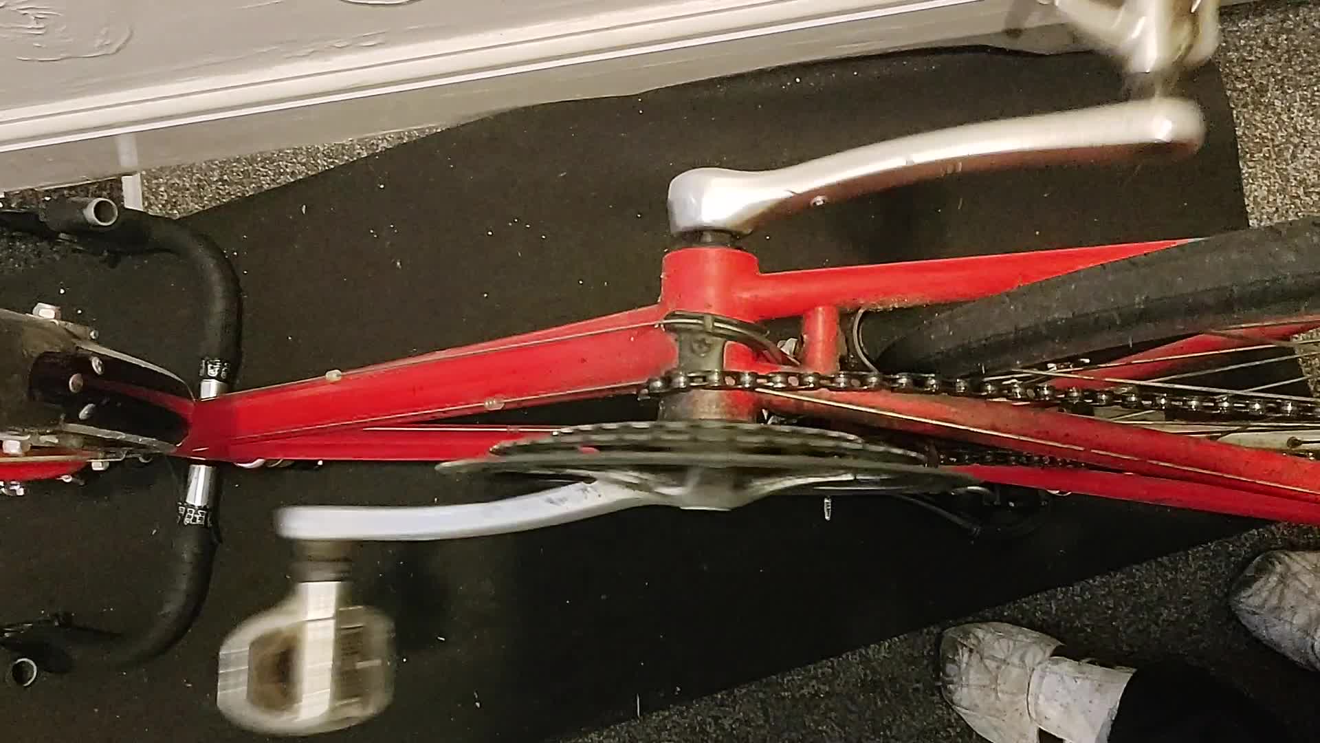

If I spin crank it rotates about one rotation compared to 10 on another regular bike
Resistance seems greater when actually riding.

I've taken a couple of videos.. uploading now. If the clutch is faulty woukdn't it mean when the motor is active the chainring will spin also?
You are on the wrong track with that comparison. There is WAY more drag on a mid drive in the scenario/comparison you are using. Still, that mid drive drag should be barely noticeable when you are out riding.
btw the friction doesn't seem to bad on the video but when riding it's much worse, it does literally feel like you are applying brake, going up a hill
That video is like mine. One+ turn in fwd pedal direction with no chain. No comparison with a normal BB which "spins forever." If power is on, spinning the pedal w/o chain still activates the cadence sensor, and the motor starts up.

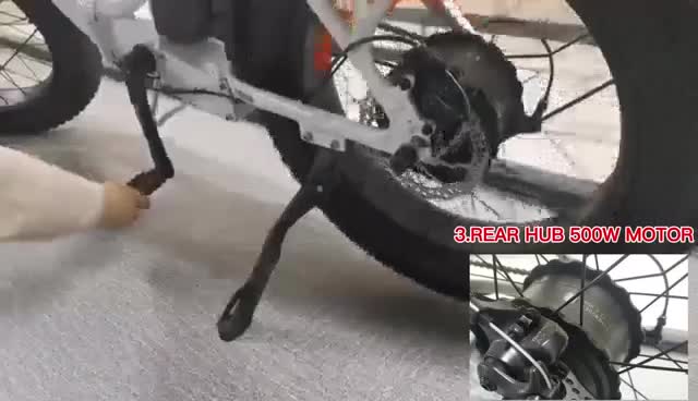

Being a bike tech, you should appreciate the difference in bearing designs and preload. If you went into this with the idea that this conversion was going to pedal and roll as easily as a conventional bike it's easy to see why you might be disappointed.
As far as the conversion's crank spinning, convert a conventional bike to the size and type of crank bearings necessary to handle the power of the conversion. Now add the drag of a clutch to that.
Re: brake sensor. That's kind of a safety issue don't you think? Your ace in the hole if something goes haywire?
Re: gear/shift sensor, if you've been riding a bike that requires you to shift for a while, to the point where you unload the stress on the gear train without thinking about it, then no. You don't need one.
The bearing of the regular bicycle is different from the bearing of the mid-drive motor.
here I took a small video of 3 kinds of motors, showing the speed of different bearings:
  • Bafang BBS02B 750w mid-drive motor;
  • Bafang New M625 1000w mid-drive motor;
  • Regular e-bike with rear 500w hub motor.
The bearing smoothness of the hub motor is a little better than that of the mid-drive motor,
but it's only a little bit, far less smooth than ordinary bicycle bearings.
