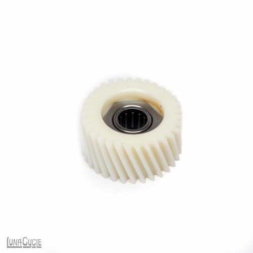

The nylon gears in the motor could have gotten too hot. They sell replacements.

They have plastic gears in the mid drive motor? I knew they did in the geared hub motor, but I've never seen the inside of the mid drive. Maybe some new grease if they do have gears. But what do I know, I had to Google "denivellation"
YEs, nylon gear… Hence the engine works like normally, maybe you're right , only grease (which had probably melted) would do the trick! But if I open the motor to grease, why not replace the nylon gear in the same time? Hummm….

I have a BBS01 as well. Love it for how quiet it is and no problems since I purchased a few years ago but I'm not a power user. You should be able to replace the gear for not much money, assuming it's the reduction gear that is failing.

that being said the plastic gears are our slowest selling replacement part. I still have 2014 versions in my parts bin, unused.

You’d have to be riding it like a single speed to melt the gear.

thomas Jaszewski, your replacement parts like version 2014 would be of no help for me because my mid engine is a bbs01b, that means the nylon gear is a version that comes after 2014.

I only mentioned it since my 2014 never needed a replacement. We sell the only BBS02 gear available for BBS02B or BBS01B. I only broached the subject because of it being a relatively rare part to fail. Typically noisy motors are in need of lubricant. If not rider daily with noise will have bum bearings or clutch.
