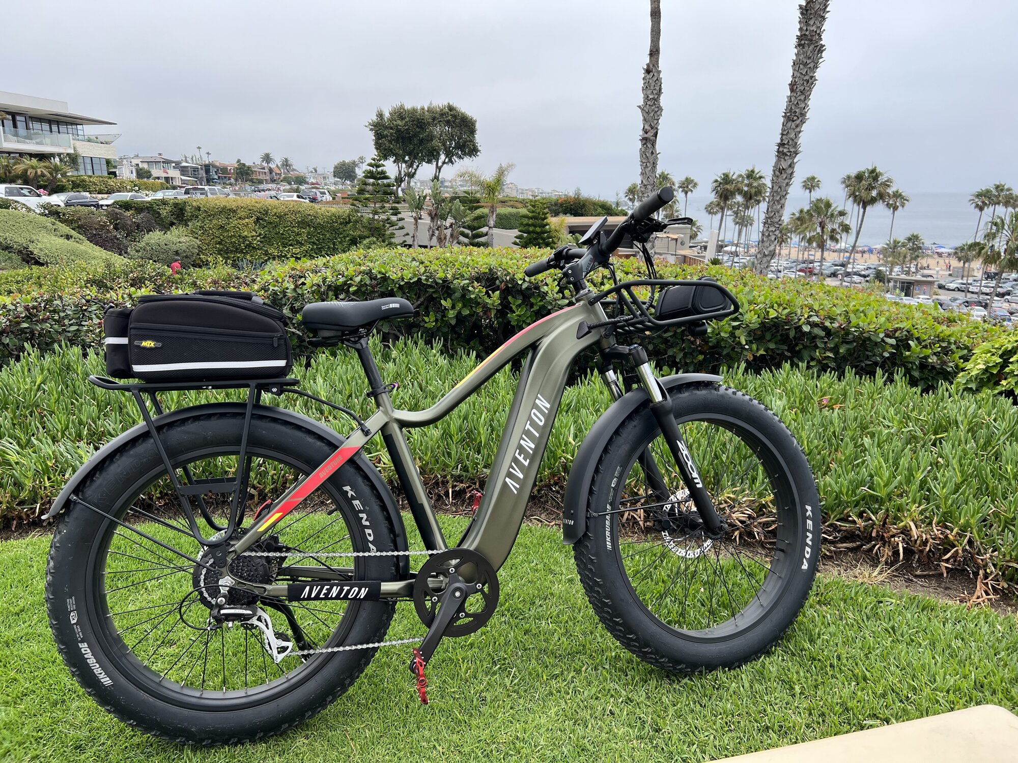

I appreciate the input on the quality of the Aventure, but all I do is ride it on the street with the wife, from home to the beach. I use it as a beach cruiser basically and was wondering if it's worth the $300 upgrade.
