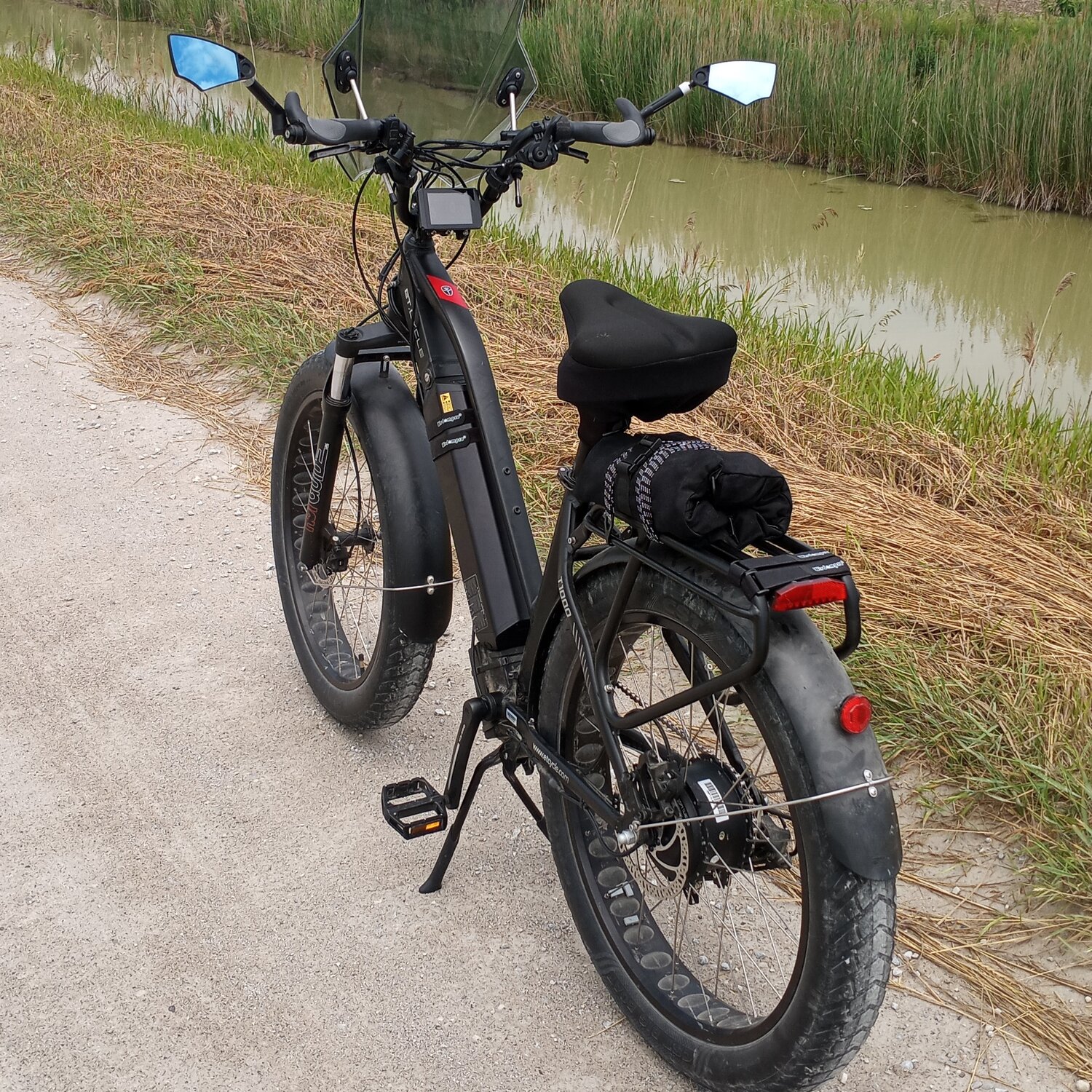

Hello everyone. So I have an aventure 2. I just replaced the rear tire for the first time and now I can't seem to take a ride without getting a flat. I live in the southwest and I use Thorn resistant tubes with slime.I have began to wonder if the original tires are rated for weight much like a Harley tire. I am unable to find original tires from China. Has anyone else had a similar issue ?

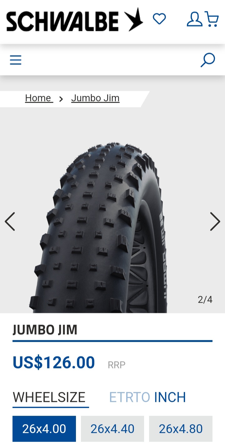

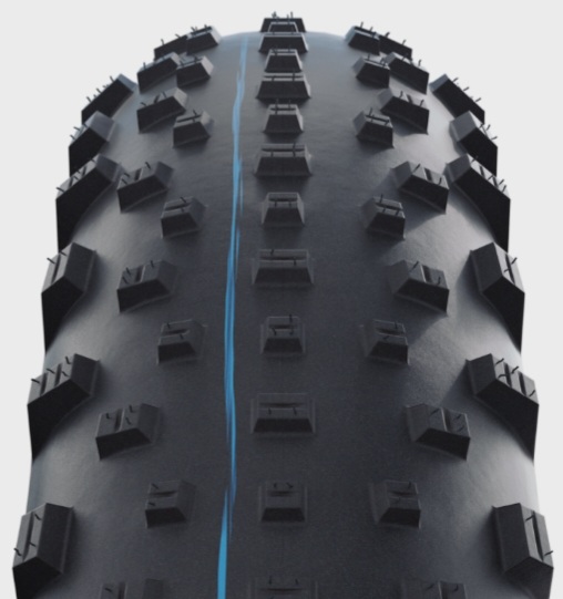

Yes, Jumbo Jims.

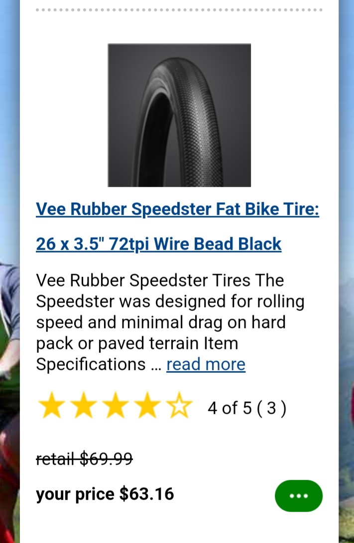

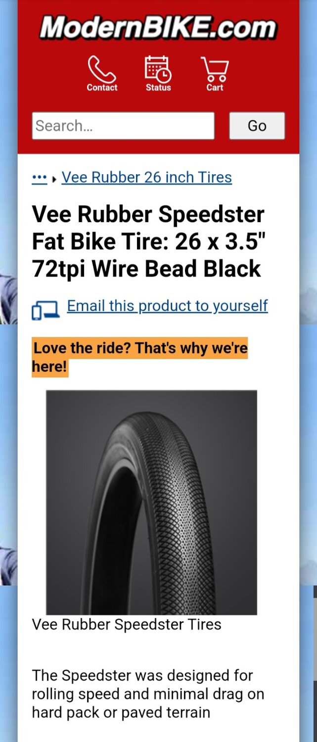

I don't like the tread pattern on the Jumbo Jim's,..
I want street tires but I can't find my original tires anywhere.
I'm going to get these for my next tire.
They are only 3.5" but they apparently fit my rims,..
(I'll have to recalibrate my speedometer. )
So that's $63 times 2 plus converting to CAD, plus shipping, plus duty,..
So hopefully less than $500 at the door. 😂

I would gladly spend the money for Schwalbe tires, but there is nothing in my size available with a street type tread. (26"X4.00")
