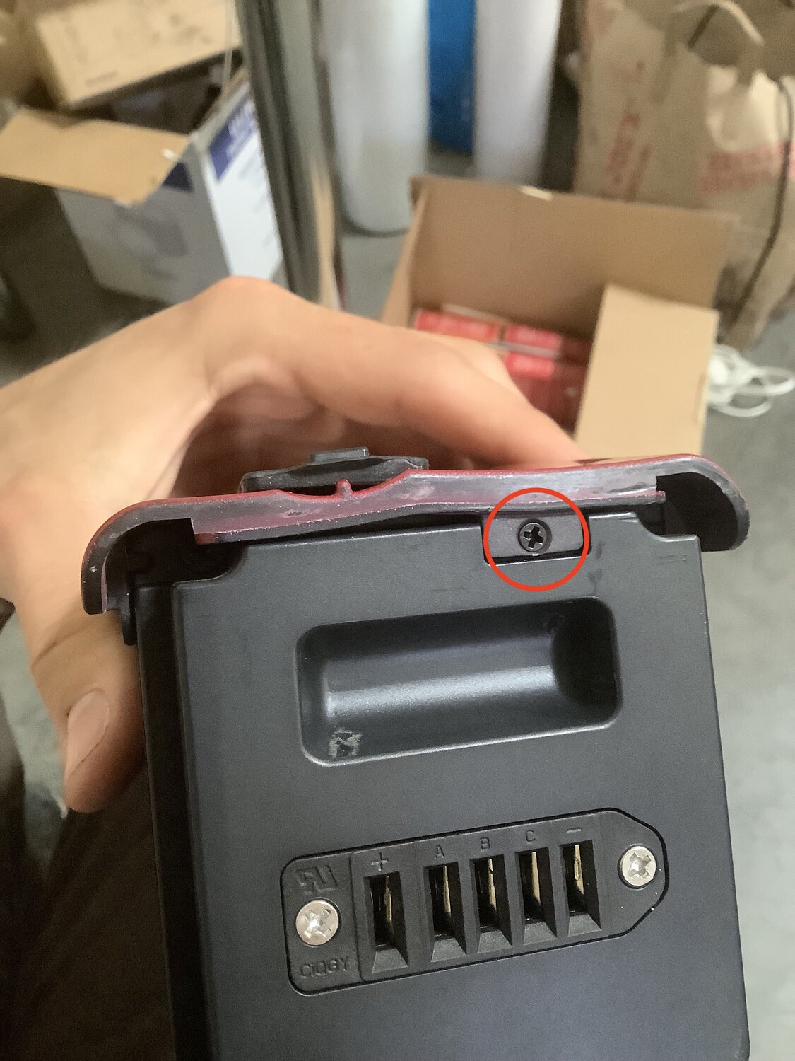

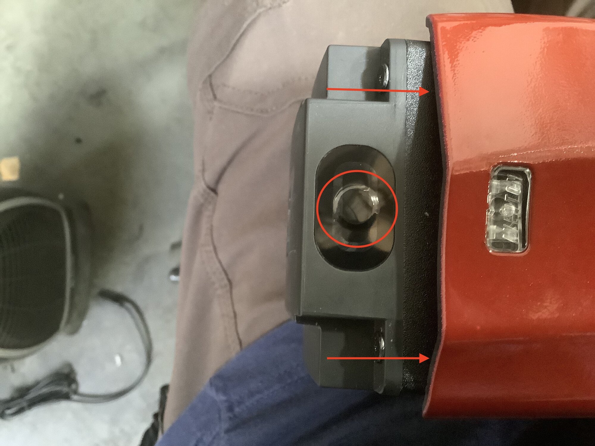

There's no mention of that in the manual. Each battery is a little different. The button you press acts a as a kind of rocker to engage a sealed button directly beneath it. If the visible button in not perfectly aligned, it may take a couple of attempts. If it takes more than that, or if you have to hold the button down, then it's time to worry. That's what was occurring with my faulty battery. To ease your concerns, remove the battery, then slide the outer shell from it by removing one small screw. Then test the actual On Button. See attached images. Let me know what happens.

Would love to know the single cover screw size...I have lost mine!
David, I replied to you on Youtube as well. I don't know the size and have no way of accurately measuring one. However, the cover is very tight once it's slid onto the battery housing and will be held in place by the frame of the bike once inserted into the battery compartment. I wouldn't worry about it. I sincerely believe it will not slide off.
Very cool and thanks for the candid and quick response..I just heard back from Aventon that the lone screw is a #4 x 40 screw
