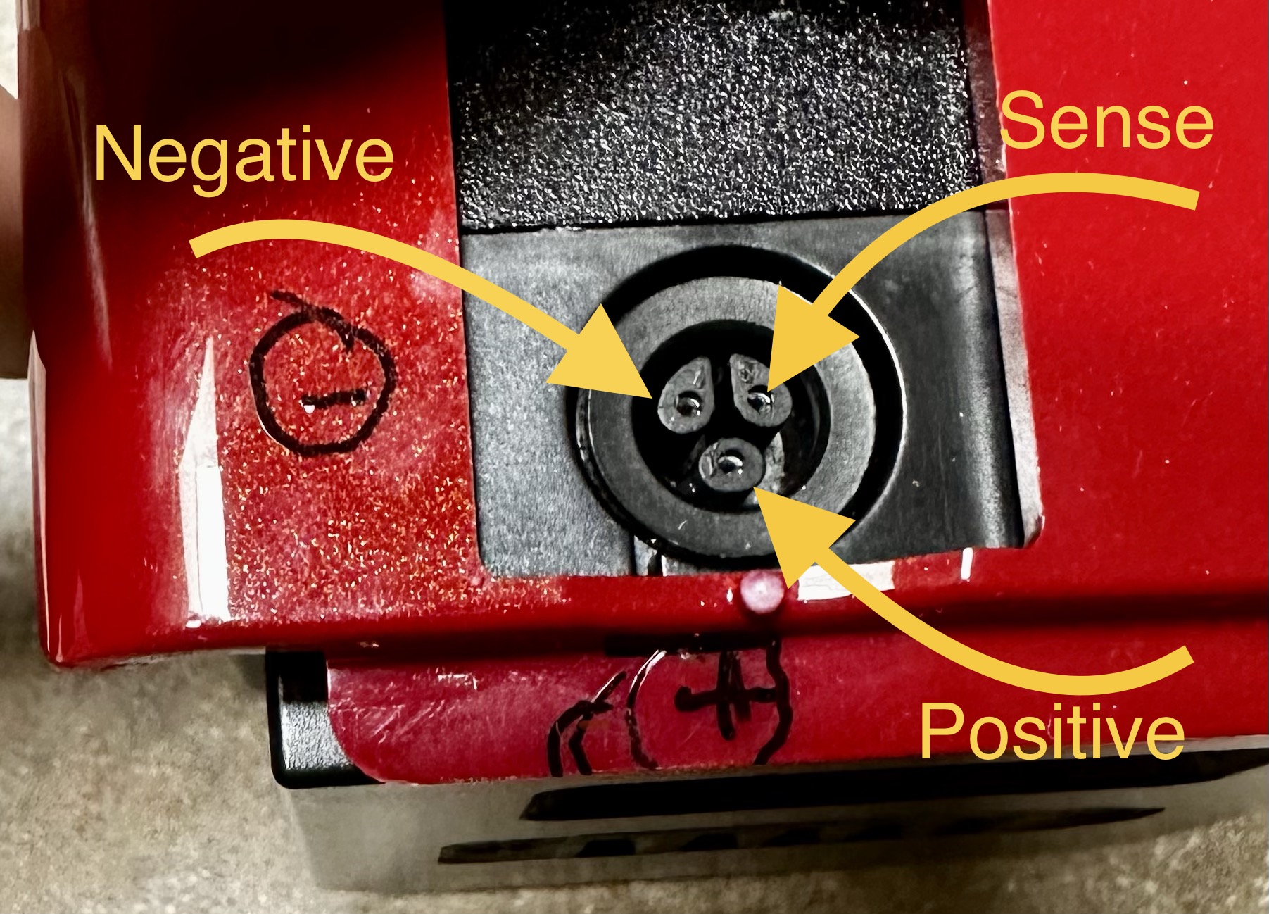

This is the pin-out for the Aventon Aventure battery charging port. The sense wire measured 2.44v; not sure how it is used.
However, connecting the Grin Satiator charger to the positive and negative then holding the Satiator’s button to Force charging works perfectly fine. For testing I used alligator jumper wires to paper clips that were inserted into the charging port terminals and it charged perfectly. In the future I will probable chop off the connector from the Aventon charger and terminate it with male and female automotive weatherproof quick connectors so I can plug it into either the Satiator or Aventon charger.
