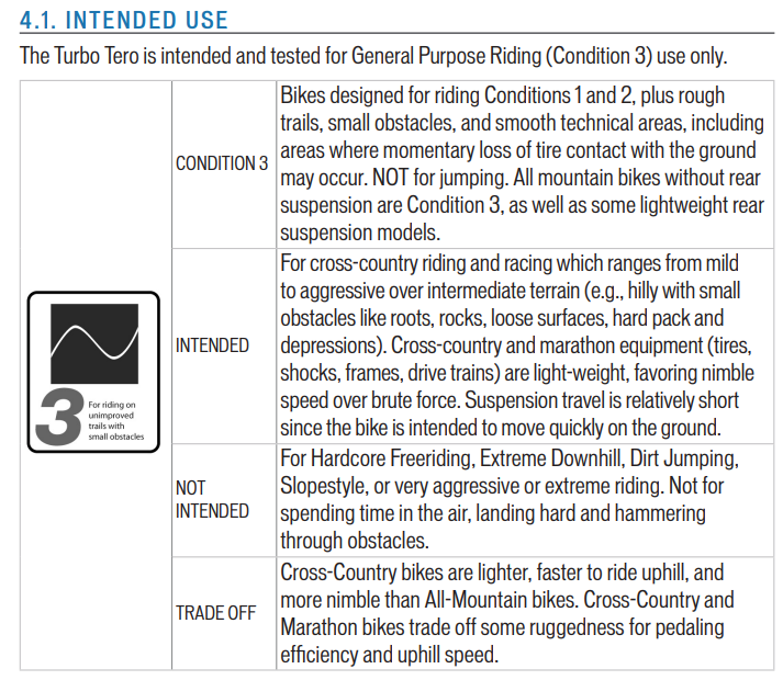

On a commuter bike? LOL I see a frame warranty denial in the OP's future.
Oh no, it technically is an equipped XC e-bike.

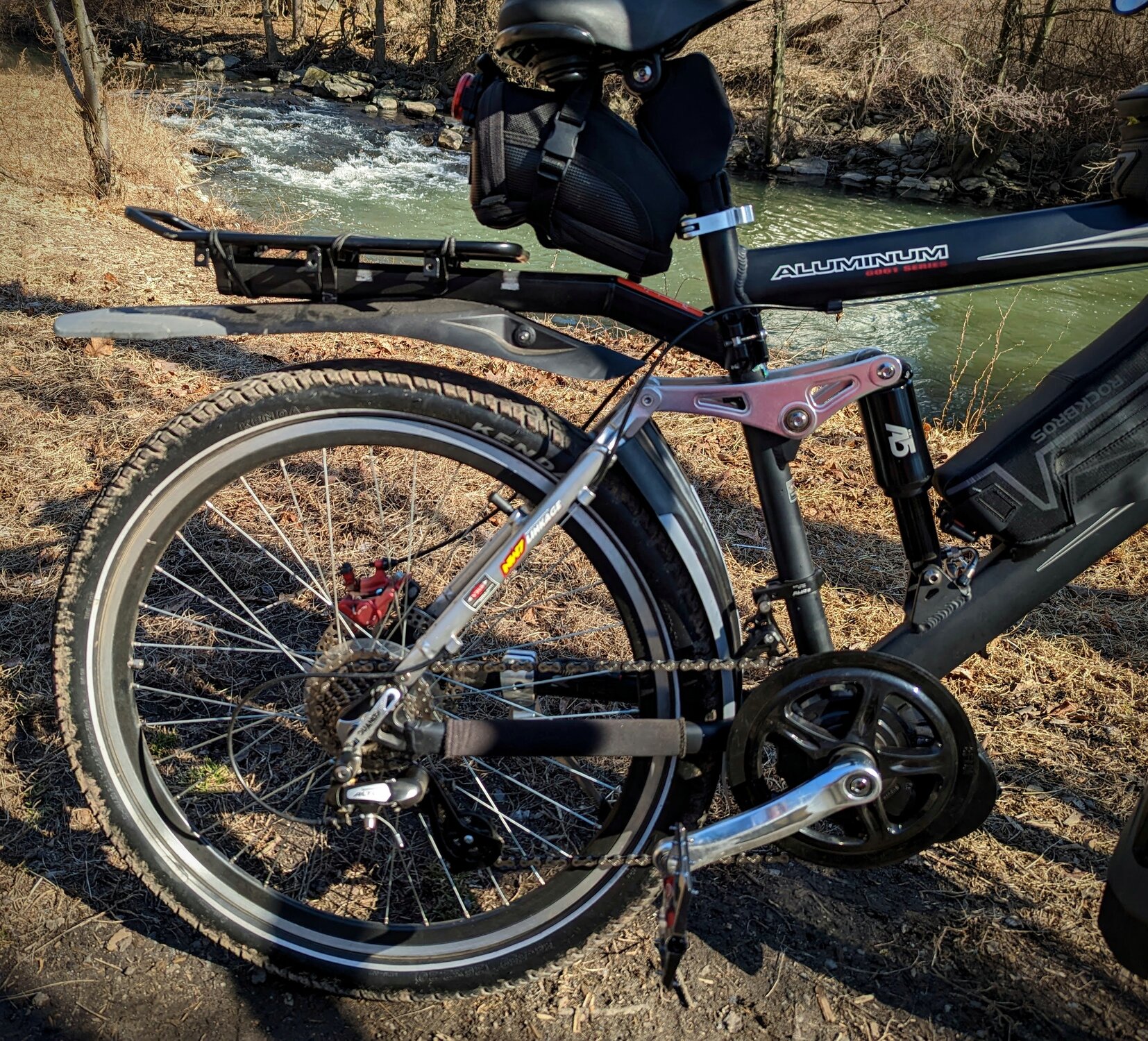

I recently made a custom one for other reasons but if you are handy it is doable.
I mounted a seatpost style fender to the bottom of a seatpost mounted rack. I had to cut out the top of the fender to get it to sit properly to the bottom of the rack main support. Additionally I wanted a slightly larger rack then original and the bent up top section that typically sits forward to be in the rear to give clearance to my under seat tool pouch so I used the top portion of a different rack and mounted it to the main support flipped 180°
You probably won't need to do any of that.
I've been riding with it for a while to be sure it clears with the rear suspension and all is good so come nicer weather I'll remove it, fine tune some details and paint it proper.
I don't have to proper paint booth and hate painting indoors

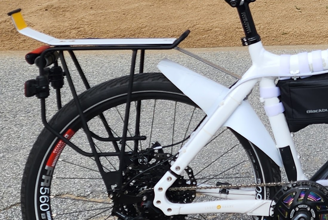

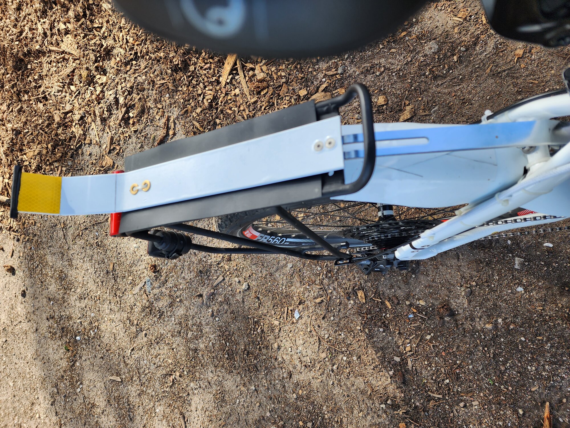

This one works although, as a new bike build, its not quite finished yet. The bit of aluminum deck keeps water spray from coming up and forward from 9 o'clock upward a bit. The fender handles the rest of the spray coming up off the top, as well as the spray coming off the tire as it travels downward (I need to extend it a couple of inches on both sides).
The rack deck is broadened with a cut bit of flexible plastic (flexible cutting board sold on Amazon). You could do the job of the alloy bar by just extending that plastic a few inches off the back but I also use that bobtail as a place to stick a big piece of prismatic red street sign tape to help me not get flattened by overtaking traffic. You can see how I extended that rear mudguard with white Gorilla tape. That is a Mucky Nuts Fat Face Fender, reversed and used on the rear instead of the front. Mucky Nuts sells the white ones for a steep discount on clearance at their site. I usually paint them black but since this bike was white...
A short front wheel mudguard coupled to a body fender on the downtube will keep water and mud off of you completely. Again maybe extend that mudguard front and rear with a bit of gorilla tape.
End result is complete water protection for the rider - from wheelspray at least - without the rattle of fenders or the grinding of rocks and mud inside of them.

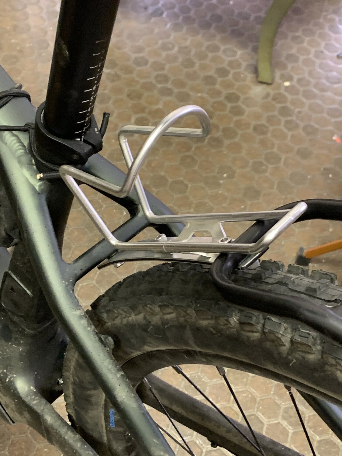

I ditched the front and rear fenders (didn’t realize how heavy they were after removal..lol) on my Canyon Pathlite ON.
The rear fender provided for-aft support for the rear rack so I fabricated a support arm out of aluminum bar stock for the rack… and mounted a bottle cage on the support arm.
The rack stays on permanently as I do a lot of overnight, off road bikepacking.
