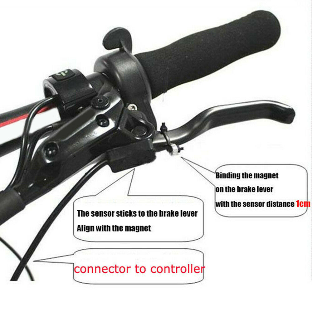

You can buy universal ebrake switches that you attach to your exiting brake levers. Theses are $8.99:
Interesting. That may be what I am looking for!
Great price when it gets delivered in November. eBay gone Aliexpress!
