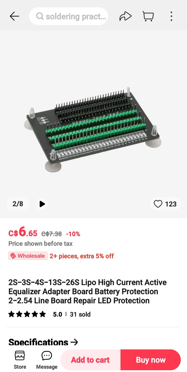

You can leave your battery charging for a Really long time and if that doesn't work, you can buy this stuff and open up your battery to check and charge each cell group.
You don't even need a voltmeter.
There is one built into the power supply.
You only need to know what you're doing.
