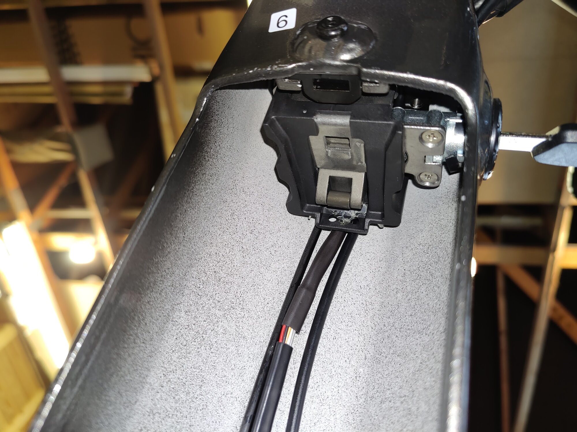

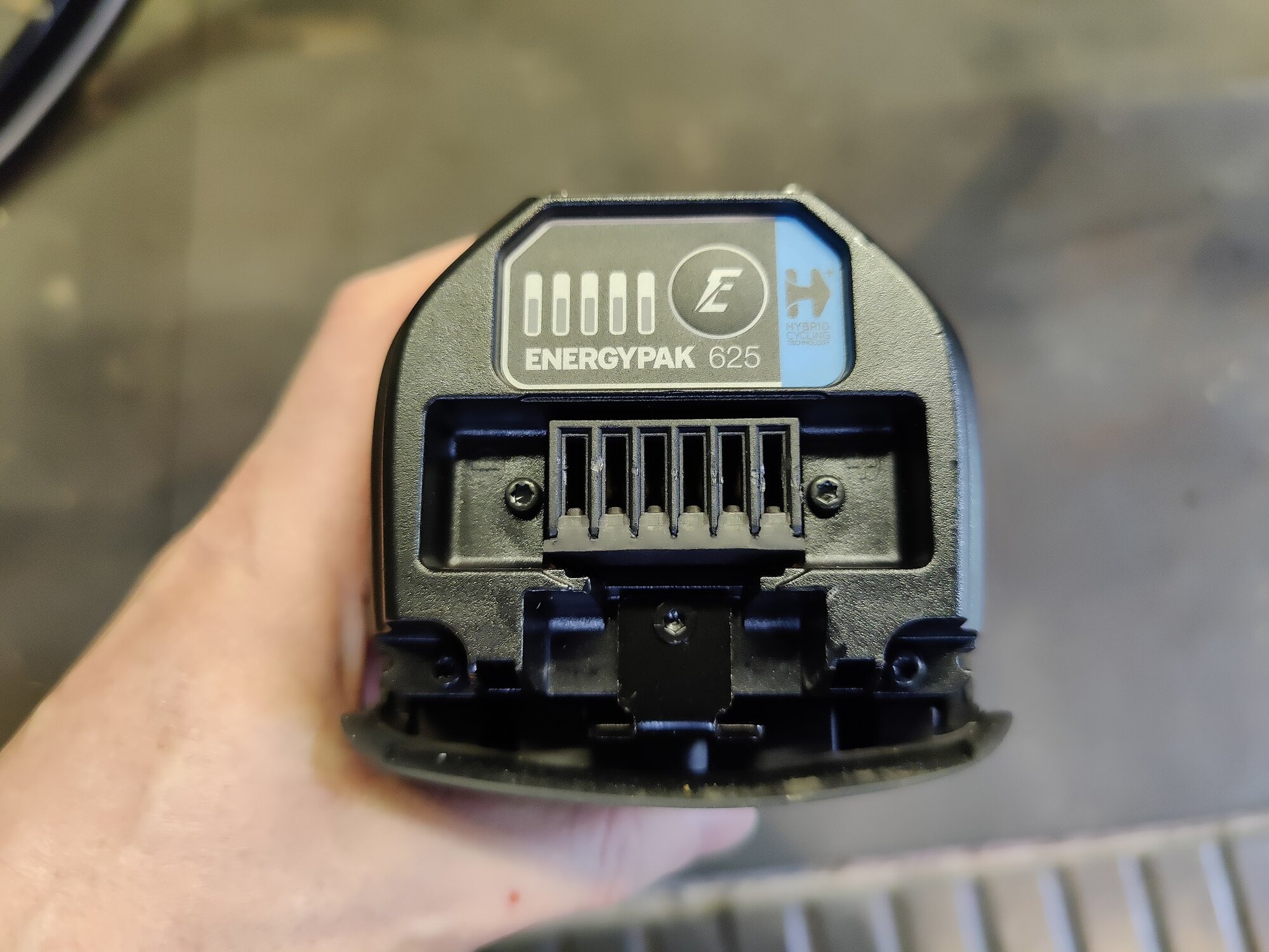

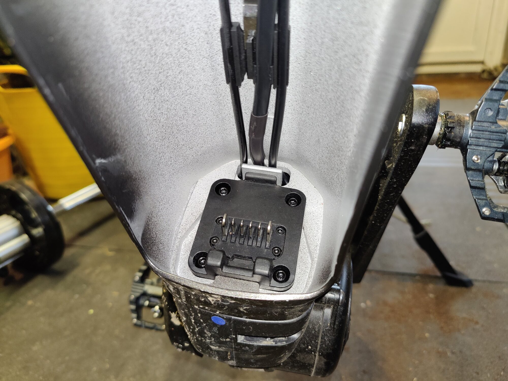

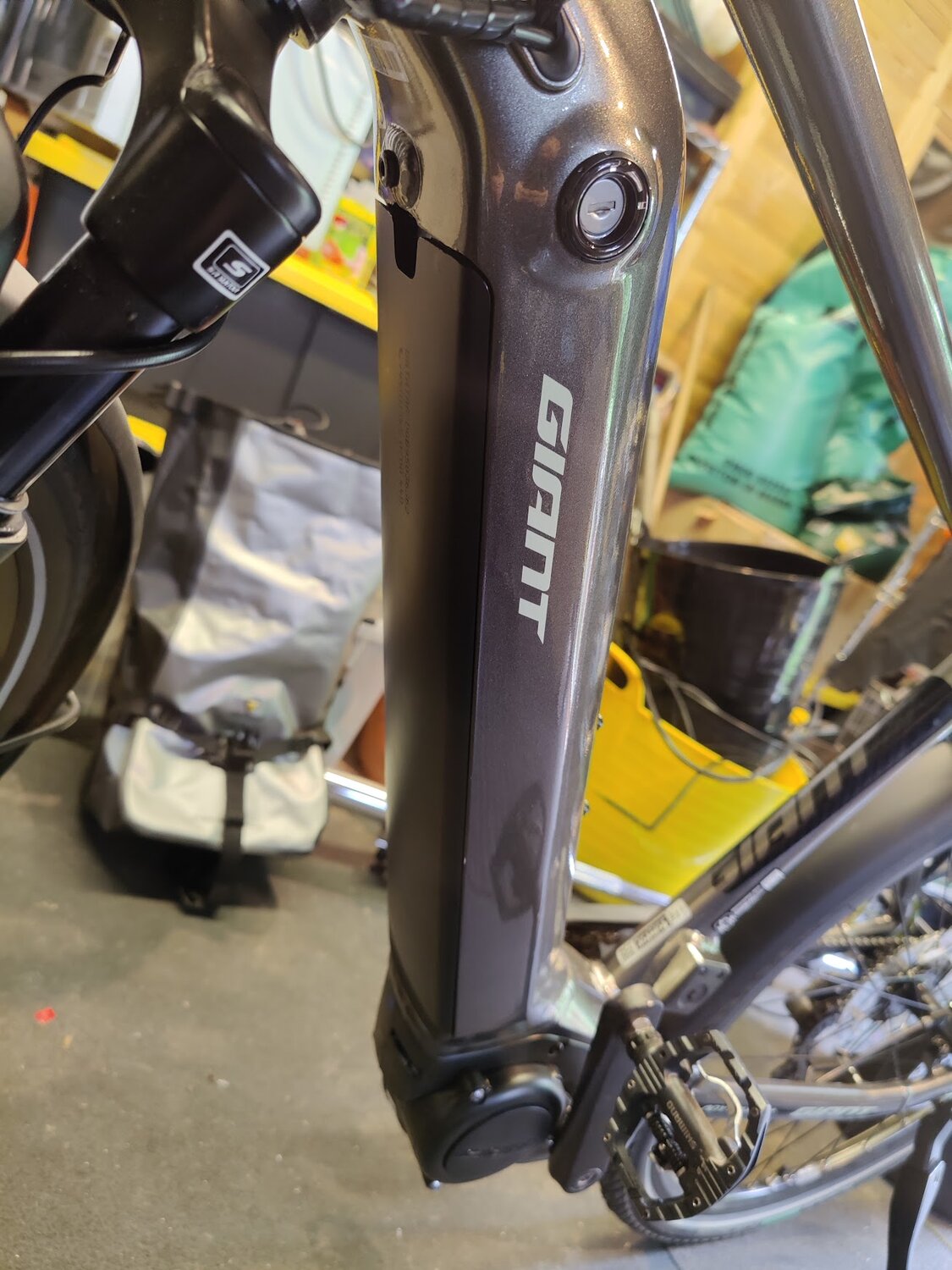

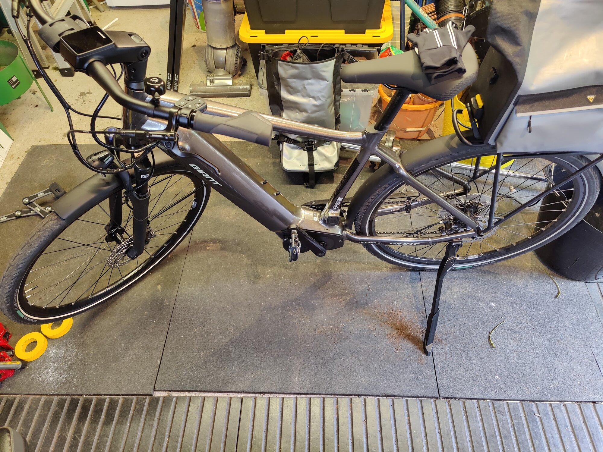

Someone posted asking to see pictures of the bike and battery (but has now disappeared?)
Anyway a few below

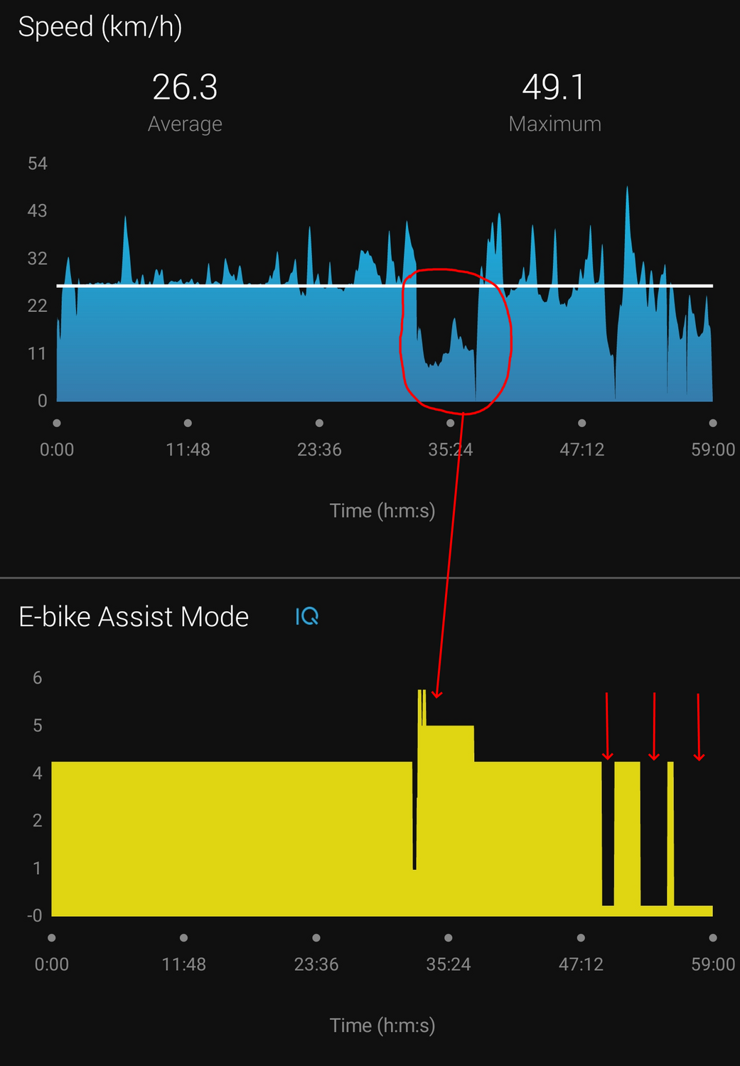

This was yesterdays ride with data from my Garmin, first time it went off then came back on but was not providing any assist even after turning it up. Had to stop, turn it off and then it came back on properly again for a while, then later went off 3 more times.

Hi Shermo, welcome to the forum. You will find several people discussing similar problems, especially in the "Known Issues & Problems with Giant Products + Help, Solutions & Fixes" thread. People talk about shims to raise the battery contacts, dielectric grease and even Giant replacements. I have experienced (very) occasional intermittent issues in 18 months of ownership and about 8,000km of use. Usually switching off and switching on again is enough to resolve. If not then removing the battery and replacing often works. The most I have had to resort to is spraying contact cleaner on the terminals but I think others obviously have bigger problems with it. Best of luck!
Motor overheat perhaps? Did you ride in the maximum assistance level? (Just guessing).
Generally I've just stuck with Auto mode, the last ride it cut out the first time on a slight decline when I was doing 20mph or so, so no assist at that point.
I decided to just get it replaced, I didn't spend 3x the price of my road bike to have an ebike I cannot rely on.
