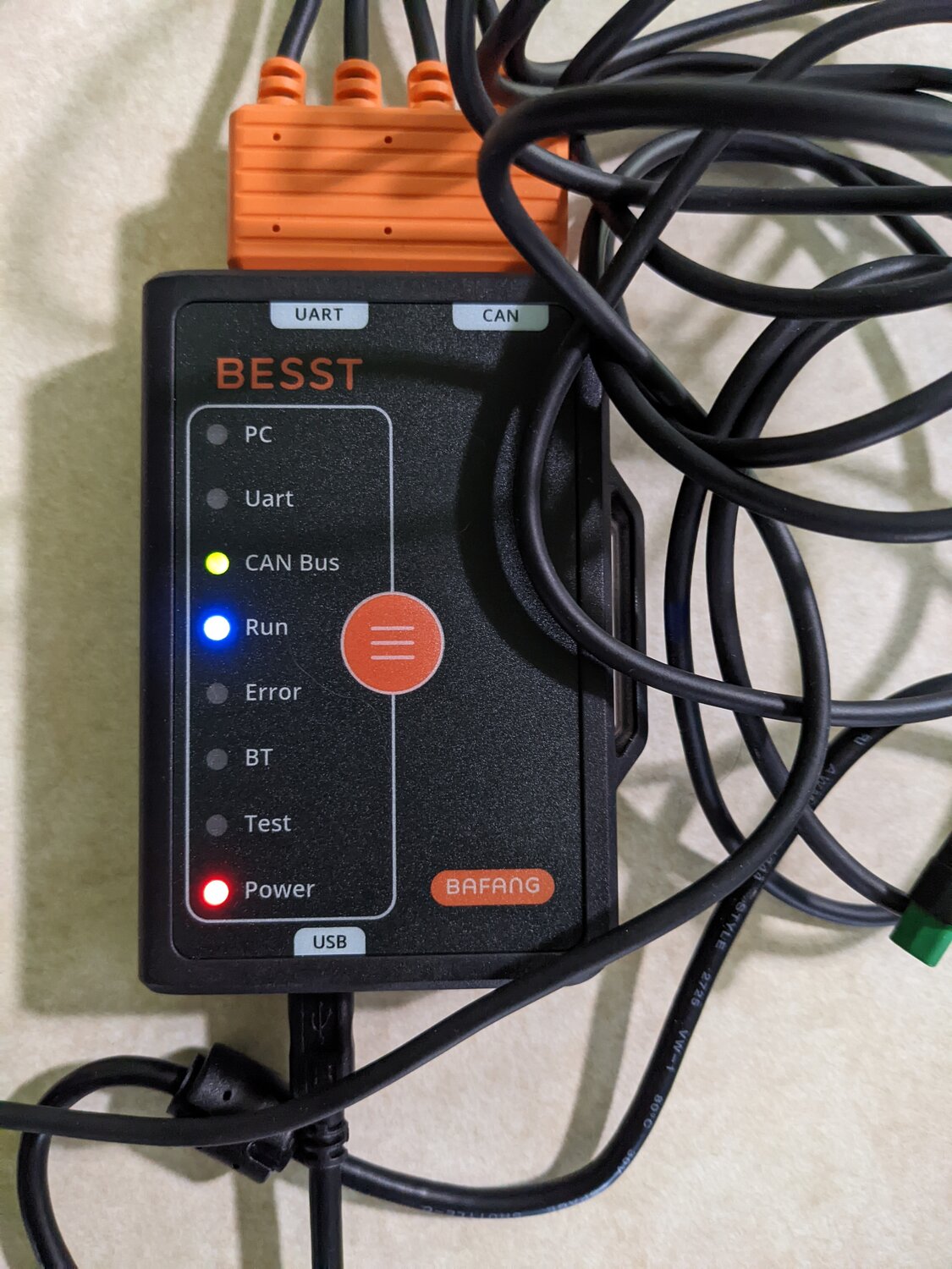

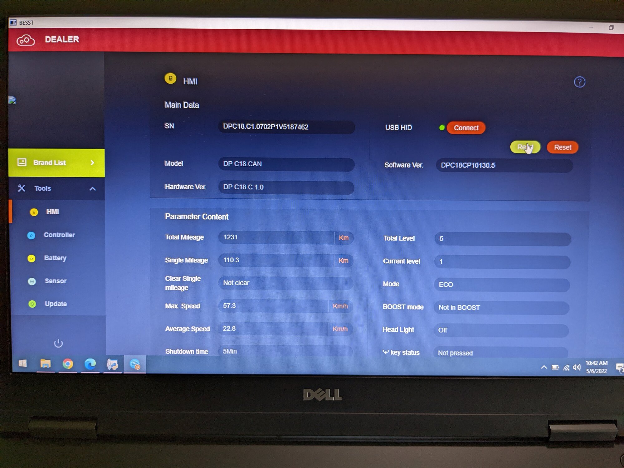

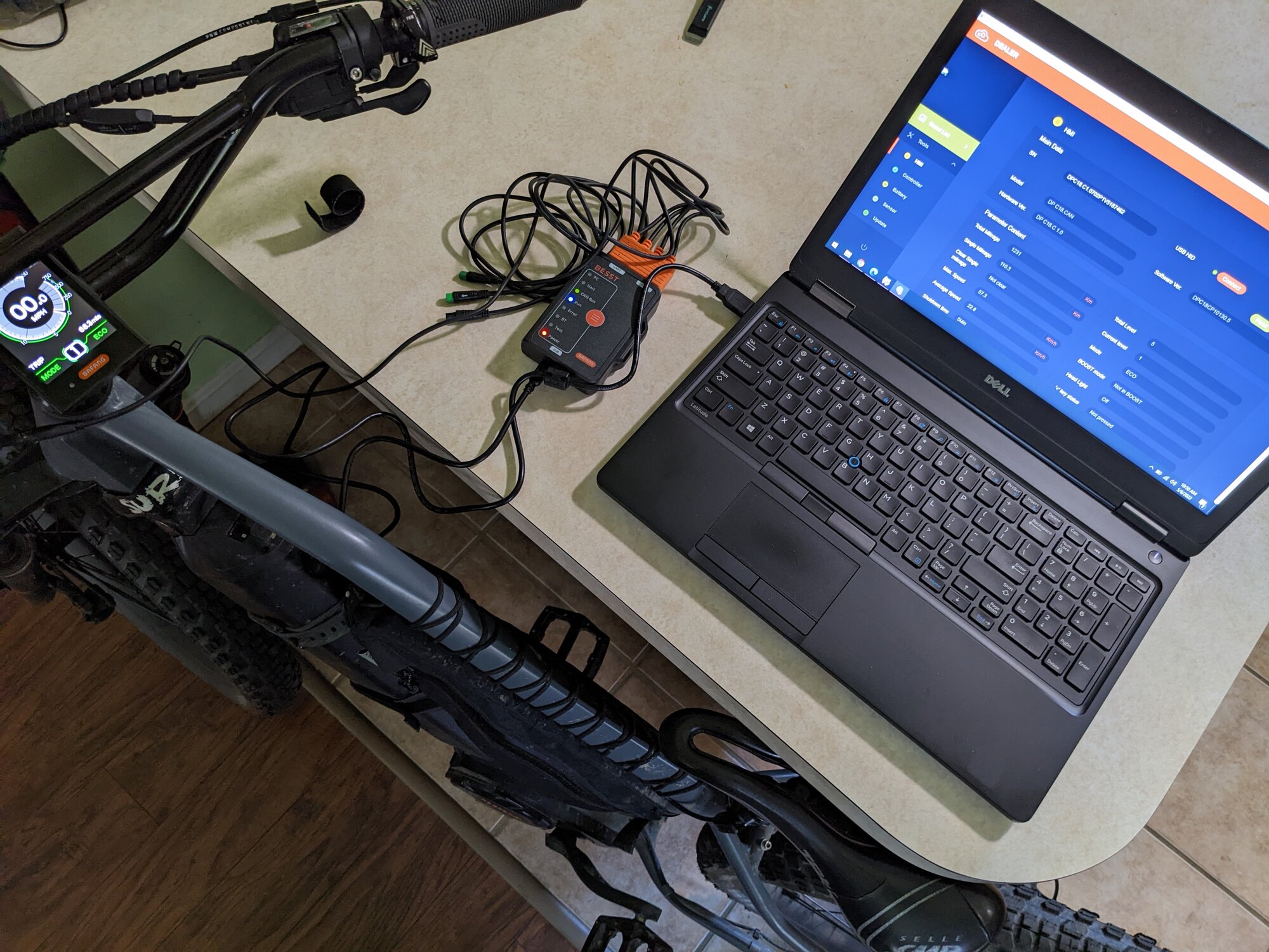

I can(bus) now at least read the canbus protocol. I was able to install the BESST software, hook up the BESST tool and get a live read from the display. I'm still having trouble reading the controller, but I've watched a troubleshooting video about that somewheres on the youtubes and will be playing more with this in the coming weeks. Very excited to at least have a working canbus connection at the moment. Now if I could just get my hands on a stock firmware file as a failsafe I'd feel much better about playing around with it. (Don't tell my wife I had the bike in the kitchen)
