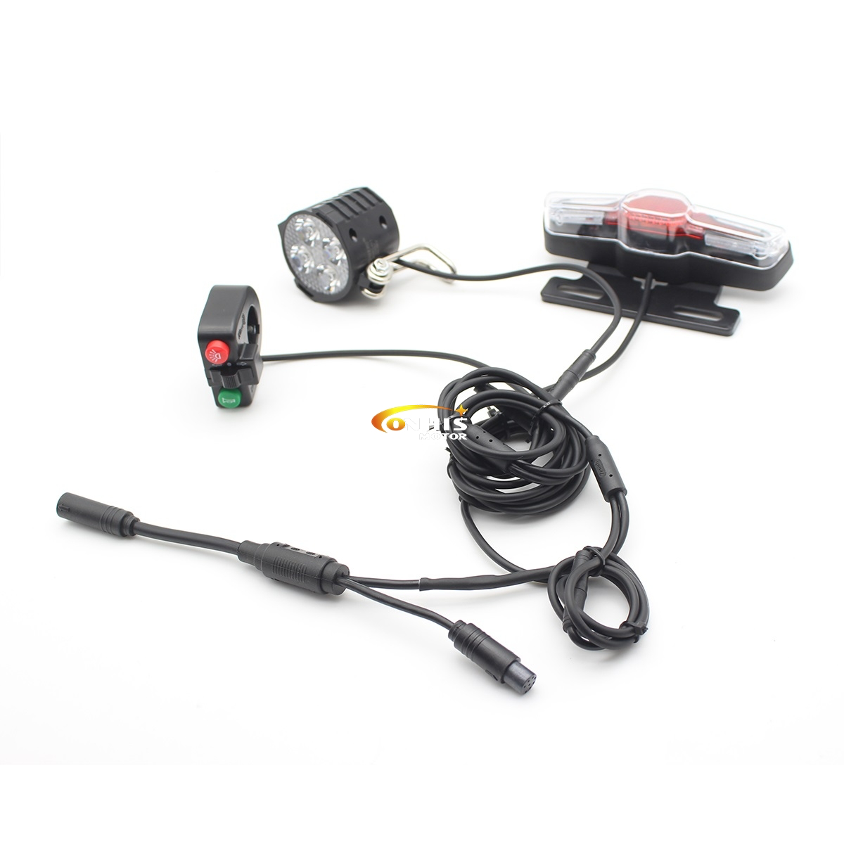

Anyone using this Bafang light kit? BBSHD BBS02
Wow, I like that Thomas. Love the fact it's got a built in brake light and tee's off the 1/4 harness. That makes for a clean install that couldn't be much simpler. Would be a nice DIY project for a rainy day.

I wonder how it's tapping current... The 1 to 4 cable is all low current control. Displays with a USB port is rated @ 500ma so you should be able to draw at least that.
I know LED's are efficient but the lights can't be very bright. Probably good enough as running lights.
From the website: Input Current: 40mA-60mA
Yes, assuming here it's getting it's power from the 1/4 Tee/tap.....
Running lights, and the brake light, really all I'm looking for. Anything beyond would be a bonus.
More importantly the front light states 12w which can give you some indication of brightness.... Though it doesn't specify if that includes the horn.
It must be tapping full battery voltage going to the display to provide that much power. I guess it must be ok if the display can provide 500ma to the USB port as 12w is about half that @ 48v
Not sure how you get 12w drawing 40 - 60ma with the batteries voltage

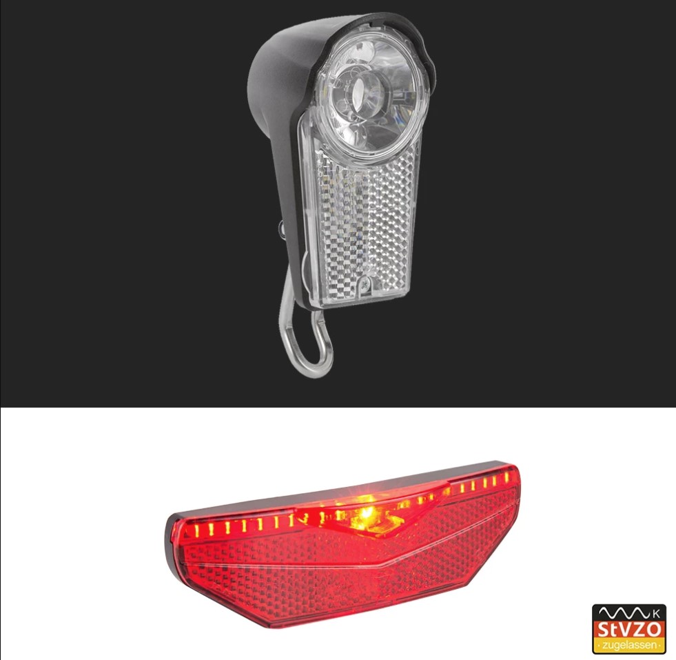

No. I wish Bafang had never done that. A 5V light is whimsy. I tap the battery lead and use a very bright Stvzo headlamp. But if you are a seldom night rider the Bafang option might be ok.

Finally installed the lights, but a temporary connection to run for a week or two before bolting and zip tieing. Works VERY well. Horn is a joke, more of an irritating buzzer. The brake light works consistently. the headlight is OK but sadly not Stvzo.

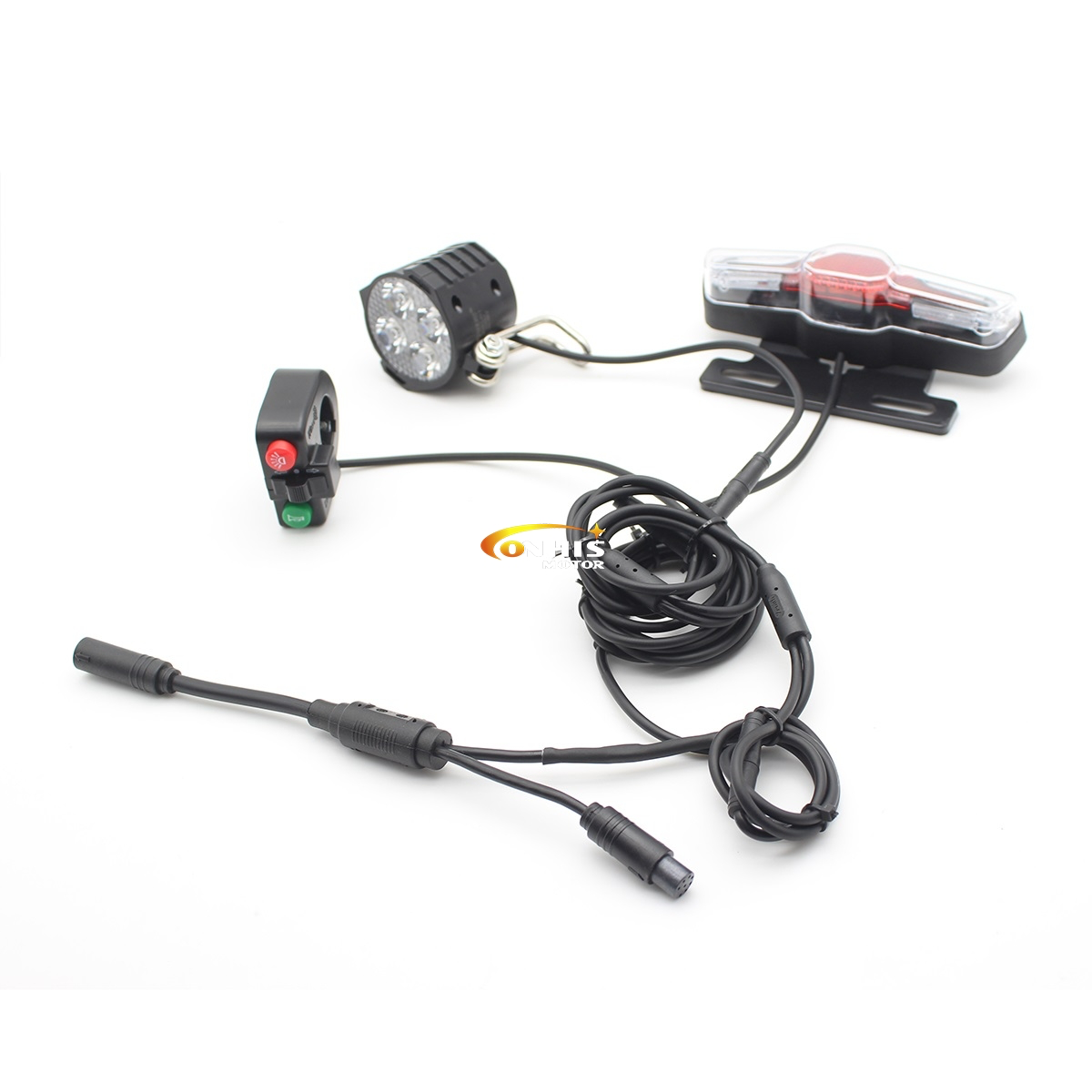

I just used this light set (about $14 cad shipped) with the at 6v .5a lead from the bbs02b controller. Works really well and the lights can be turned on/off from my Bafang contoller! I'm happy with it for now, not as bright as the set posted above, but works well for illuminating the bike.
Not the same kit. But it’s good if you are happy!
