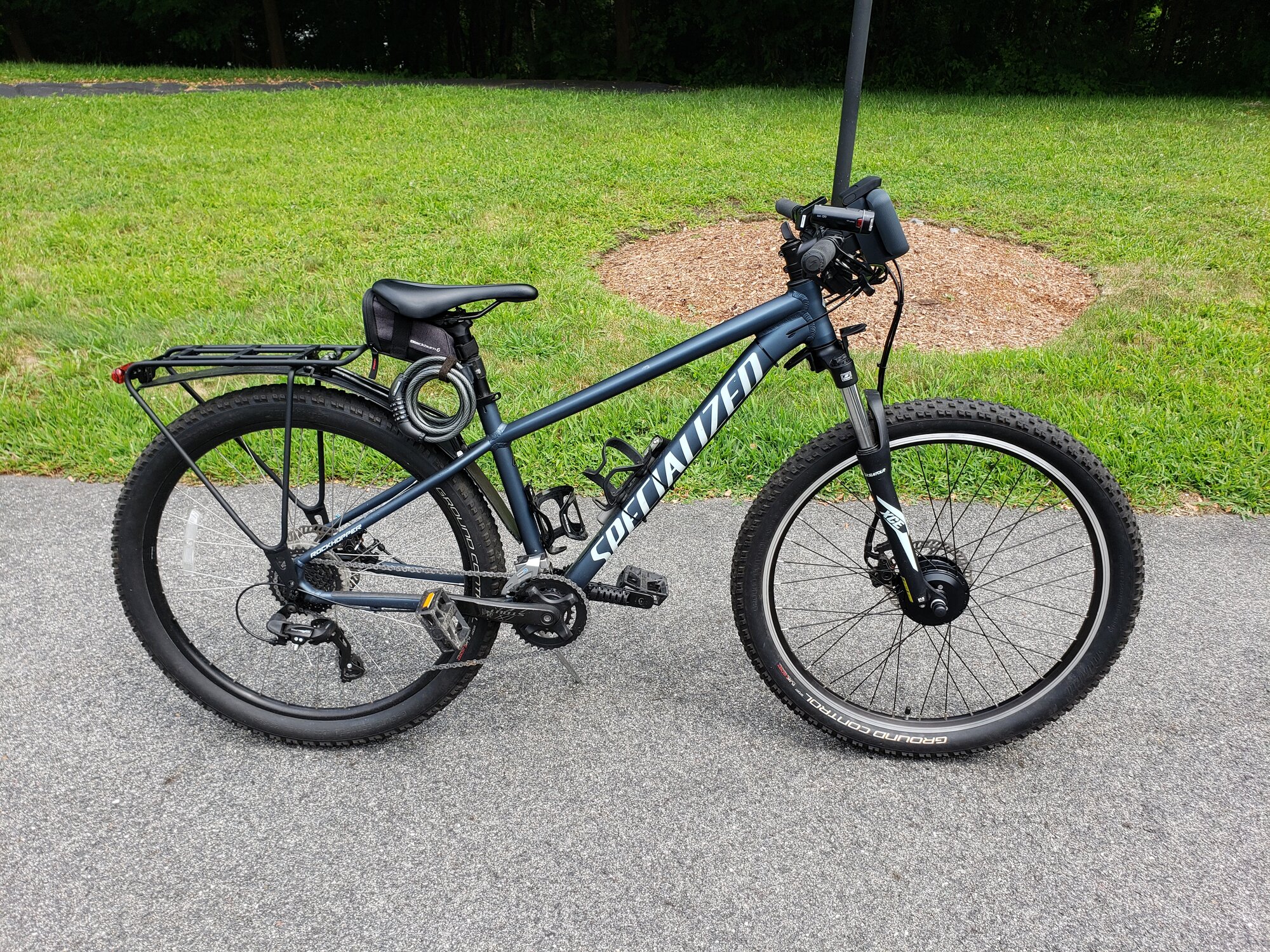

Anyone else using the latest Swytch Kit? I just installed one on my son's Rockhopper (mainly so he would stop borrowing my Turbo Tero) and am impressed by the power it provides on such a light bike. It does take some getting used to the fact that it only works on pedal cadance.

How was your ordering and install experience?
Ordering was a little slow. I changed to the better OLED display and added a 2nd battery and the mechanical brake shut-offs during the order process so I am not sure if that slowed it down more than normal. I think it took several months to actually get the kit.
Installation was relatively painless. I did not install the brake shut-offs and I had to fudge the cadence sensor since the down tube on my sons Rockhopper was not round.
Since it is a true cadence sensor, starting from a dead stop is very different than my Turbo Tero but overall it works great.
