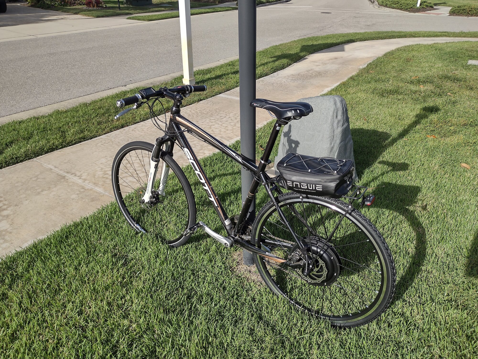

I'm into my build, and ran into a problem I need your help with. My bike has Shimano Hyperdrive system, which uses an all in one gear shift/brake. I took off the front derailleur and brake lever combo, and replaced it with the brake only lever with power cutoff that came with my kit. I'm fine leaving the rear brake/derailleur as is, but the kit has both brake levers wired into the same plug for the controller. What would happen if I cut the wires for the other brake lever with cutoff and left the original in use? Would that tell the controller that I have an open fault? The kit has both brake levers wired into the same plug , but I only want to use 1 of their brakes, and leave the original combo levers in use with the rear derailleur. What's the answer? I appreciate any and all help!!
Well, the bike is together. No testing yet, but it runs and moves. Lots of tweaking and tuning, but it's assembled! I wanted a bike that didn't look like an ebike, and think I got it! Will let you know how it works and rides. Stay tuned!
Had my 1st real ride yesterday, 20 miles of flat paved bike lane. Went well, unit is quiet, pretty fast at 30+ with me aboard. Battery was down to 25% , started with 9 miles used for testing before I struck out, so I'd say it's good for up to 40 miles when full. It's not as comfy as my other bikes with bigger tires, but all in all it's a fun ride, good for a grocery run or a quick trip. Already thinking about the next build, maybe a single speed belt drive or ??
