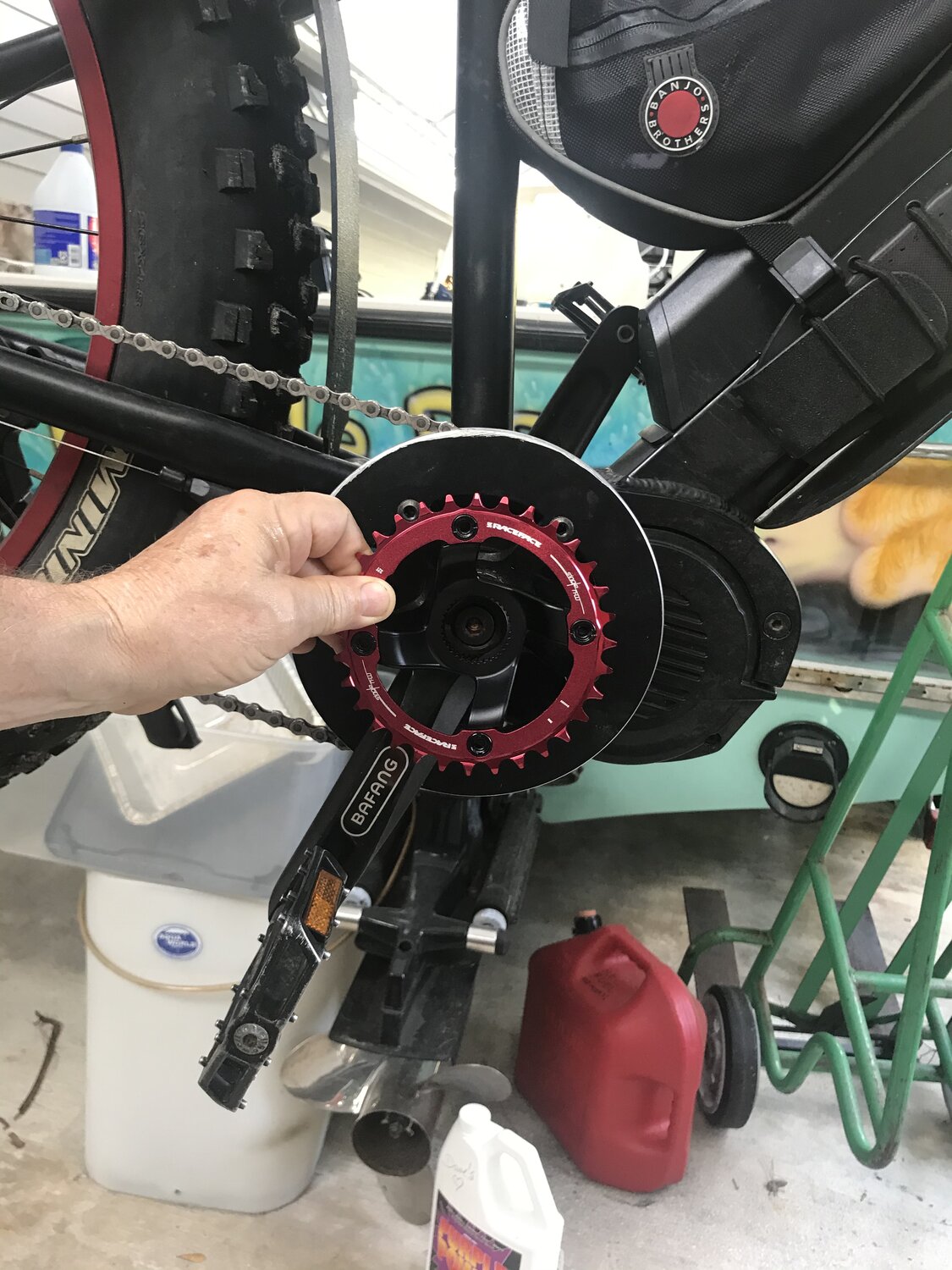

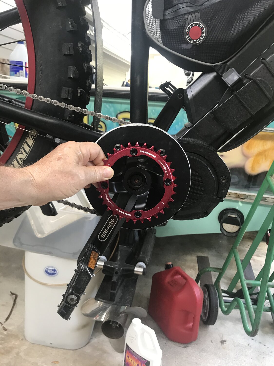

I just ordered Bcd104 adapter for the Ultra motor from Christini bicycles. I believe it will fit down to a 30 T chain ring! I'm starting with a 32T, not sure if that is going to be a mistake (too low). I ride 90% of the time in the woods and trails and when on the road I rarely if ever, go over 20 mph anyway. I'm coming from a 44T so it will be a huge change. When doing the math (if I'm correct) I should be going from 30 mph top end to 22mph top end but, it should have some serious down low crawling power! It should help tow a loaded trailer, and allow for really slow riding looking for game in the woods. Not a big deal if it's too small, I can always jump up to a 36T or 38T if needed. I'll give my buddy the 32T if it's a problem, It's all I can do to get him to go over 10mph!
I just put the 32T chainring on, I now have a good selection of tools so it took about 1/2 hour. Oh, I had to only cut two links to fit new ring but, I think my chain was tight on the 44. I took it for a spin but had speed limited to 20 mph ( not sure why) it felt like it would’ve gone about 22 mph or so, so I wasn’t off on my math. I’m going to try it in the woods this coming weekend to see how it works out. I’m also going to try to do a long ride on the road to see how it’s going to effect the battery life there. Check the picture out, quite the difference In size!B41AFC53-F4EF-4E9D-9CE5-10AFF60485DD.jpeg
I just put the 32T chainring on, I now have a good selection of tools so it took about 1/2 hour. Oh, I had to only cut two links to fit new ring but, I think my chain was tight on the 44. I took it for a spin but had speed limited to 20 mph ( not sure why) it felt like it would’ve gone about 22 mph or so, so I wasn’t off on my math. I’m going to try it in the woods this coming weekend to see how it works out. I’m also going to try to do a long ride on the road to see how it’s going to effect the battery life there. Check the picture out, quite the difference In size!View attachment 80387
