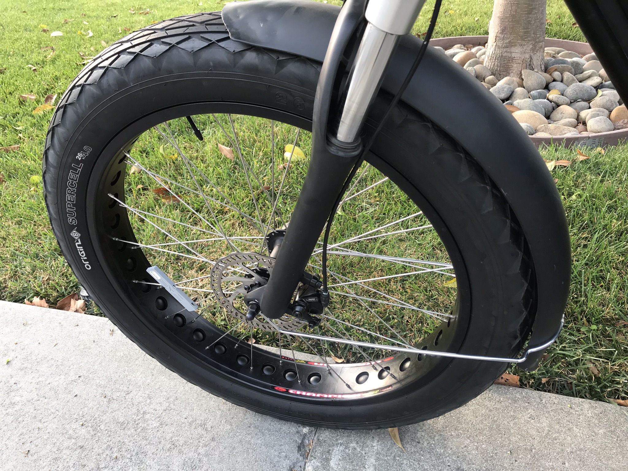

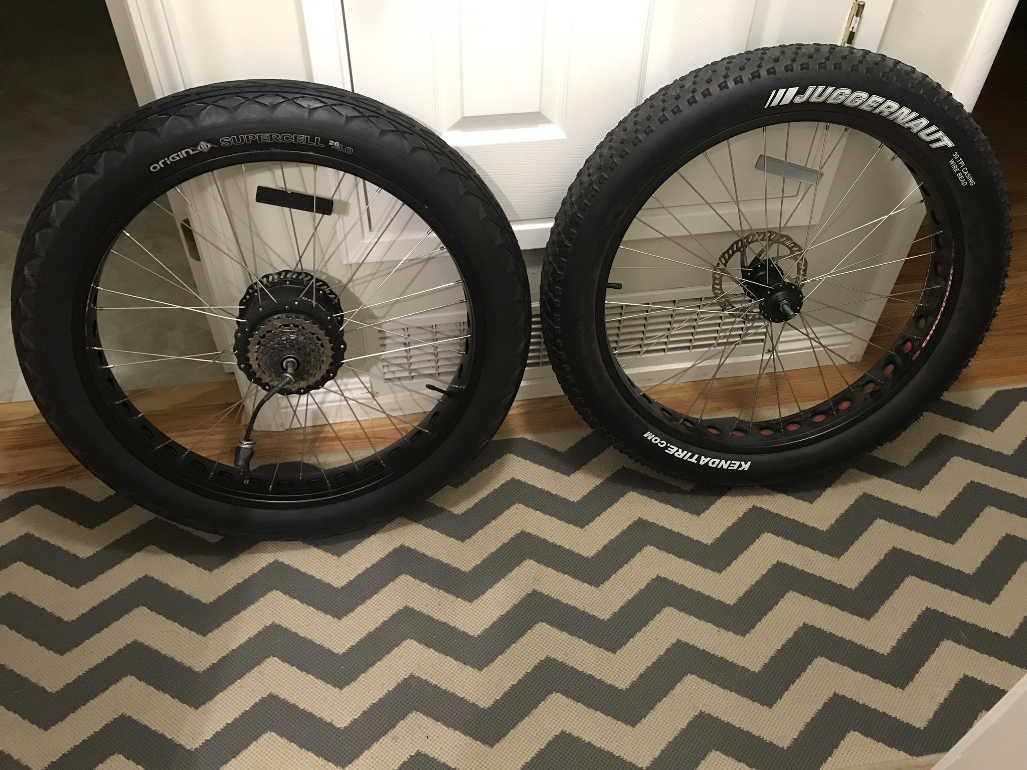

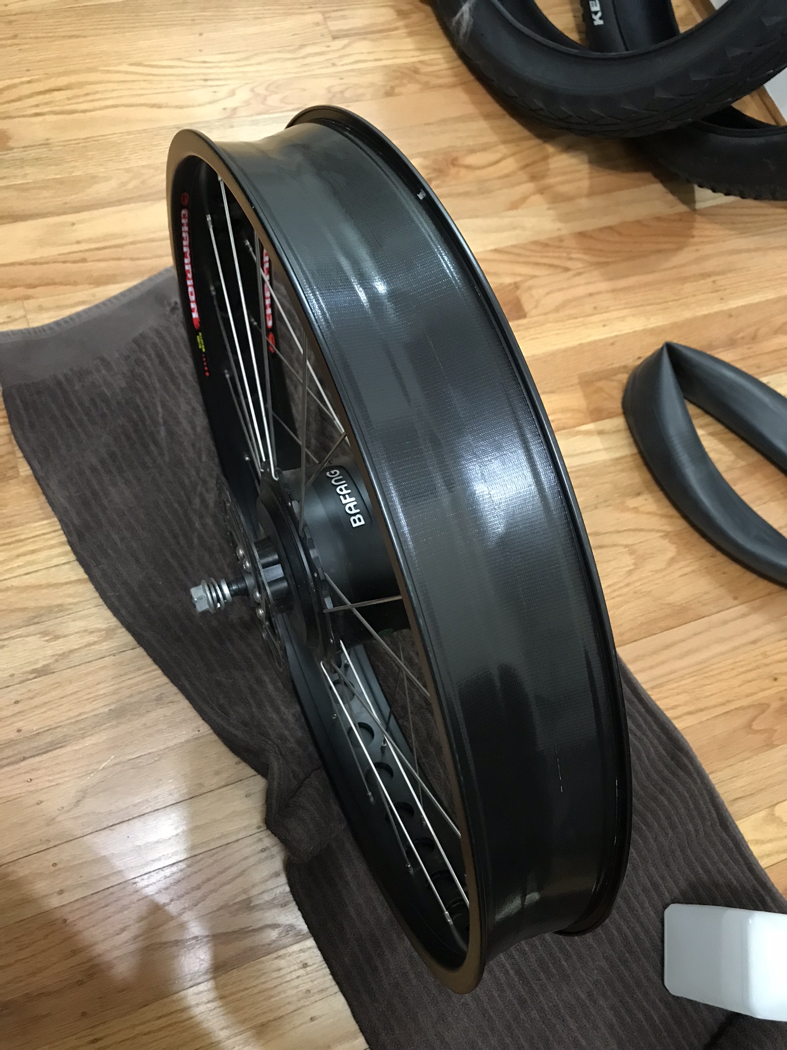

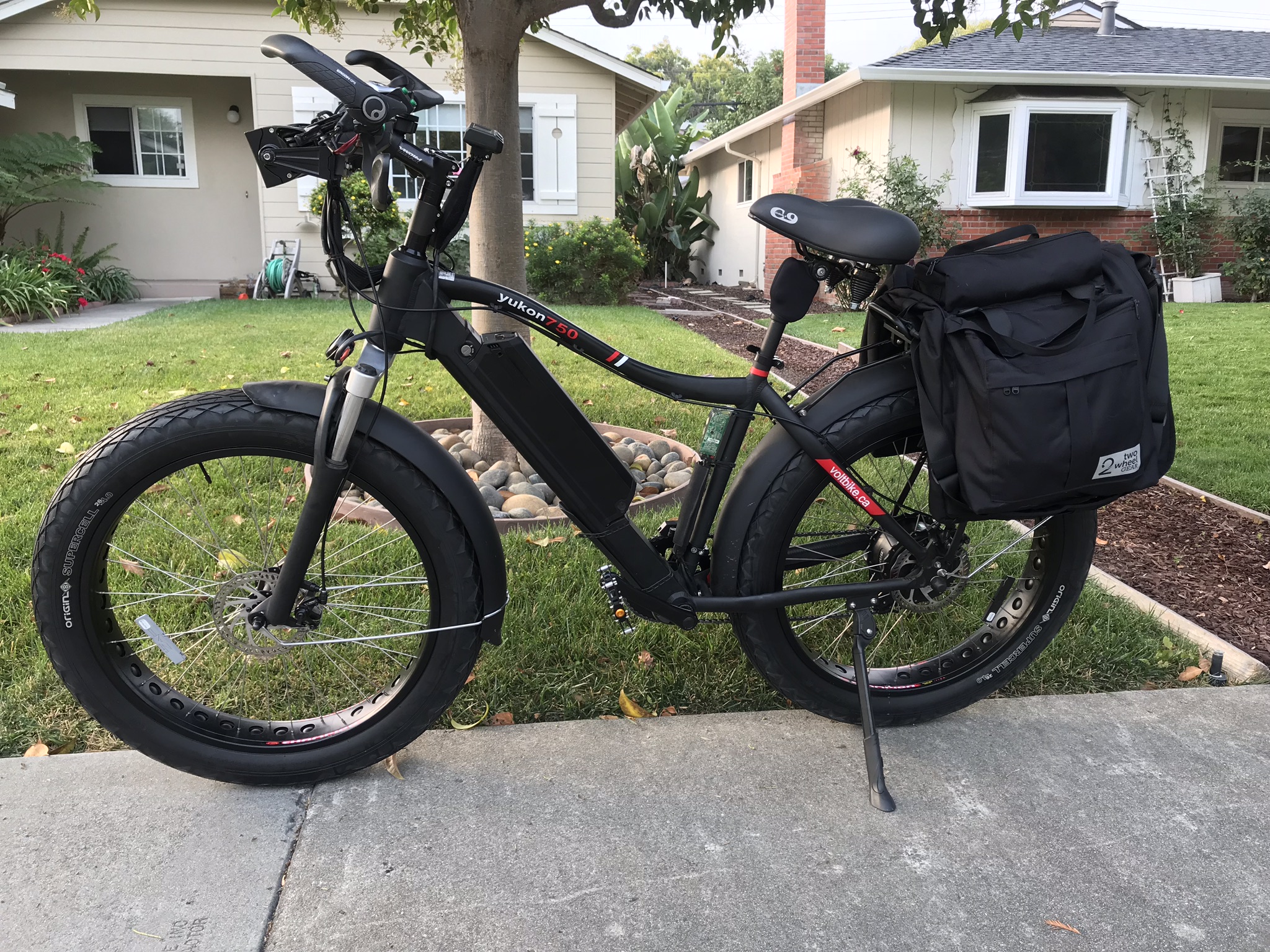

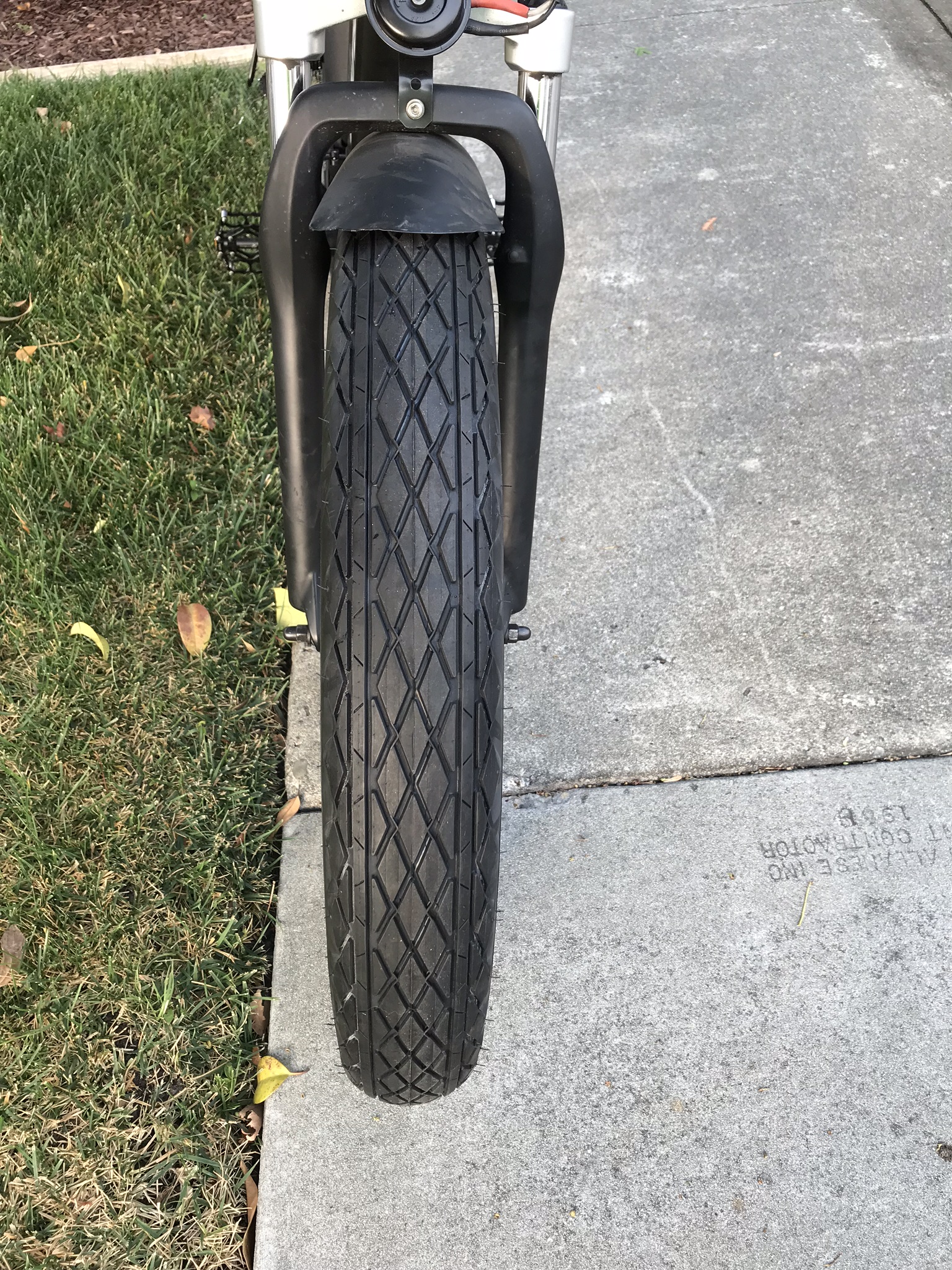

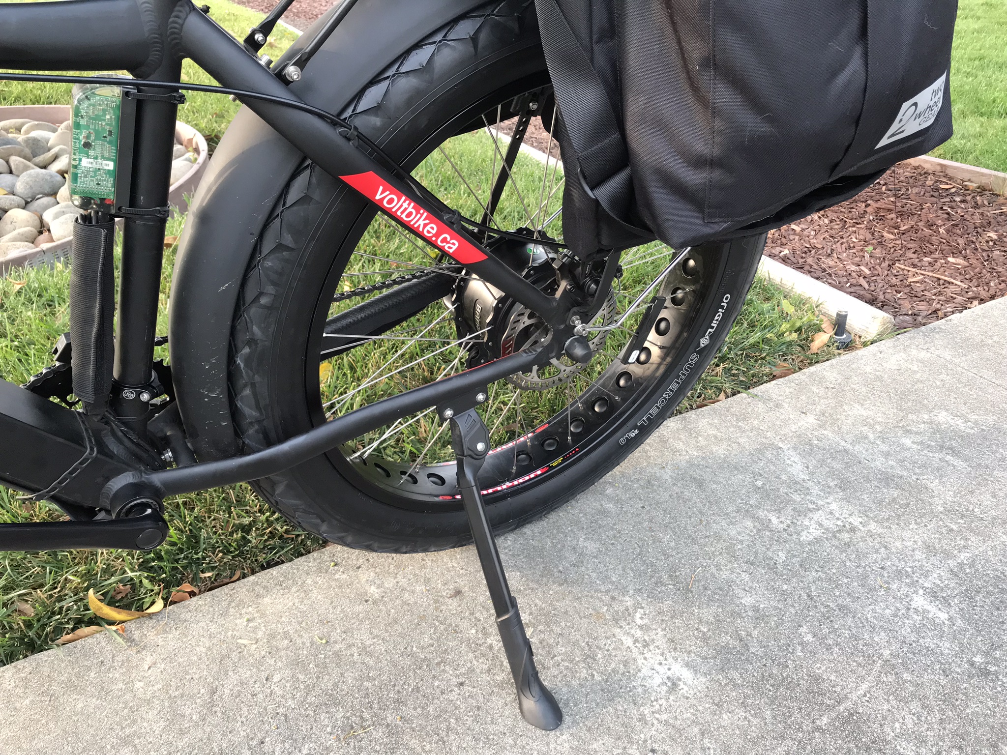

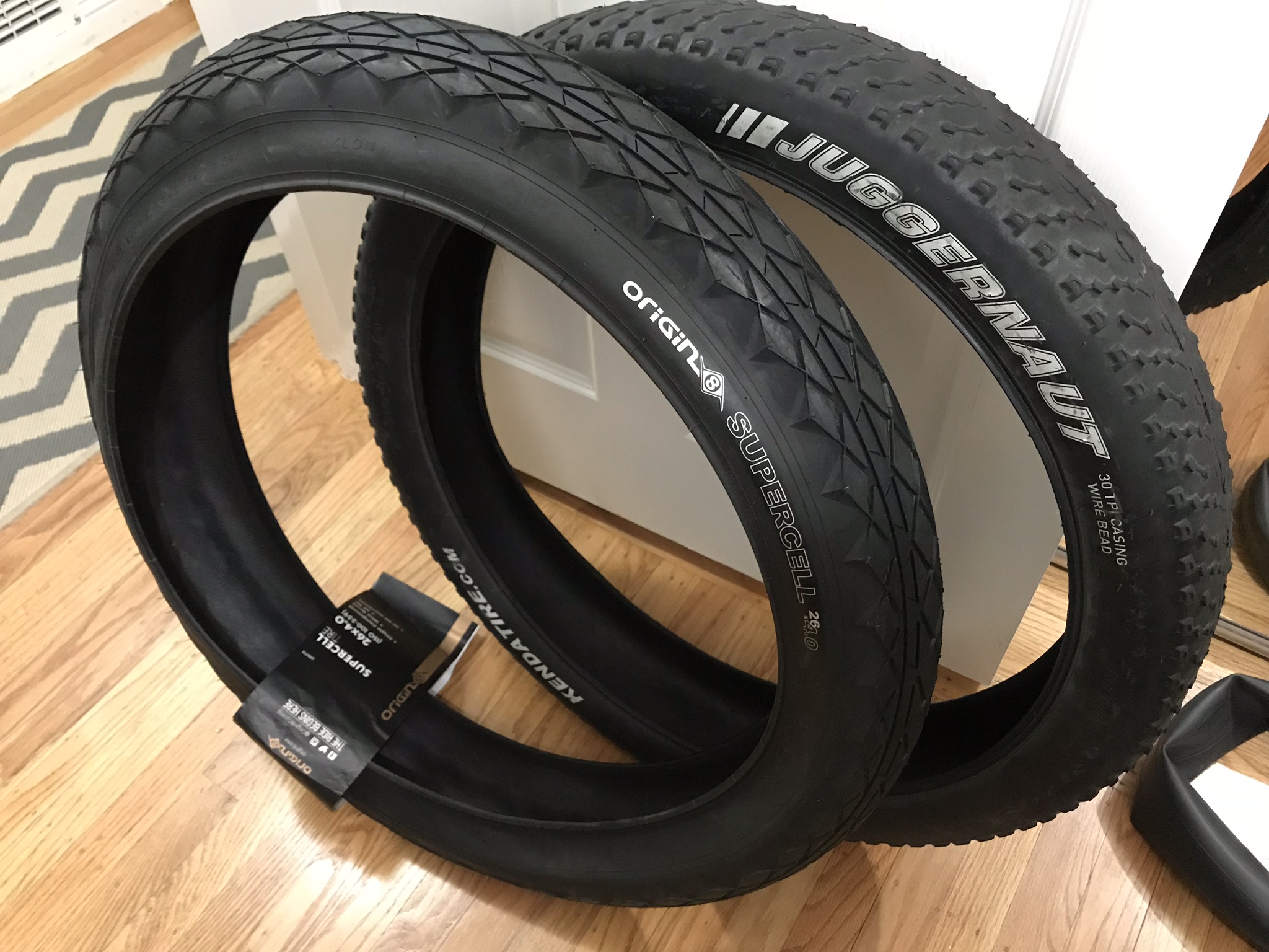

@PCDoctorUSA I commute with my Yukon and love it. Granted, I have changed a lot on my ebike, I recently swapped out the nubby stock Juggernauts for Origin8 Supercell tires. Talk about a huge difference! My ride is so much smoother and quite. I also converted the wheels to tubeless and have not looked back. Here are a few pics:
Origin8 next to the stock Kenda's:
Gorilla tape shown applied to wheel for tubeless conversion. I also took the liberty to change the liner from red to black. A lot more stealthy
Origin8 mounted next to stock Kenda's mounted.
Picture of my beast of a Yukon.
Close up on tire tread (I took some frustration out on the front fender during another upgrade).
Side view of front tire tread.
Side view of rear tire.
Side view of front tire tread. View attachment 18715
Side view of rear tire. View attachment 18716
Thanks for those photos.
How many TPI for the Origin8 you installed, 30TPI ?
@ace20ri Great looking Yukon! I checked out your post "Customized Voltbikes", and you have definitely taken the bike to a new level. Those Supercell tires would definitely be the first thing I change if I go with the Yukon. How do they hold up against punctures and what PSI are you running them at? What motivated you to go tubeless and where did you get the black liner? Can I also ask what your commute is like? Distance, road surface, grades, etc. Sorry for all the questions.
They are 30TPI
Thanks for checking out the post. I only have 125 miles on the Origin8 Supercell tires but so far but no punctures yet.. I have had 5 flats on my rear wheel in the past 4 months so this last flat I decided to go tubeless. I am still messing around with the PSI setting, but right now I run them at 18PSI, with a max of 20PSI possible. I ordered the Origin8 liners from Amazon (hyperlink attached). My commute 25mi/day is all paved road (both asphalt and concrete) with about 300 feet of elevation. I live in Silicon Valley in California so we have great bike lanes but depending on the city the lanes can have lots of debris due to the lack of street sweepers. I am itching to try them out on the beaches here.
