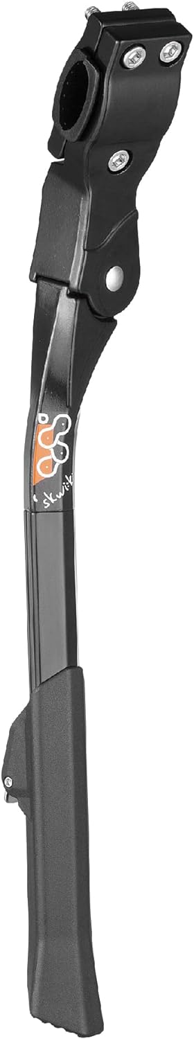

it's the stock kickstand that comes with the NCM / Amego bikes , checking sites i see it's adjustable but looking at it i have no idea how.. Does anyone know?
*edit nvm i may have found the bolt will try to adjust it tmrw*
whelp for future reference if anyone didn't know this but the kickstand for the ncm moscow / amego / magnum brand bikes and so on are adjustable... i didnt know this 3 years in and its going to save me like $100 as i was going to buy a really expensive one.. this video shows you how to do it.. not the same bike in the video but similar or same kickstand in the video

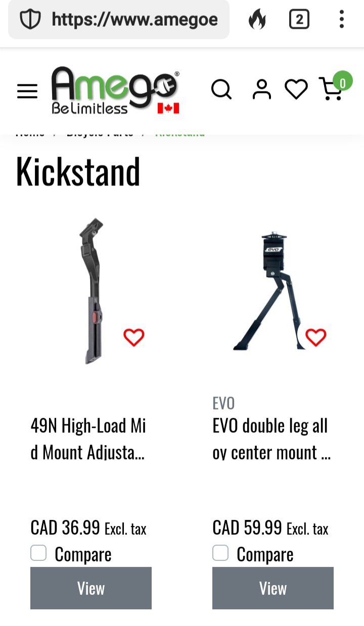

Amego was asking over $100 for either of these kickstands last year with all the shipping and taxes.

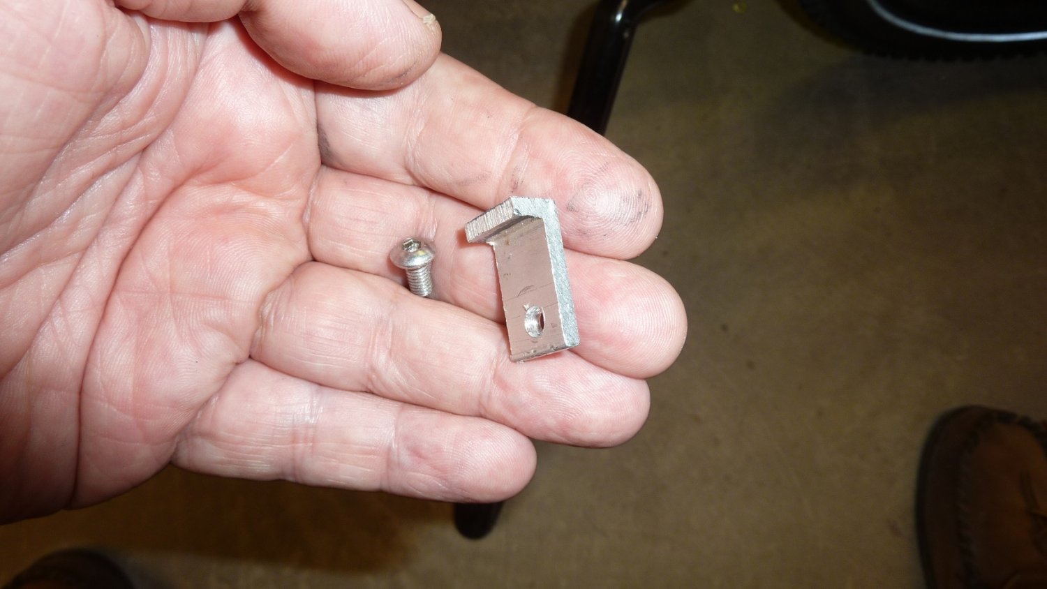

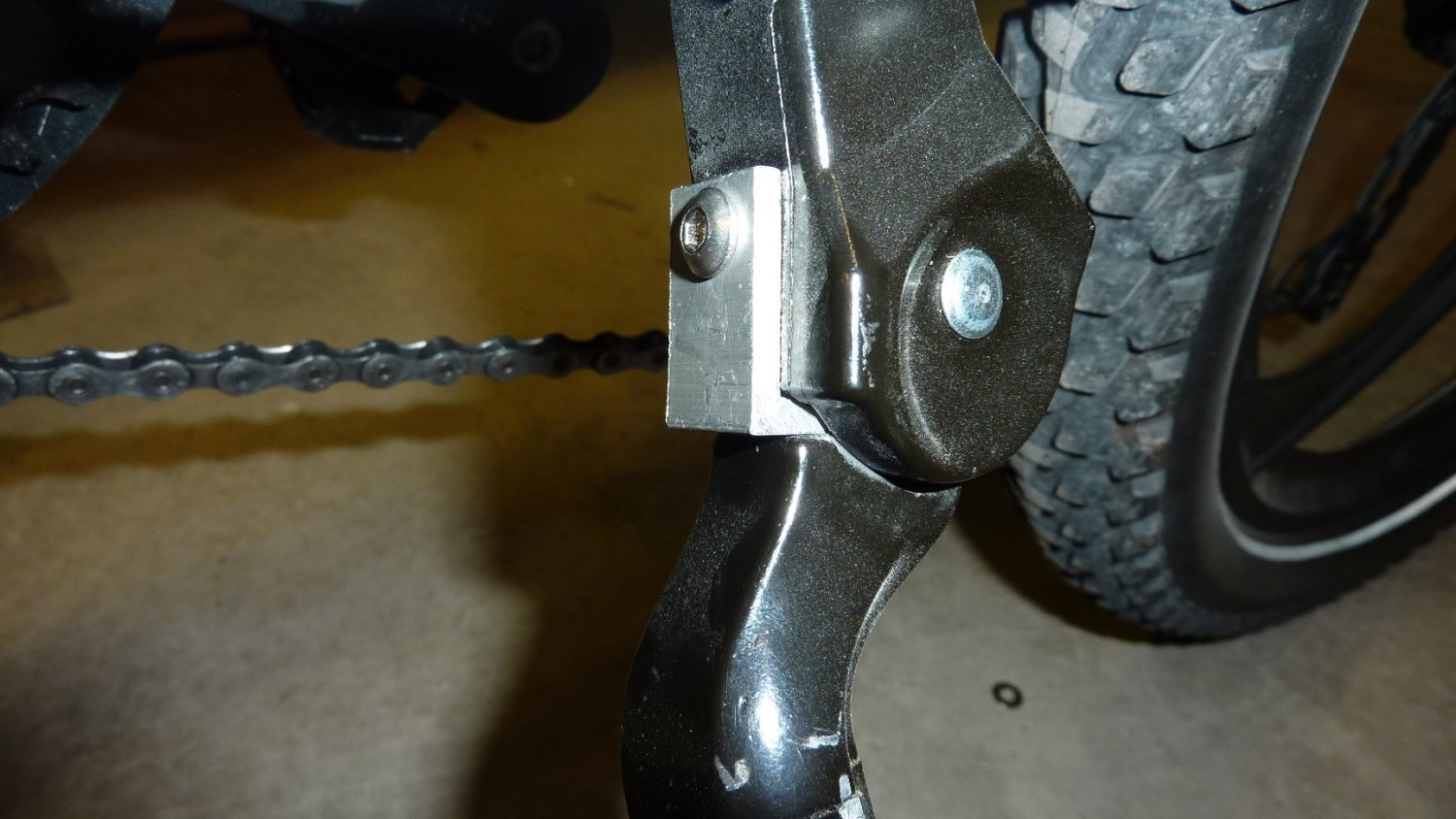

On some rear heavy bikes, stability is affected by where the kickstand touches the ground. If adjusting the length doesn't help, you may be able to modify your kickstand instead of replacing it. You may be able to insert a shim in the mechanism to make the stand contact the ground farther to the rear.
The above modification moved the ground contact point 4" to the rear which made a big difference in the bike's stability.

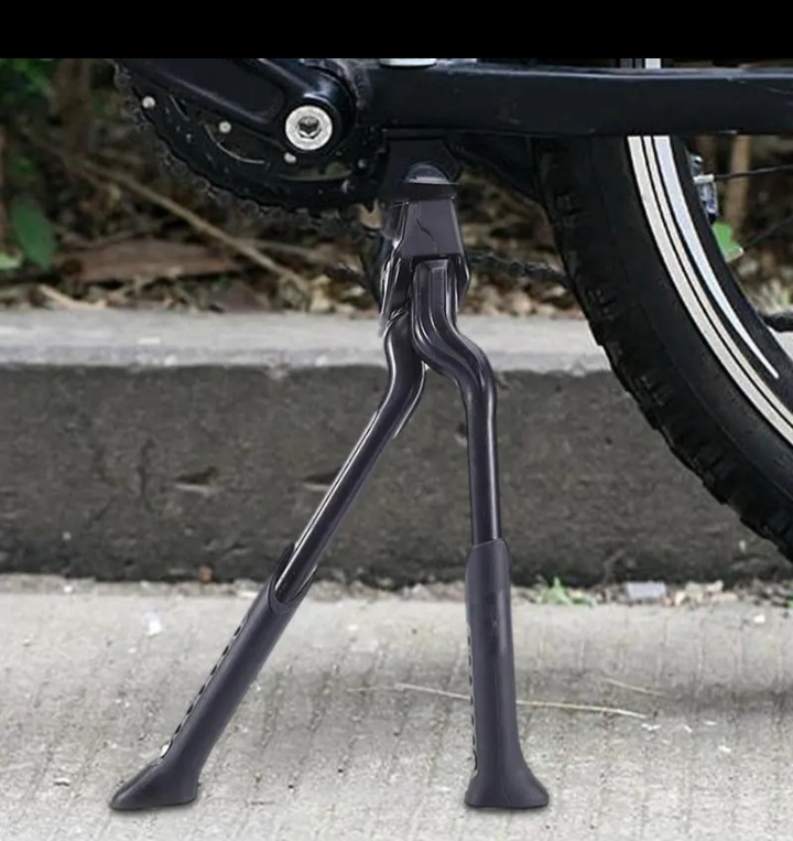

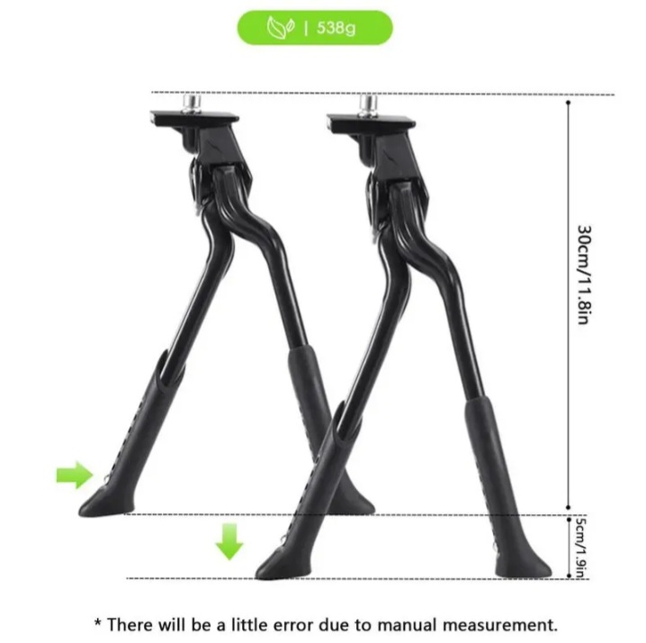

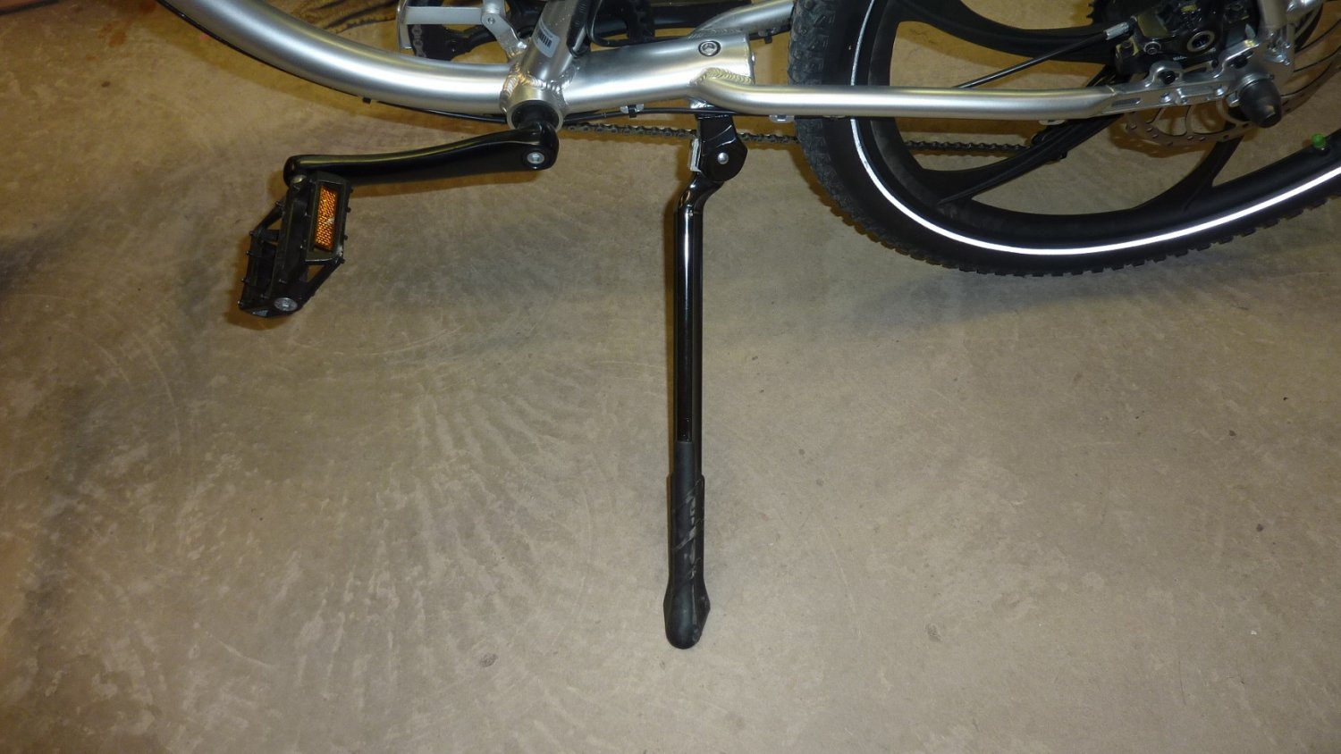

i ended up getting this kickstand because i wasn't able to loosen the bolt to my old kickstand..
this kickstand snapped on perfectly and has adjustable height on the fly which is so useful for tilting my ebike in the right positions based on floor elevation because of food on the rear basket which i need to center .. It's perfect and made my uber eats life so much easier and less stressful as i no longer have to find a place to lean the bike against and worry about elevation.
Looks good !!
Adjustable on the fly. I like that.
You can spin your crank/pedals around without hitting the kickstand.
That can be quite helpful.
Keep an eye on those three bolts.
There's a lot of pressure on the kickstand, and they can loosen up.
Looks good !!
Good call. I’d probably tighten up the top left, the bottom, then the top right. Get a real good bite.
