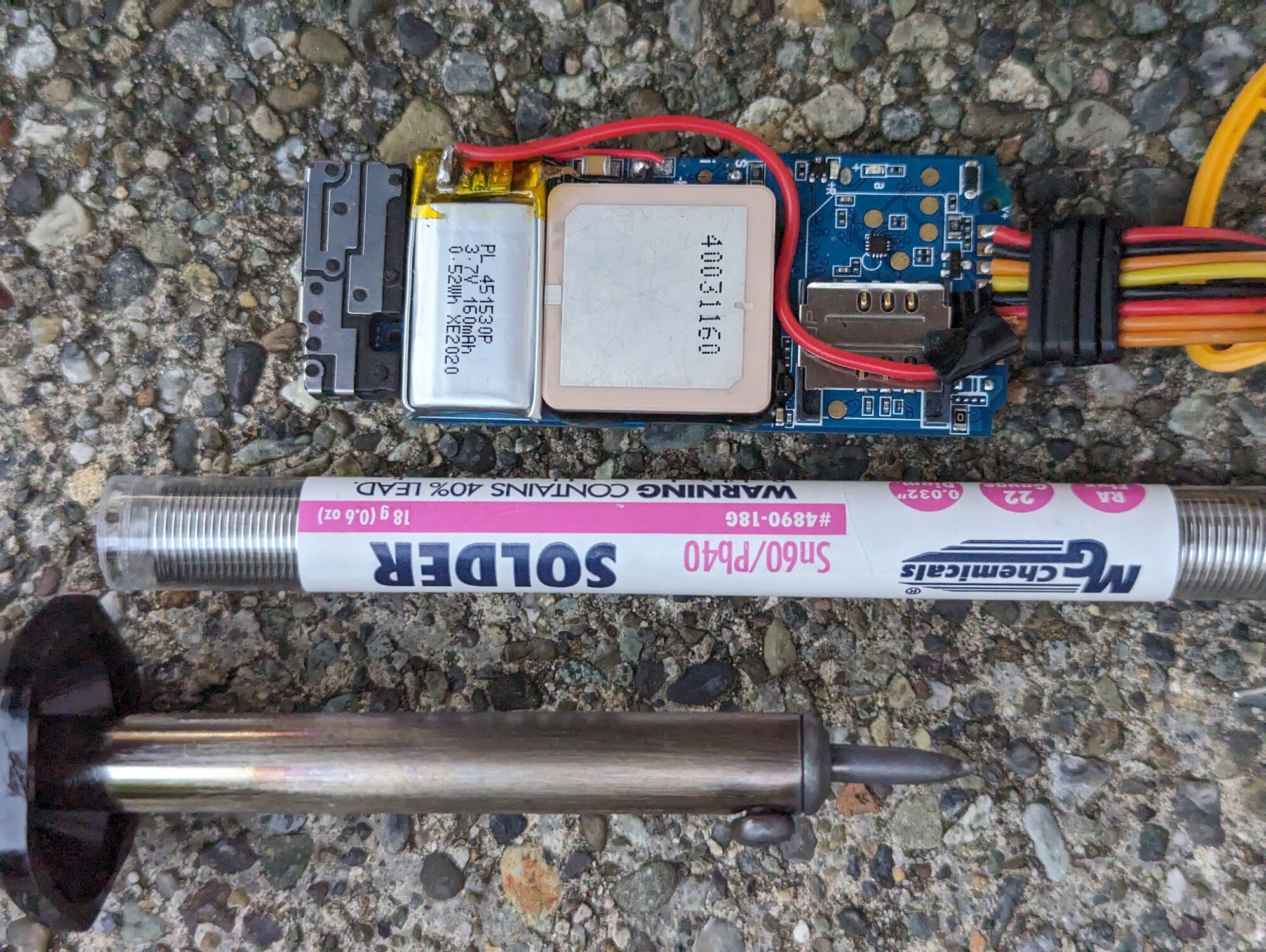

Another thing to mention. You'll need the TK419 version with the external battery. You can buy it directly from the manufacturer. You can't use an external battery without rewiring the internals of the GPS. And the internal battery only lasts 4 or 5 hours. If you ever take the ebike battery to charge at work, then you'll need the external GPS battery to keep tracking past 5 hours.
To get the external battery to work on a regular TK419, you'll need to open it up and cut the internal battery wires. Then connect them to the 7th and 8th wires exiting the GPS. Make sure to desolder them from the PCB first and connect the ground/positive wires in the correct orientation. The 7th and 8th wires are the same color so be-careful not to accidentally reverse the polarity. After I made the modification and connected a 1500 mah 3.7v lithium ion battery for RC cars, the GPS lasts over 50 hours without external power. It even recharges automatically when the GPS is powered by the ebike battery.
Thanks for the tips. I ended up doing this for my older TK419. I originally bought the version without external battery, then ordered a second tracker (B version with external backup battery) with an extra backup battery for my first tracker. As you note, unless you have the B version, it won't work without modification.
I did some testing with my meter, and concluded that all you really need to do is desolder the 7th wire and hook it up to the + terminal of the internal battery (the 8th wire is ground, so you don't have to do anything with it). Wiring it that way, as opposed to disconnecting the internal battery, means you can still use the tracker without external battery. Of course, don't use anything but a 3.7V external backup battery, not good to hook up batteries in parallel unless they are the same voltage!
Edit: after more testing, I'm not sure I can recommend this hack for safety reasons. I noticed my device got very hot when charging the external backup battery. This doesn't happen when charging the built in battery. Perhaps because it's charging 2 batteries in parallel, although I had fully charged the internal battery. My TK419 B does not get hot when charging the external backup battery, only slightly warm. I suspect eelink has some additional safety mechanism built in to the "B" version. I'm not sure it's worth risking a fire with catastrophic consequences vs. just purchasing the "B" version from eelink.
