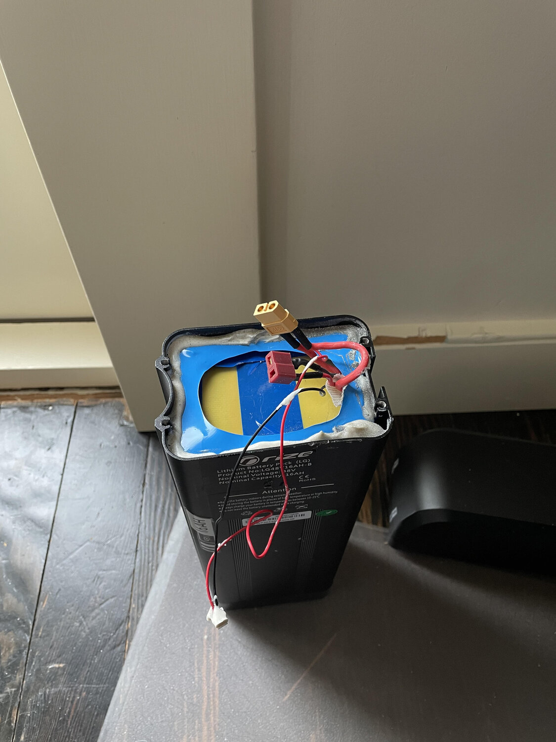

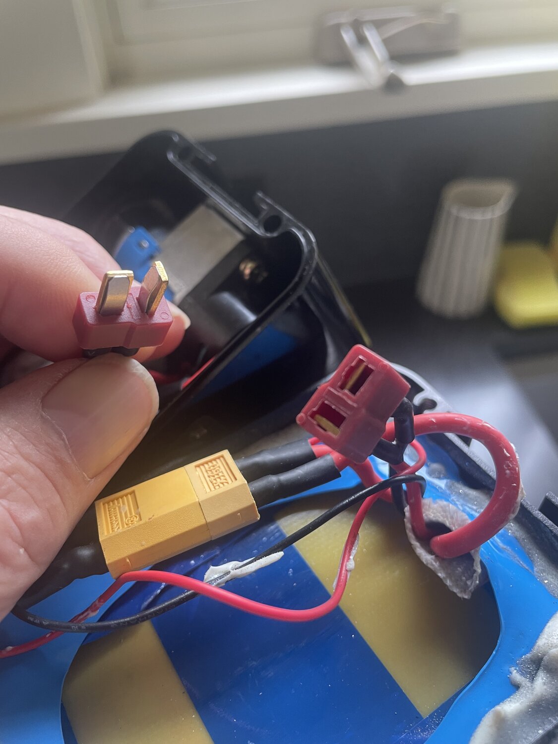

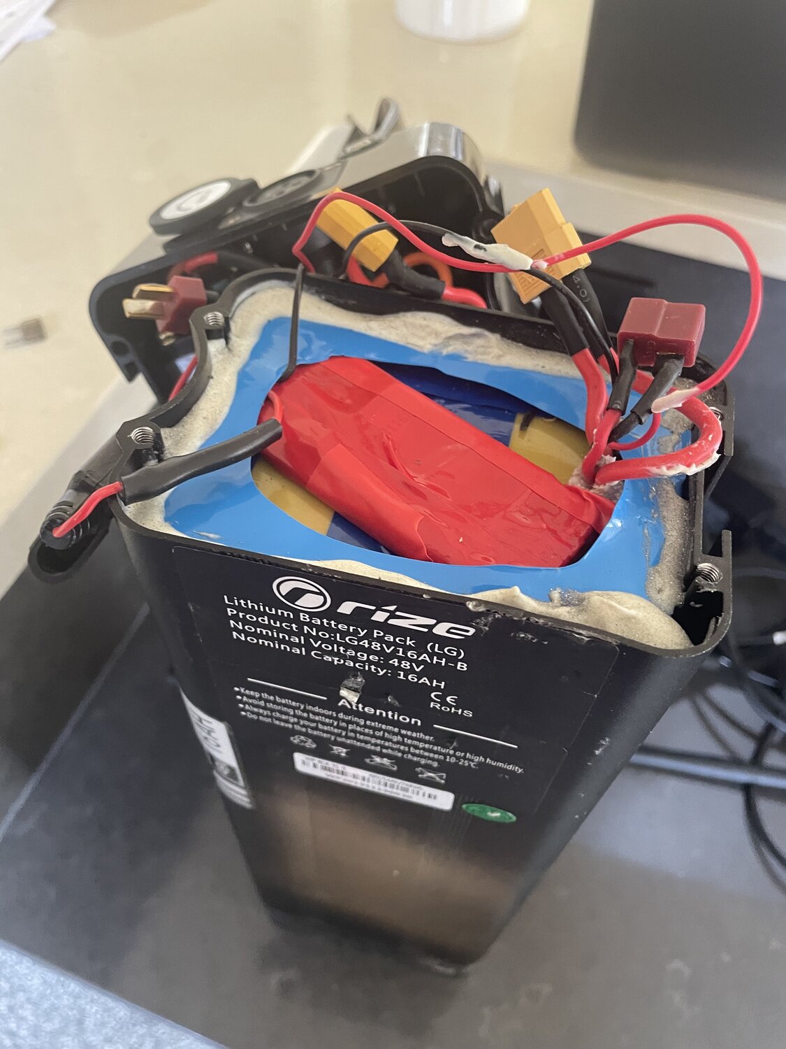

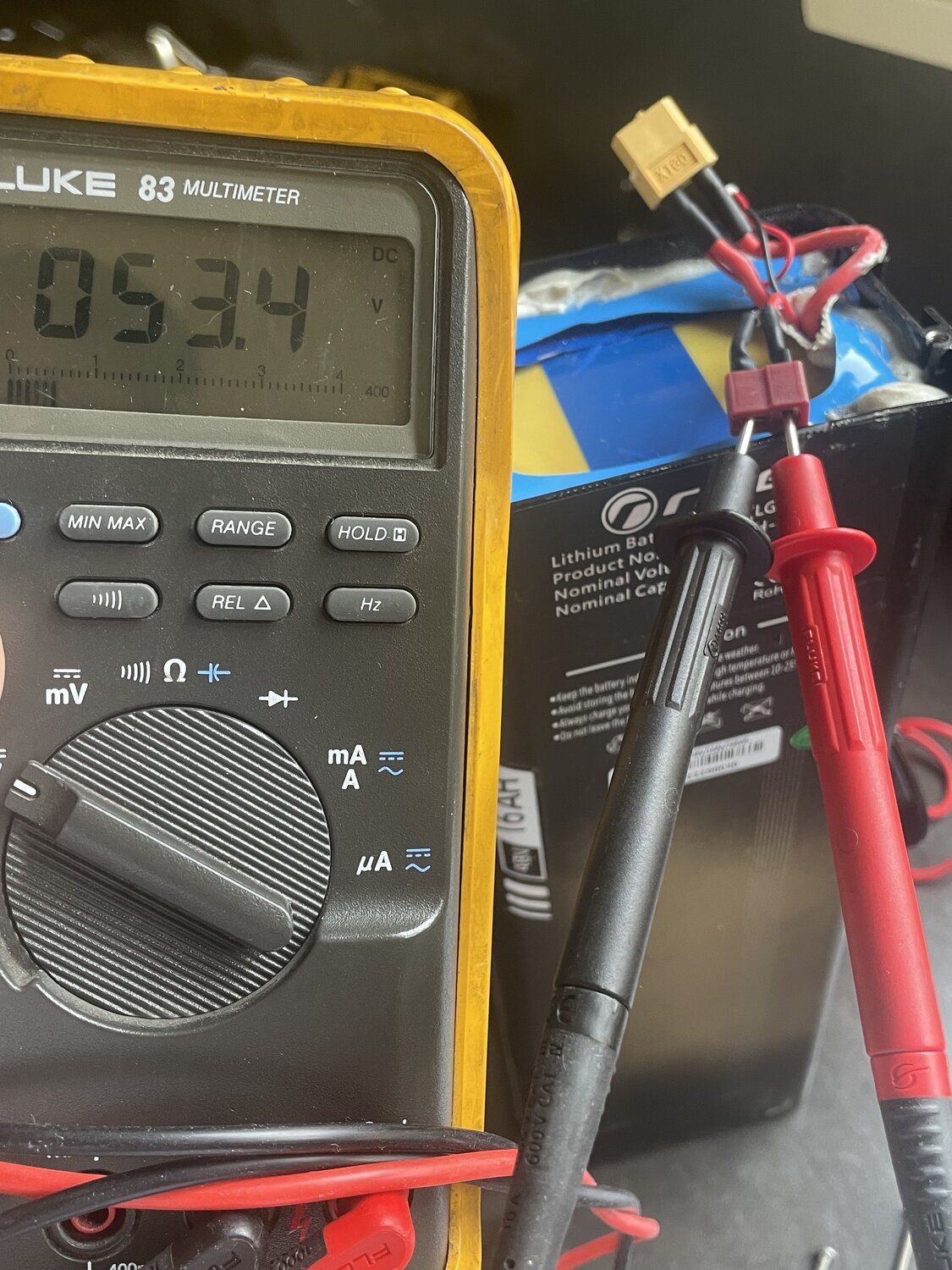

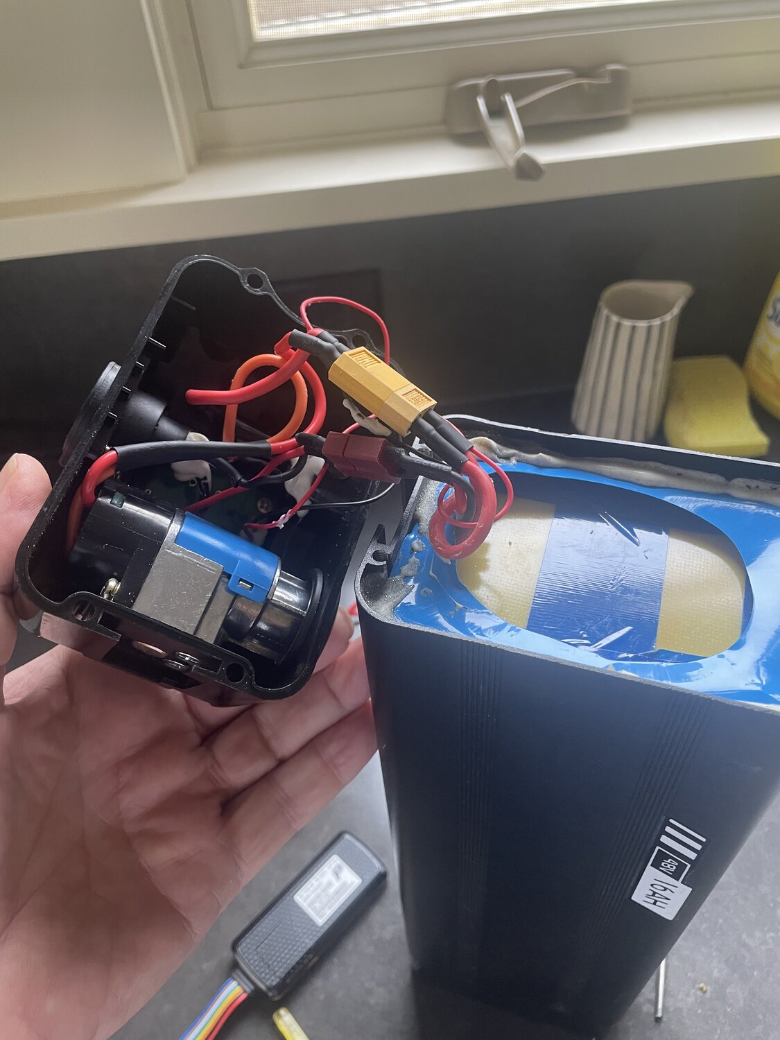

SO today I connected the first of my three TK419s to the SIlverfish Style Battery for my 2019 Rize Mini. It was fairly straight forward. I tapped off the positive (red) before the key switch and tapped off the corresponding negative (black). I incorporated a 2A fuse into the red+ feed to the tracker. I removed all other connecting wires since I won't be using them. I had considered using the relay circuit to power an audible alarm but due to space constraints and no viable woring path I decided against that = for now. I well may try that on my Kaabo MAntis Scooter and rethink the bike later if it proves feasible.

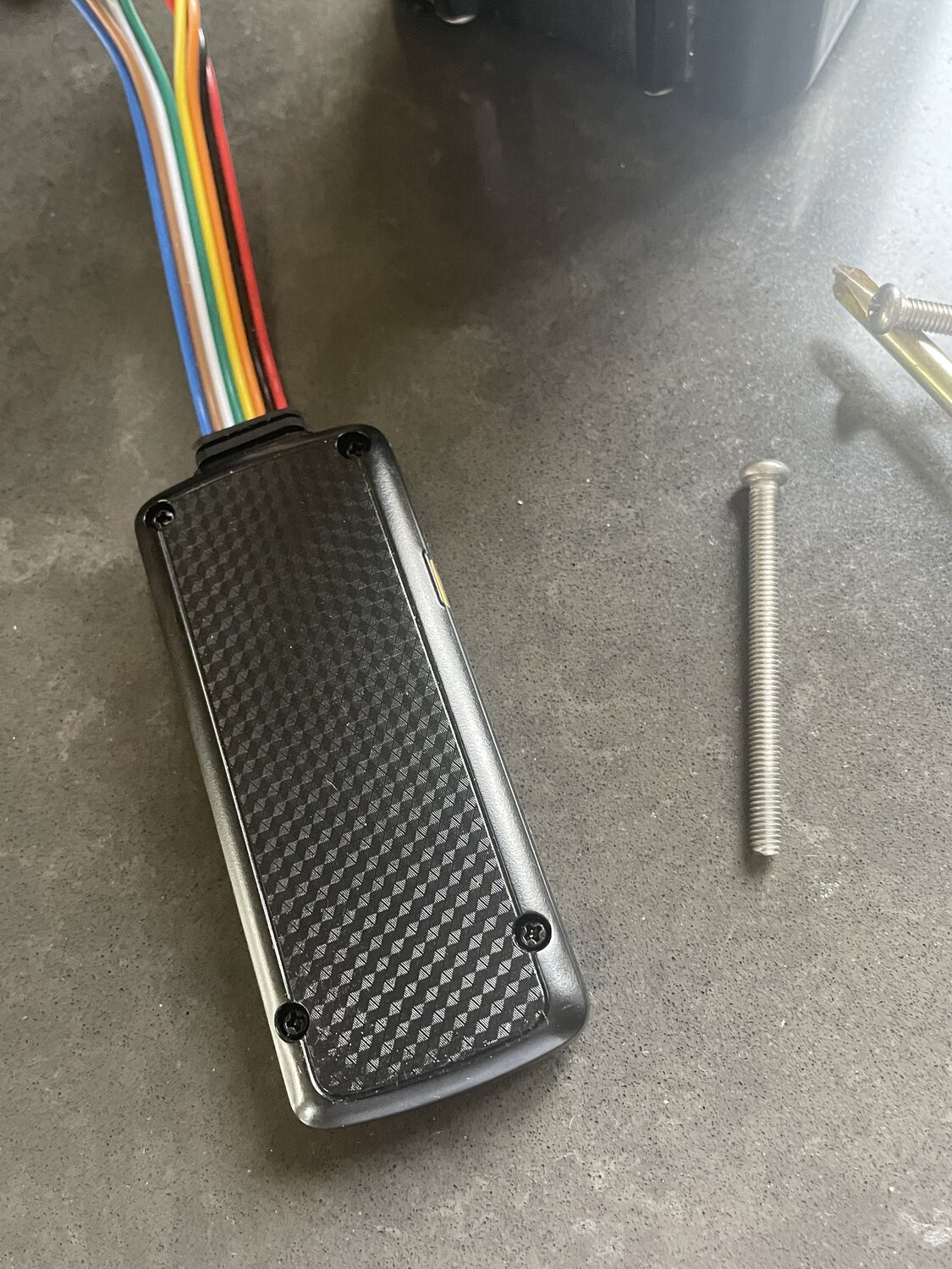

In order to help it fit I removed the case and insulated it and secured the Things Mobile SIM with red electrical tape. Also to conserve space I soldered the connections instead of using connectors or barrel crimps.
So here is the news. It works. It is powered 24/7 but that is a requirement since we want to track in the event of theft. I"m currently using the Eelink's native Keelin Tracking but will change to Ruhavik (gps trace). Things Mobile SIMs don't accept direct SMS messages but you can configure the device using SMS messages sent via the Things Mobile portal. They give you 10 free SMS transmittals with each SIM so it should be no bother to set up.
I have a 21 Ah Hailong Battery for my DJ Fat Bike. Will have a look inside that next and see if there is space.
Will keep posting as it evolves.

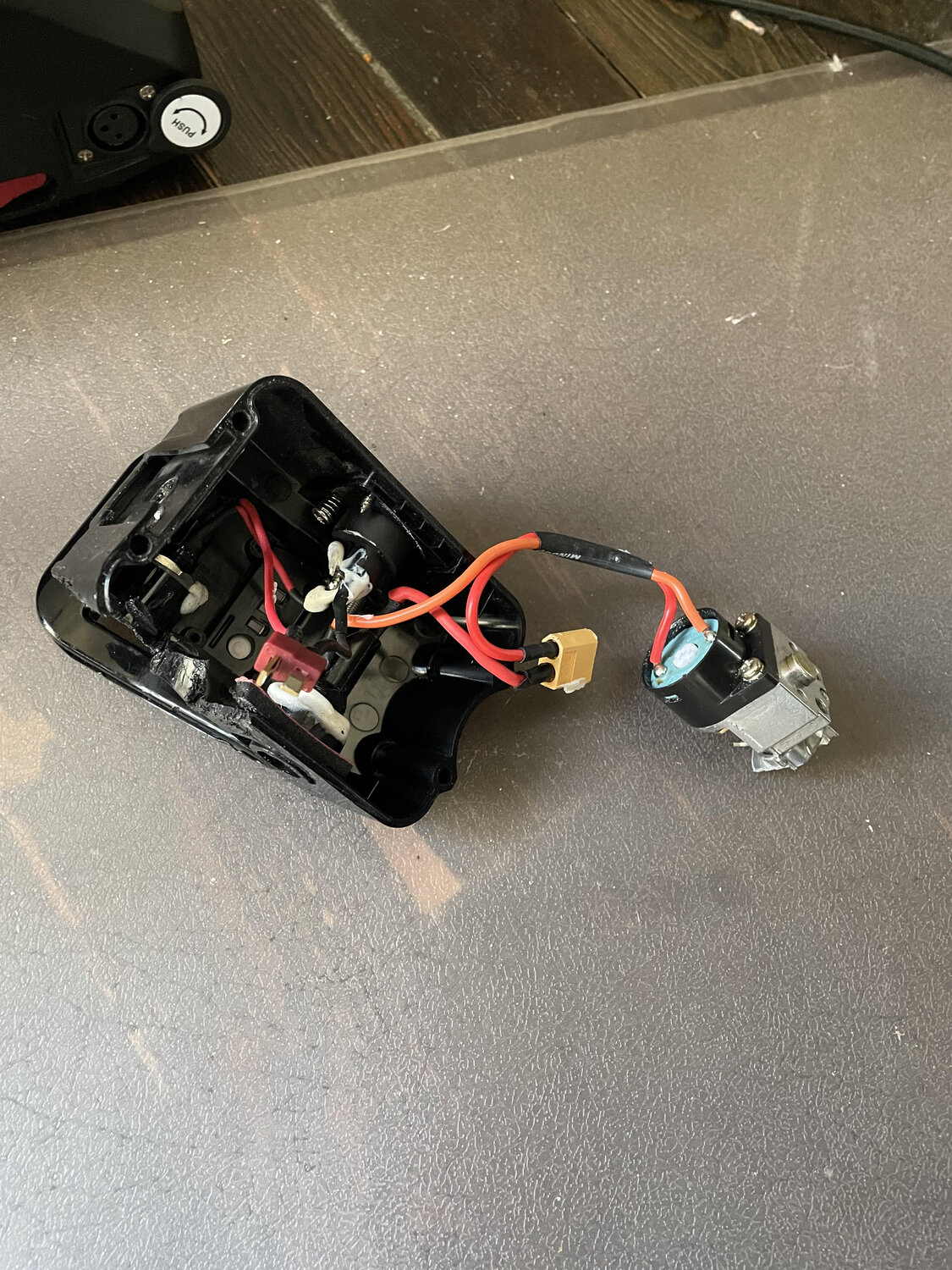

The installation of the TK419 with a Things Mobile SIM into the battery housing of my Rize Mini has been a success IMO. It tracks reasonably well and doesn't consume a lot of power. I am using Ruhavik as suggested by TomD in earlier posts.
I have not had the same success in fitting one into my 21Ah Hailong case for my other bike primarily due to space constraints. I had to shoehorn it in. The good news is that I am getting no signal at all so I have either dislodged the SIM or open circuited the device. I will open the case a check later in the week and get back with an update.
UPDATE. I opened up the Hailong case and found the fuse I had incorporated into the tracker circuit was blown. Perhaps it was faulty to begin with or maybe I grounded it during installation. Anyway I replaced it and it is working now. It was very difficult to get the unit to fit into the available space but it is now tracking well.. Next one goes into my scooter. I won't talk about that here.
Lessons learned.
There is very little space in the battery packs that I have opened. (Hailing and Silverfish) so it is necessary to remove the trackers from their casing to make them fit.
Things Mobile SIMs work but do not accept regular SMS messages but will accept SMS configuration via the Things Mobile Portal thus reducing the setup hassle of switching SIMs referenced by TomD earlier in this thread.
I have had no problem setting up separate tracking accounts with different email addresses - one for each bike.
I have had no success in trying to change the name of my devices in Ruhavik so choose a good name during initial setup. If anyone can guide me in this please do.
I will edit as appropriate as I learn more.
