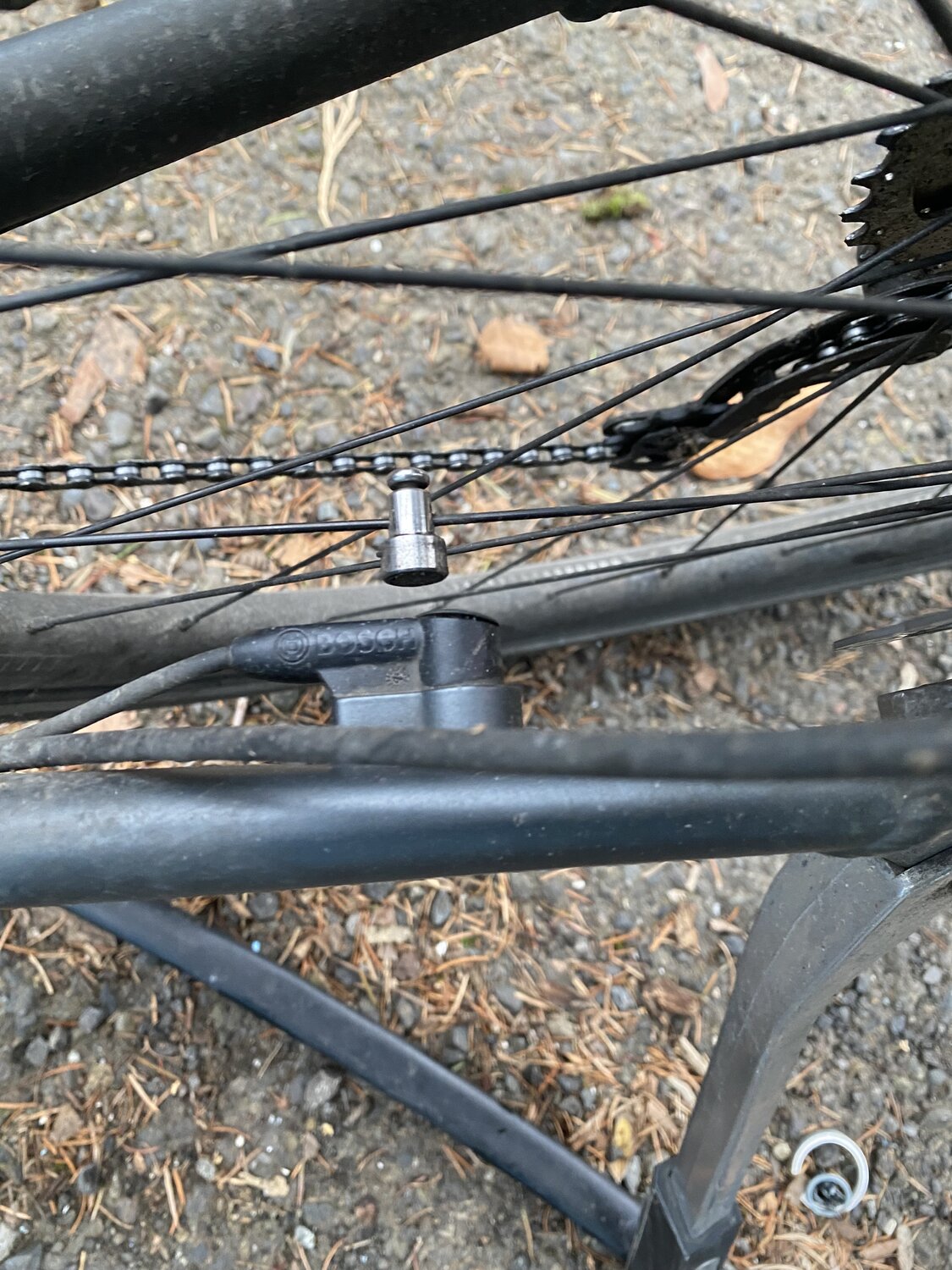

I just had this on my nyon after 12,000 miles. took it in and they think it was just a tiny magnet position issue. from what I was told it can be a real finicky thing. so I would adjust it and see. I can post a pic later of mine.
Interesting. I was able to find from online sources and the Bosch manual that the magnet needs to be over the line which in your photo is to the left of where your magnet is located and also not perfectly flat but slightly turned so that in the downward passage past the frame mounted sensor the edge is slightly closer on top. Do you get errors at all with the position you have your magnet in? Dealer is sending me a new sensor just in case and I have the correct crank puller so will probably go for some dielectric grease on the motor attachment after removing the left hand cover. If that doesn't work, swap out the sensor and hope that solves it.
this is what the bosch mechanic set it at after I got the error so far its worked well. but it could have been crap on riding I the rain on it too.
I ended up getting a new pickup sensor under warranty but I am waiting for warranty expiration (2 year mark) in Jan. to pull the side cover on the motor and swap out the sensor. That said I too did some experimentation with the magnet position and ended up sliding it back towards the bolt bulge but then turning the spoke pick up slightly so it is angled down a bit as it moves in rotation towards the sensor on the chain stay. So far, no more error! Very weird. Guess time will tell if the actual pickup unit is going out and just self healing as electronic devices can sometimes to.

- Kiwibru is correct on the speed sensor/magnet alignment info... The magnet should be aligned with the vertical line on the sensor, near where the wire connects. Distance between sensor and magnet should be 8-14mm. Only Bosch magnets will work, as they are much stronger than other cycling magents (ie: computer magnet).

- If issues persist following verification of proper alignment, it is most likely an issue with the speed sensor/ cable assembly. This can mean a manufacturing defect in the component, and/or installation damage that partially severed or shorted the (2) wires in the speed sensor cable.
