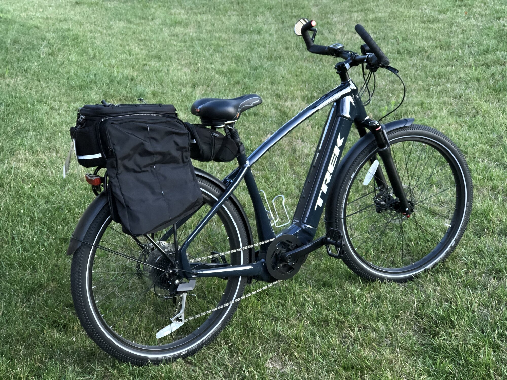

I’ve owned my Allant+7 sine May ‘20 and have well over 1k miles and still love the bike. I haven’t noticed any “slap” or odd vibrations. I did ask my LBS to adjust the derailleur after about 300 miles as it felt like it was struggling to shift quickly and quietly into gear when going uphill. It took him about 10 minutes and he chalked it up to wear in. It has worked fine since then.
I added a Bontrager shock absorbing seat post and a Serfas E-Gel seat, which is the perfect seat for me. Also added a Racktime Odin trunk bag that has zip up panniers in the side pockets. Also added a Topeak seat bag. It fits perfectly with the Racktime Lightit rack it came with. Also added bar ends to give me an optional high riding position and a Mirrycle Mirror. I had the (free) Bosch firmwear update done early on which added light on/off capability and E-MTB (replacing Sport mode) mode to the PLCX motor which I really like. I also added OneUp pedals as the factory pedals are a bit slippery.
