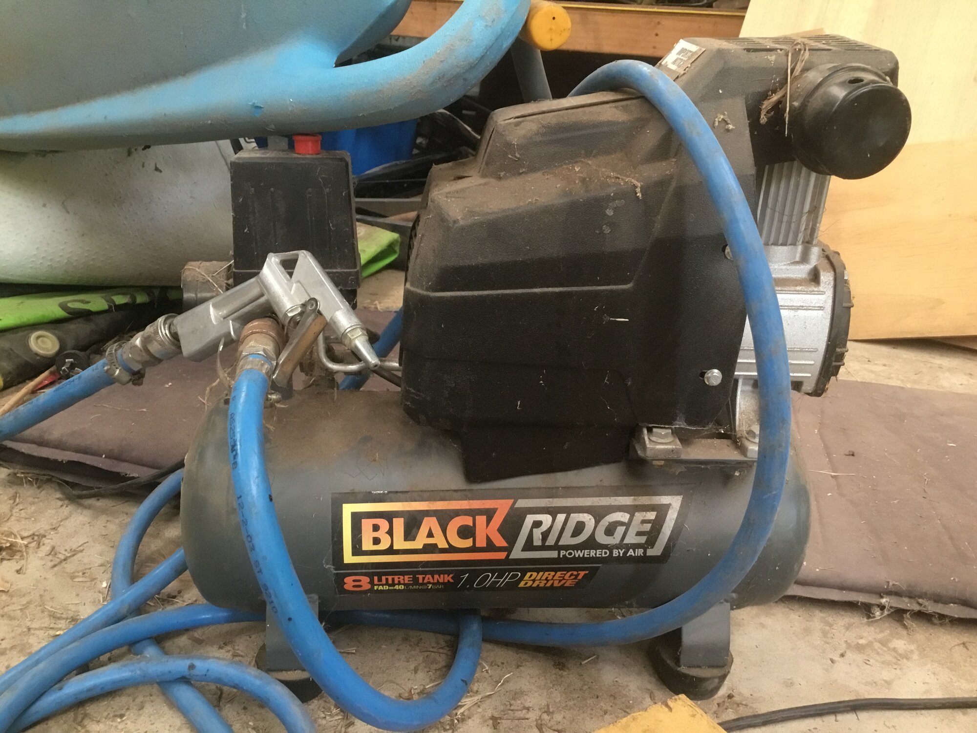

I've got a small compressor that is more mobile / compact than my old traditional high volume monster, It's labelled as 1 hp / 8 litres and about half the size of the average compressor. It manages tubless bike tyres but struggles to seat tubeless 4x4 tyres ( so I drag the beast out for them ) . . I literally can't get to the big monster at the moment because it's burried in shed stuff - which shows how ling since I last used it. The little unit is good enough for blowing woodwork dust around....cleaning out carbies etc. Not really enough volume to paint with, which is a really good excuse to get someone else to do that.....

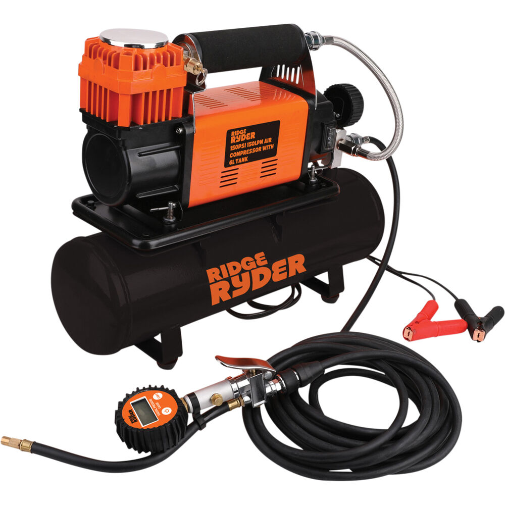

Btw, super scabby have my compressor on special at the moment with the tool kit included. At $159 it's still a bit more than their usual sale price ( around $100 without the tools when on sale), but the tools cost about $40 normally ( admittedly those are low quality attatchments)
But now you've made me look at the rest of their range and I want to buy this - my shed runs on solar powered 12 v and mid winter the battery / inverter struggles to start up my 240 v unit. And one can never have too many pumps...I particularly like the removable tank, I might see if the tank will fit my other air pumps
