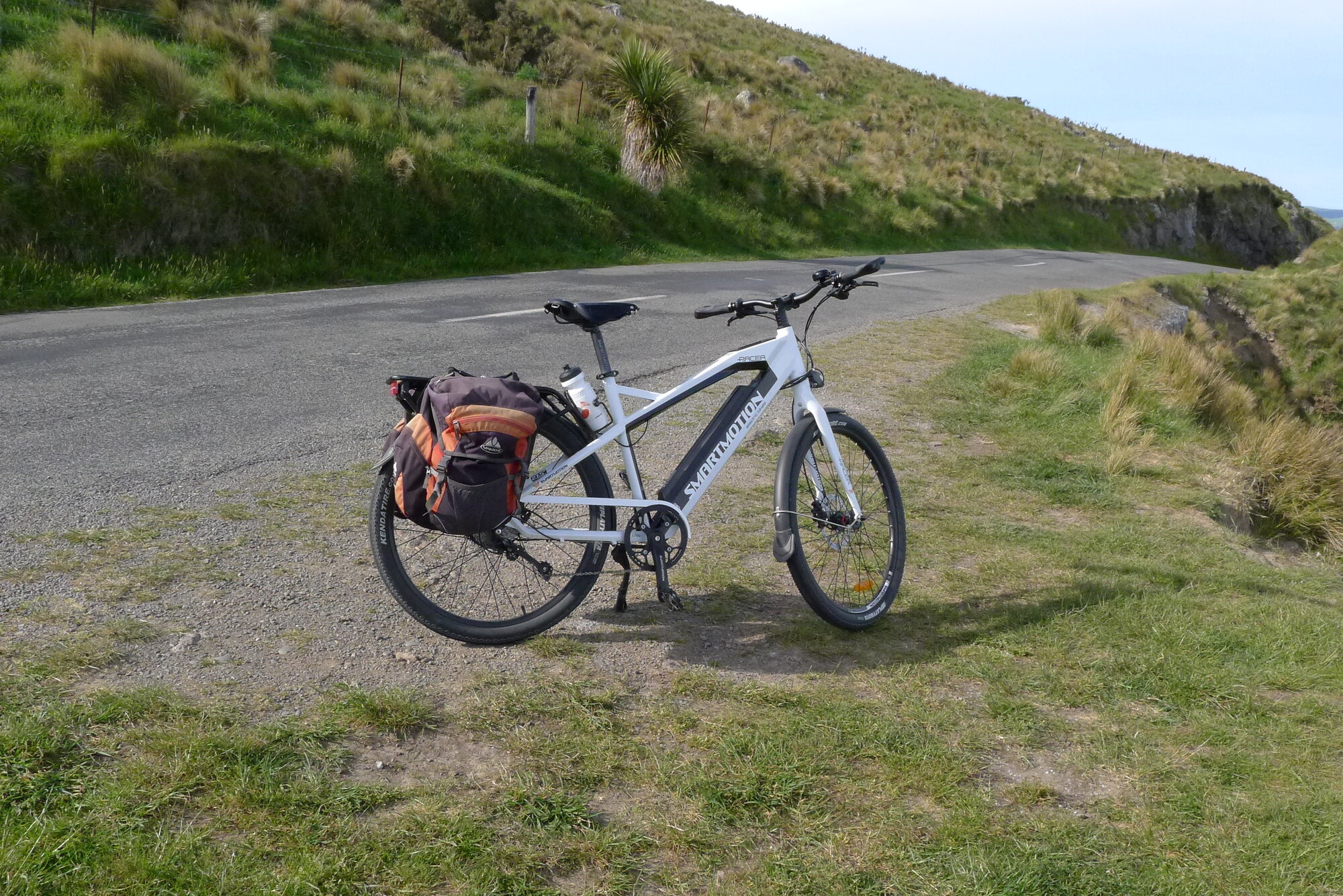

As Merle said, 'try before you buy,... is the best advice. Used bikes; I bought my own bike used about 2 and a half years ago, there were some known issues with the torque sensors on this model, but I fixed that..pulled it apart, found the issue and fixed it. The rear hub motor is more than adequate for the type of riding I do including hills, but this is a rigid bike and I wouldn't do any actual trail riding on it. I agree that mid drive motors are likely a better option for hills...anyway the point being that used bikes can be a good choice. I paid $1800.00nzd for this bike, they were retailing new for around $3600.00nzd, and the bike had 1200klm on the odometer, so for about half the retail price and a near enough to new bike in excellent condition.

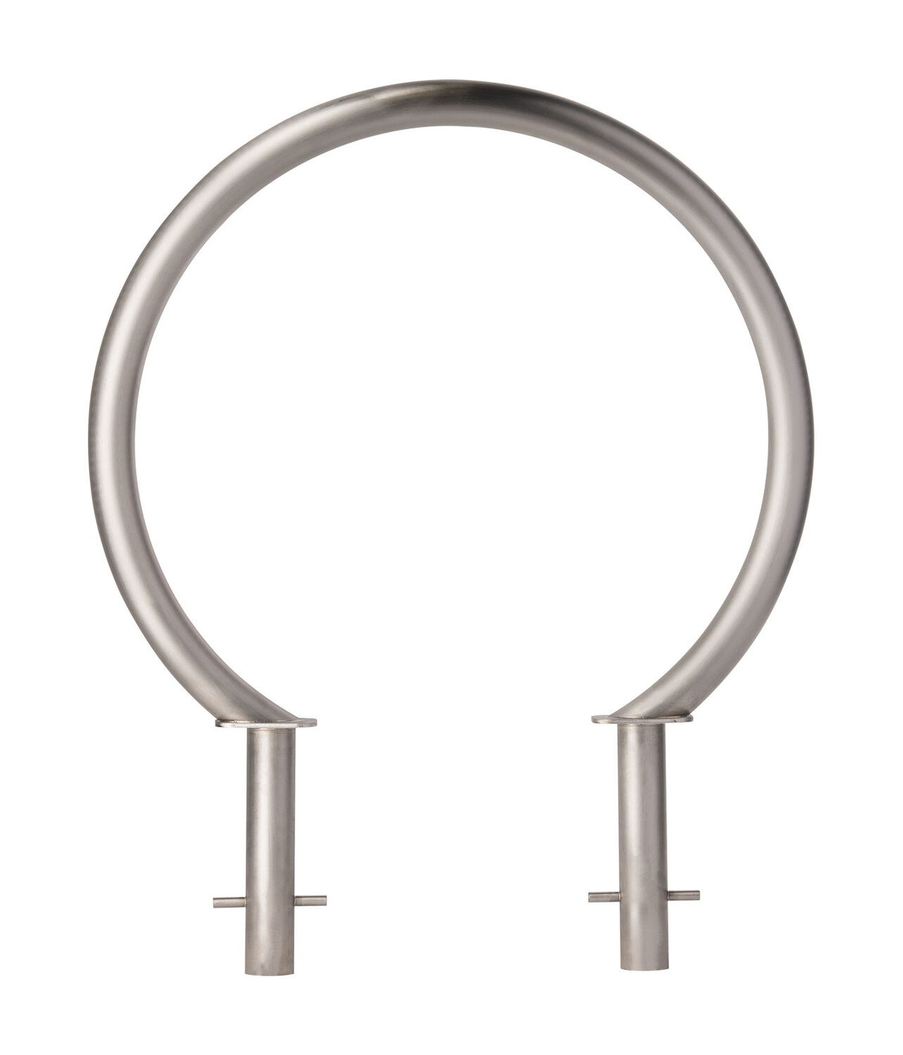

Thanks, indianajo. Is this the kind of ring you are describing? https://reliance-foundry.com/bike-parking/all-bike-parking/r-8224-stainless-steel/ ? Or here's another type of "ring" - https://thebestbikelock.com/ground-anchor/ (ground anchors). I need a new back patio so maybe that is something I could consider down the road. I will also research geared hub motors. I don't really want the "road" bike flexed position either.
Wow - that article about ground anchors is great. I have plenty of concrete in front of my house to put a couple of those in, and in one area it'd be partly covered by a front overhang. I would put the bike inside when I'm gone and not using it. I'd have easy access to the bike, which would enable me to use it more frequently and with greater ease. This may be the way to go, at least for now.
Actually I was thinking one of these: https://www.mcmaster.com/3049T51
1 1/4" threaded stud, 7/8" steel ring, 2 3/16" eye. Alloy steel. You could get the shank welded to the nut then bury the nut in concrete. $89 + freight + tax 1" steel ring 2 1/4" eye is $132 .
Actually I bought a stainless eye from mcmaster last year, but the hole wasn't big enough for pewag 3/8" chain. This one has a 7/8" hole and is made of 316 stainless, a ***** to cut with a torch. https://www.mcmaster.com/6097K38 $85
If you bury 2 rings in concrete and run the chain through both, then it takes even longer to cut through with a grinder or torch.
