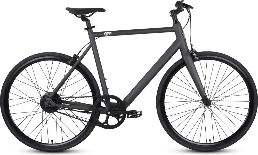

I bought the Roadster v2 from Ride1up about 1 year ago.
I wanted a very simple to maintain and lightweight e-bike that wouldn't attract attention when chained up.
Roadster2 is that bike.

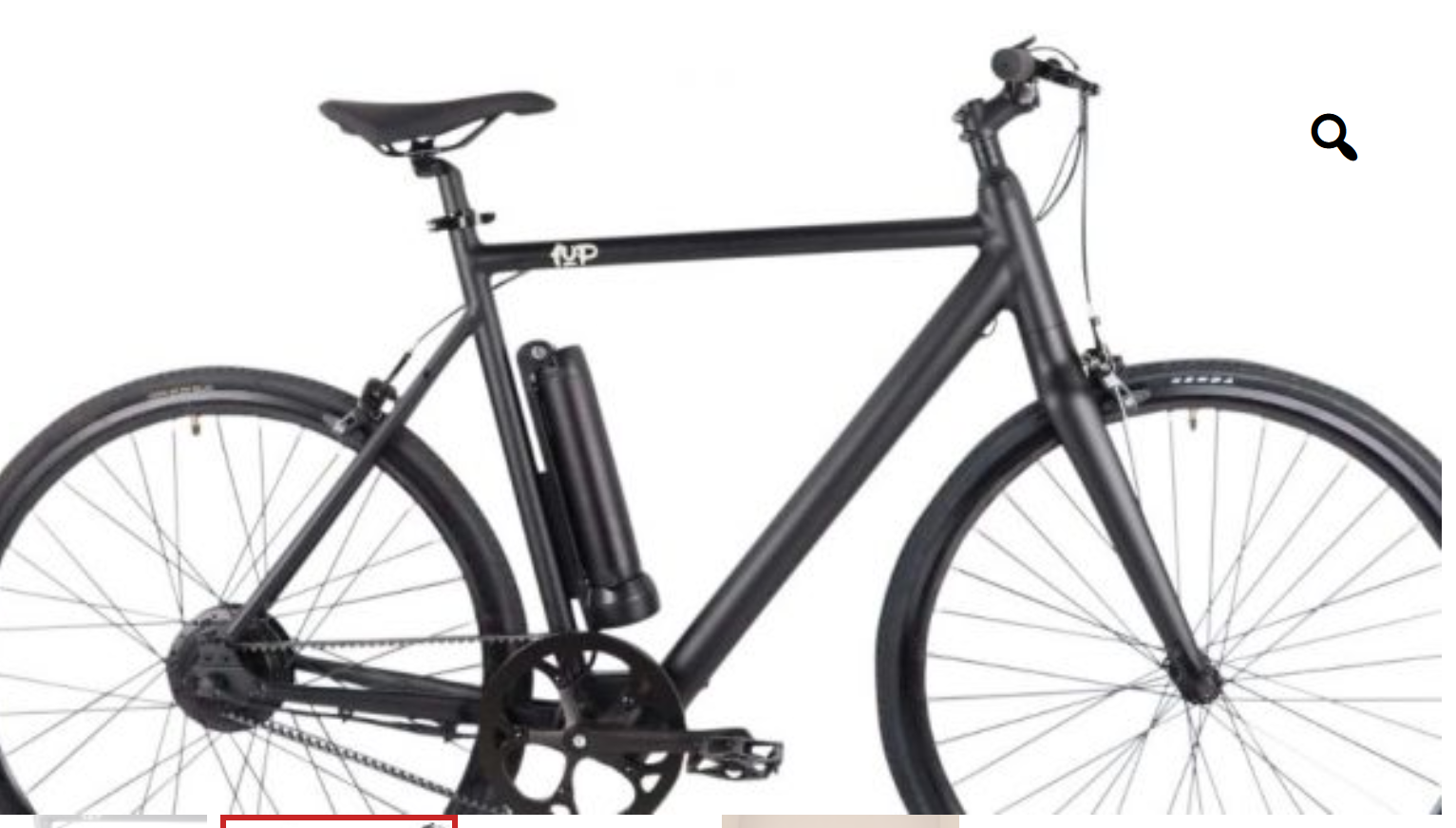

I have found the internal battery of the Roadster will not be sufficient however for long trips, so I ordered the external battery which should according to Ride1up be shipped in July.
Still pretty stealthy even with the external battery, which I can remove and put in my backpack when locking up the bike.
Will enclose photos of what the v2 looks like with or without the external battery.
